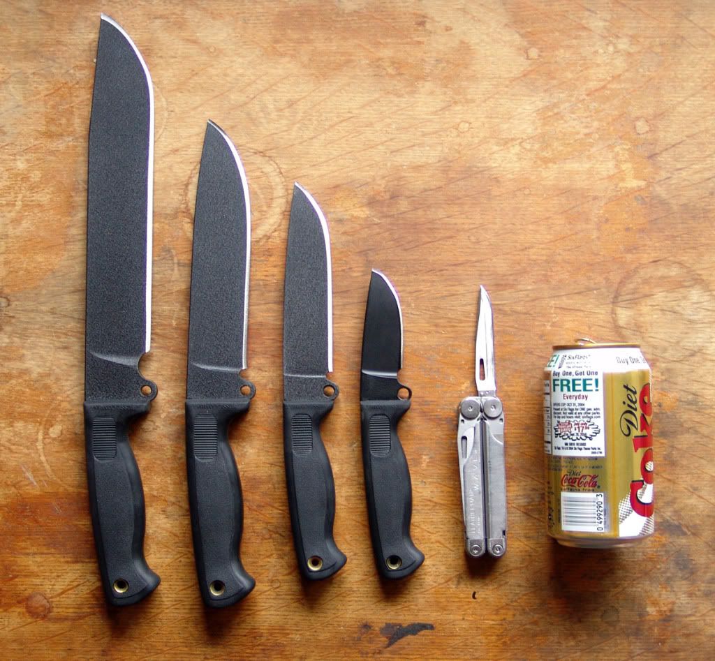

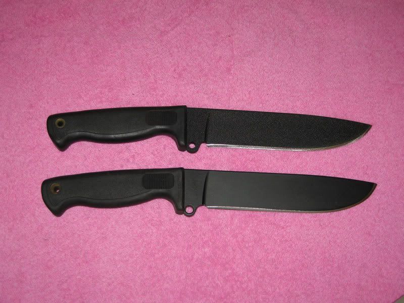

Posted by JimmyJones:
And from my past collection:
Within the (pre-BOSS/NM era) basic lines, smooth (older) and crinkle (newer), none of the choils were exceptionally usable. The smooth coat series had elf choils that were larger than the crinkle series. The Basic 9 was the only one that got it's elf choil extended to be a full finger choil, but many people found it to be too small to use comfortable compared to the more recent XL choils.

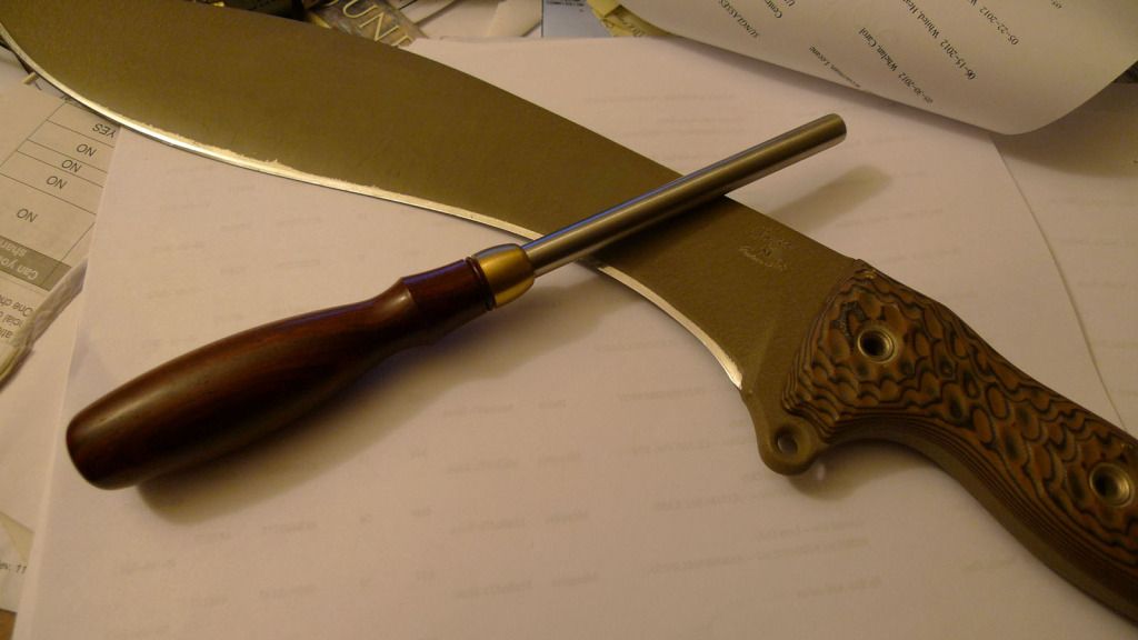

What you see here is a collection of bevel types. The type busse has is labeled 'asymmetrical convex', however, the actual format is closer in proportion to what he shows as 'chisel with back bevel'.
The idea is to get a convex edge that has the accuteness of overall geometry to that of a chisel (20 degrees on one side) but maintain most of the strength of a V edge, (40 degree's total if you include both bevels, but one of them is very short). When sharpening you are supposed to only have to steel or ceramic rod the short beveled side, and then strop the convex side to remove the burr. This allowed for a much shorter sharpening time with less effort, and could easily be accomplished in the feild as long as you had a loaded strop strap and either a steel like this:
Of an equivalent ceramic rod.

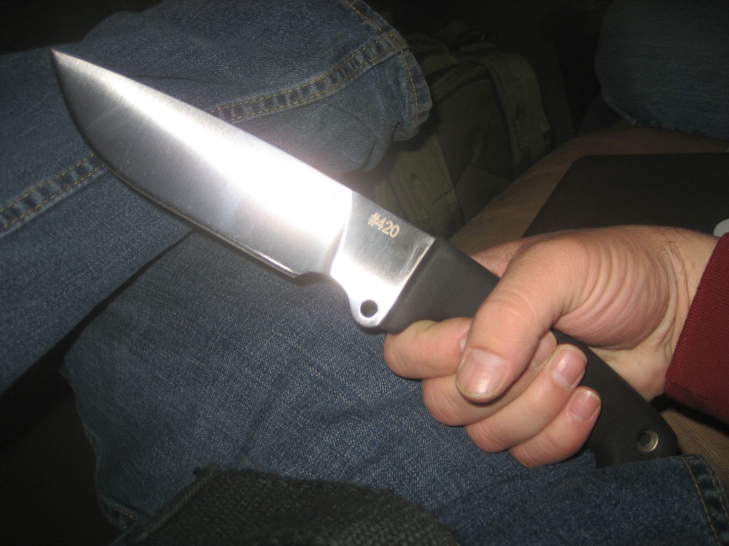

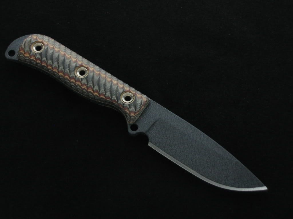

The basic 6 also differs from the Euro 6. If your looking for INFI and the un-thumb molded newer style swamp rat handles, the basic 6 is it:
From dericdesmond:
If your looking for M-INFI, the older Euro 6 is it. The only difference being it's M-INFI, Clip point instead of drop point, and has the older style molded handles.
This is a stock thumbnail of the original euro line, with the euro basic 6 at the top:
