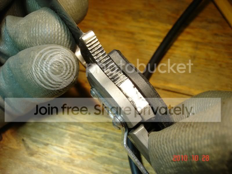

I can overextend mine when I disengage the lock. There is nothing to stop it, other than the pocket clip.
There should be a small lip of the steel insert that overhangs the Ti lockbar that hits the inside of the Ti scale to prevent over-extension if it's done right.
if you find the pictures of the guy who disassembled his on the spyderco forums, you'd see how it works. And I believe you'll find that you actually can't overextend it, even though the lockbar can still travel slightly outside of the frame line.
Mine may not be done right. What stops the lock tang is the pocket clip.
Is it actually contacting the clip right there? Mine looks like it is too, from the angle your pic is taken from, but if you let some daylight shine through and look at it head on, you can see it stops just short of hitting the clip. I'm guessing there's enough of a variance where it could hit the clip, but who knows.

The lock bar on my example hits the clip as well. However, with the clip off the mechanism worked as intended. Maybe it's put there for those that go clipless?
I certainly dig the knife and am completely satisfied, but maybe i also have one where the lockbar contacts the pocket clip before the lip on the steel insert can do its job. I was able to pinch a piece of paper between the lock bar and the clip when moving the lockbar. I can see how the steel insert will prevent the lockbar from traveling too far, but i think the bar does make contact with the clip. Well at least it does on mine.
Interesting, mine does the same thing. Hits the clip first, but just barely. Probably the system they used on the all Ti Millie.

Mine is like Twindog's--the clip stops the lockbar. To satisfy my curiosity, I removed the clip, and tab on the steel insert does indeed act to stop the lockbar from traveling too far. So the feature works, but it only works with the clip removed, at least on mine. So unless I go clipless or tap the scale for tip up carry, the feature is redundent.
