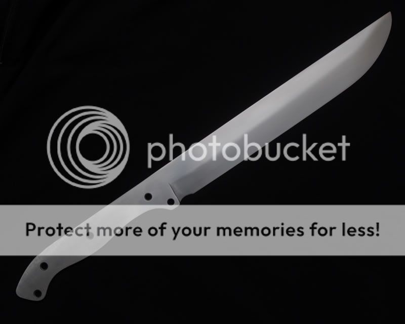

As stated on the other thread I have decided to attempt an entry into this Challenge. I want to be up front, I am taking is on as a learning experience and a way to have my blades tested in the real world by non-biased testers... I am a Complete NOOB, I have never made a Machete or Blade longer than 8" before. Sooo mcjhrobinson you should definitely join in.
Here is my WIP report...
Pencil hits the paper:
Cut out the Blank:
Finished the Grinding and Started on the Hand Finishing:
Now comes the scary part for me the HT!!! After seeking advice from a few Respected makers here my plans are to HT to 1500+ °F and then Quench in Canola Oil (that is the only Quenchant I have at this time). Then Temper 2X @ 400 °F for 2 Hrs. in my Kitchen Oven (Yes it barely Fits)... Any advice is greatly appreciated at this point.
Ryan that is looking fantastic. You should be mighty proud!
