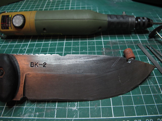

Here are the tools I used. A Proxxon/Dremel, a big and a small grind stone bit (the big one did most of the work for the firesteel notch, the small one did the lifter notch), a cutoff wheel which I used to start the notches for the jimping and to set the depth of the lifter notch, and a few little jeweler's files, flat, round and half-round/flat. The picture also shows the finished lifter notch. I scratched the blade and the spine up a bit, but I plan to sand the whole knife up to 1000 grit or so anyways.
The knife as it looks now. I'll try to get some nice shots in the next few days. The scratches on the primary grind are what I mentioned earlier :)

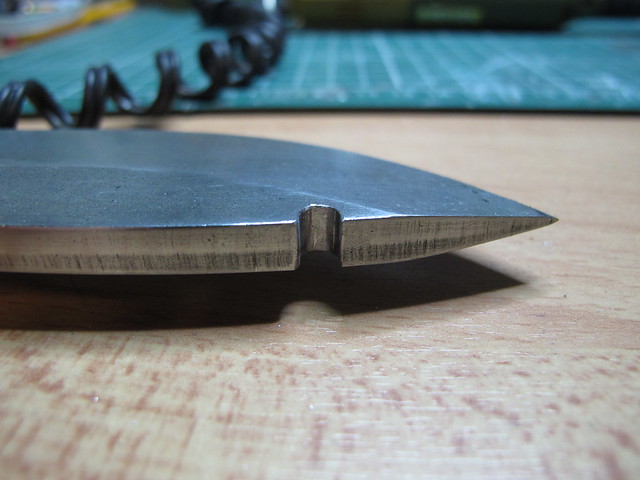

Close-up of the notch. It is just wide and deep enough for the intended purpose, which is lifting the big pot of my mess kit from the fire. The handle gets just too damn hot. I've been using my Victorinox SwissTool for that purpose, but since I forgot to put it into my checked luggage at Brussels airport, I realized that I don't really need it in the woods. Note that I paid attention to make it as round and remove as little material as possible, because I didn't want to compromise the strength of the blade, as I intend to baton it through a lot of wood. The round shape of the notch spreads the stress from batoning, so the tip is less likely to break off. The notch is now around .150" deep and .160" wide.

i like the notch idea for a pot lifter, but i'm also the type that just reaches over for a stick, and makes a tool for the job while waiting for the boil/simmer :)

Thank you. The problem was that my hand cramped up while grinding the lifter notch and slammed the grindstone bit into the edge at 15.000/min. Just sharpened the dents out, good as new, shaves again.
