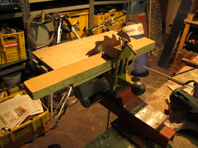

I tried to saw the slabs out of that piece of wood I got, but it looks like I need to find someone with a bandsaw who will cut them for me. Doesn't work with a handheld circular saw.
Edit:
Yes, I put a handheld circular saw into a vise and screwed some pieces of wood onto it. Guess what, didn't work.
I'll go to a local carpenter's shop tomorrow and see if he can cut the slabs for me.

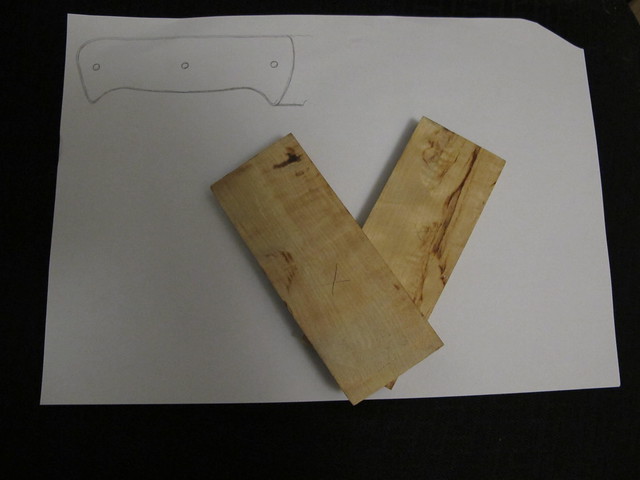

I went to a few carpenters today until I finally found one who would cut 10mm thick slabs out of the block of birchwood I had, this was the result.
3 slabs of full thickness and one a little thinner, about 7mm. Awesome and beautiful material for knife handles. I wanted something that's somewhat exotic, but not something that has traveled around half the world after being harvested in a tropical jungle, so I chose karelian curly birch. It comes from the northern parts of finland, around the russian border, and very few trees have this beautiful curly shiny pattern. I didn't get super lucky with the grain on this one, and the picture doesn't do it justice. There are also some burn marks from the sawblade on it.

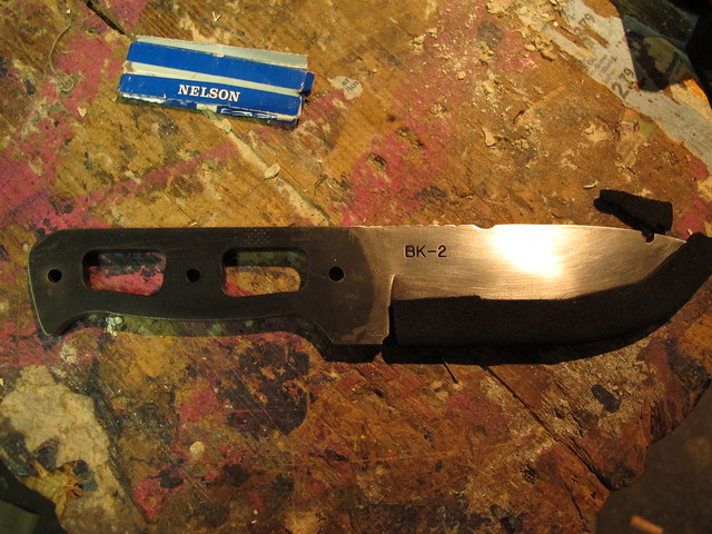

I then went to the shop and proceeded to chop the butt end off. I wanted to use a handheld angle grinder, but it turned out not to be there, so I had to use a dremel with a little SiC cutoff wheel. Yes, it took a while. I marked out where I wanted the new handle end to be by scratching a line into the metal with a scribe, and cut it off maybe 1/8" from that line, then did the final grinding and clean up on a bench grinder.
I wanted to put a tube through this hole to attach a lanyard, but a comfortable lanyard tube for 550 cord should be 6mm outer dia, IMO at least. I took a little hot soldering burner to the surrounding area and brought it to a faint red glow to be able to drill it to 6mm. I haven't drilled it yet, dunno if it worked as planned, we'll see tomorrow. Yes, I know I effed up the temper, but that kinda was the point, right? I'm not gonna pound on the butt end anymore, not with the nice expensive work-intensive wood scales :D
The slabs cut to length and, drawn out on the paper, the shape I would like them to have, ideally.
Quick question, how should I go about attaching and drilling the wood? I think I'll shape the end which will be closest to the blade first, then glue one of the scales to the handle, drill the holes on the big drill press at the shop, glue the other scale on, drill holes through from the other side, glue lanyard tube and pins in, do the rough shaping with a saw and then start working with files and sandpaper. Right? Now that I think about it, it would probably be good to saw the first slab to shape before attaching the other one. What do you guys think?

First, drilled out the hole to 6mm (about 1/4"), the annealing of the surrounding area worked like a charm and the TiN coated HSS drillbit went through like butter. Lanyard tube fits.
