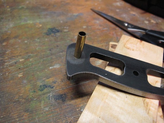

First, drilled out the hole to 6mm (about 1/4"), the annealing of the surrounding area worked like a charm and the TiN coated HSS drillbit went through like butter. Lanyard tube fits.

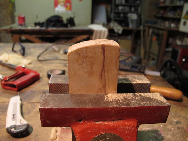

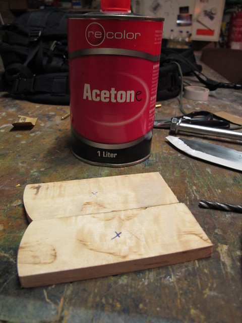

Shaping the scales, this is the area that can't be worked on anymore without scratching the ricasso after they are glued to the tang. A rasp and a file did most of the work, some 100grit sandpaper cleaned up the edges.
Give everything a good wipedown with acetone before applying the epoxy, it will take any oil/fat/dust residue off the tang and the wood and make their bond stronger. Very romantic.

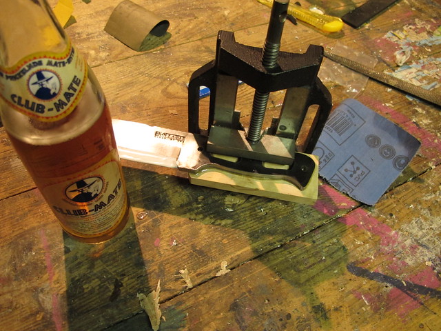

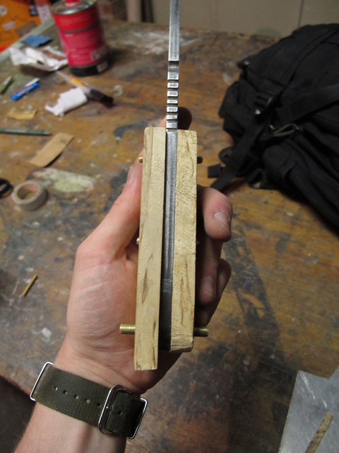

Then I applied epoxy to one side of the tang and put it all into a little vise, because I had no clamps readily available. I should have drilled the holes and put the pins in before putting gue on it, it would have made this step a whole lot easier. Get a drink while you wait for the epoxy to dry, my choice is Club-Mate.
Then shaping of the already attached slab, I used a hacksaw to cut big chunks off and then a rasp, file and sandpaper to finish up. I also drilled the holes, 5mm for the pins and 6mm for the lanyard tube.
Then I drilled the holes into the second slab and checked the fit. It's tight, but that's a good thing. My pins are M5 threaded rod (M5 meaning a metric thread with an outer dia of 5mm) and the lanyard tube is 6x0.5mm (6mm outer dia, .5mm wall thickness) tube. Brass of course, for ease of working with and looks.
Again, applying epoxy, clamping (this time in another vise with an extra clamp) and having a drink while the epoxy cures.

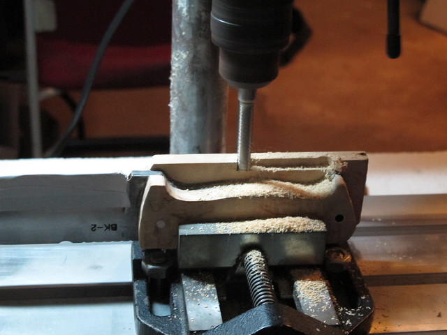

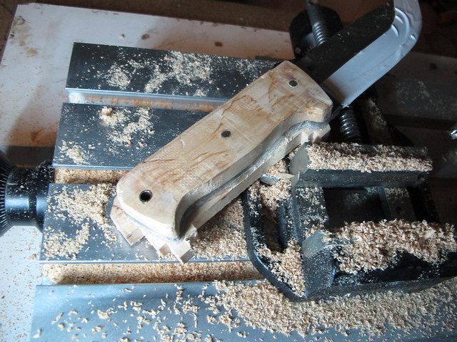

Just for fun and educational purposes, we chucked it onto our milling machine which I learned to properly operate in the process. This is actually my only action pic of this, a good friend who wants to stay unpictured and unnamed is operating the machine in this picture.
Result of the milling process. Cleaned it up like before.

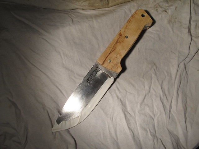

Some terrible pictures of the knife as of now:
You can already feel that it's gonna be a great handle, I love the contours so far. Of course the real shaping work is still ahead of me.

As far as process goes, I do the following:
1) polish the blade to it's planned finish level. This is easier to do before the handles are on.
2) tape up the blade with painter's tape
3) clamp slabs to knife, knife side up, and drill through the tang holes - repeat for matching slab
4) temp-pin the slabs together (easy if you're using bolts!) and shape the FRONT of the handles to their final dimensions, and a nice fine grit finish
5) maybe rough-cut the perimeter of the slabs a bit for later efficiency
6) glue that sucker up
(KEEP THE TAPE ON THE BLADE UNTIL THE TOOLS ARE PUT AWAY)
7) rough-shape the scales on the circular grinder or whatever power tool you can get close enough to do some high-volume removal I may sand all the way down to the steel on the perimeter, which will mar the the previous finish - not a big deal, and reduce thickness at the same time.
8) hand-finish with files for shaping
9) sand away file and grinding marks, mating the wood and the steel. If you want to avoid touching the steel (i.e. it's already painted :-/) this isn't the way to go
10) sand some more
11) tru-oil, wax, or whatever
12) remove tape from blade
13) post pix to BF! (or go on and complete true edge, sheath, etc. if making a complete knife)
