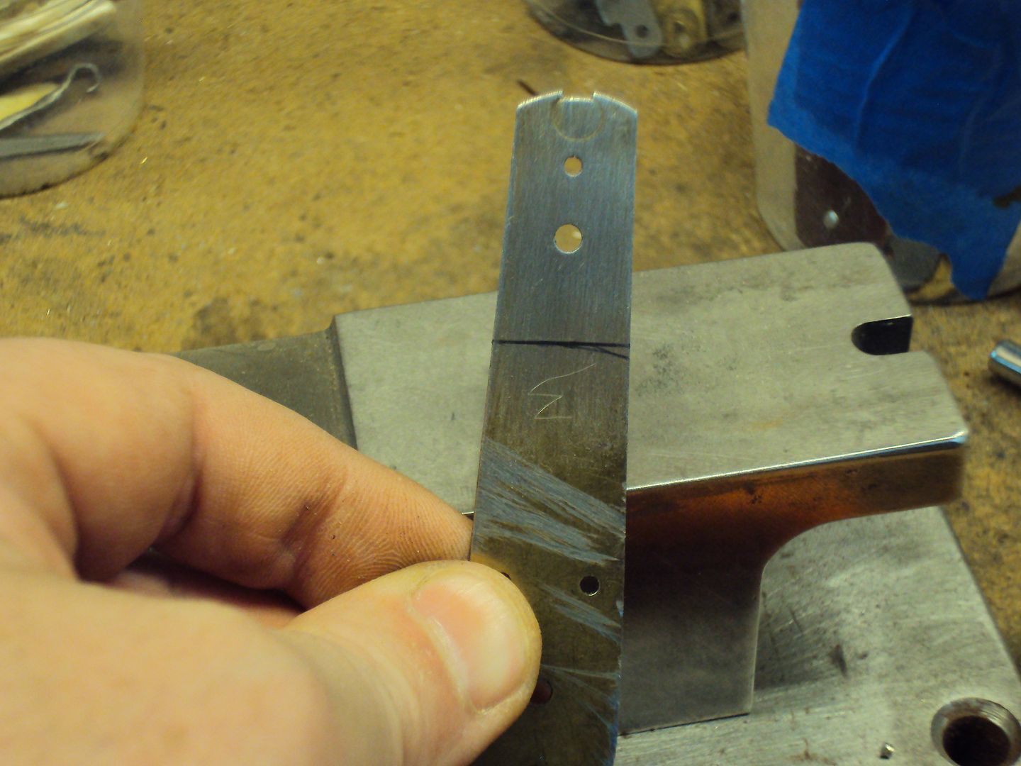

Also, mark you liners on the outside (the part that the cover material will be glued to.) On some knives, you can't tell what is the inside and what is the outside of the liners.
That is an "M" for mark side, which is the side that you would most likely see a shield or nail nick on. Use "P" for the pile side.
Now that everything is identified, you want to flatten your liners. Those tabs won't be used any more, so take a hammer and flatten them right out.

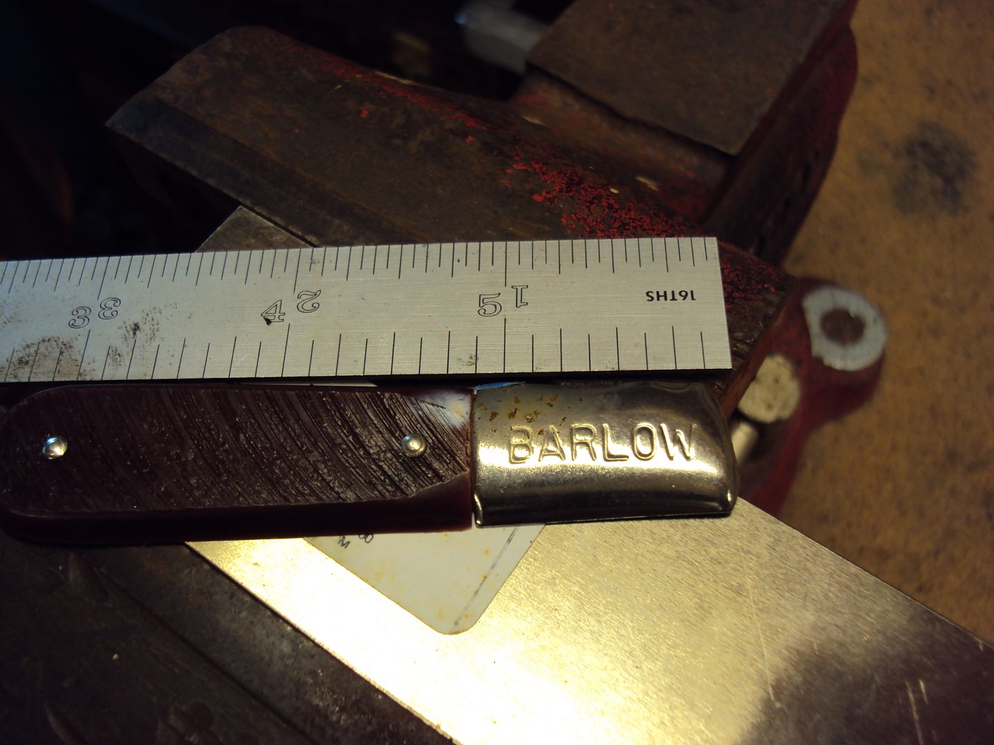

Now measure 1 1/4" from the edge and mark a line. Try to line it up so it will look correct. You can use the original shell to check against.

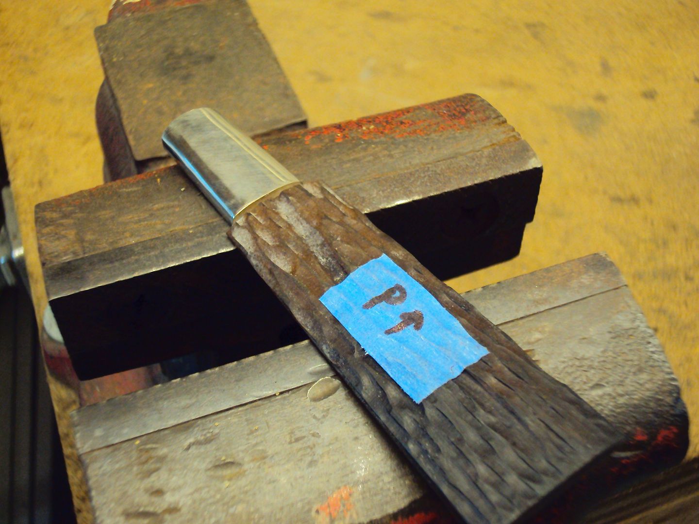

For this project, I have chosen some antique green tapered workgroove bone.
The prep on whatever material you choose is the most important part of the finished look. The number one thing I see is that people just slap the material on and then sand away after. Usually that ends up in very thick handles or no jigging/color left from sanding. Take the time to remove excess from the back of the material, where it will attach to the liner. You want it to be very close to what the final thickness will be when finished. Also take the time to get a precise fit between the material and the bolster.
