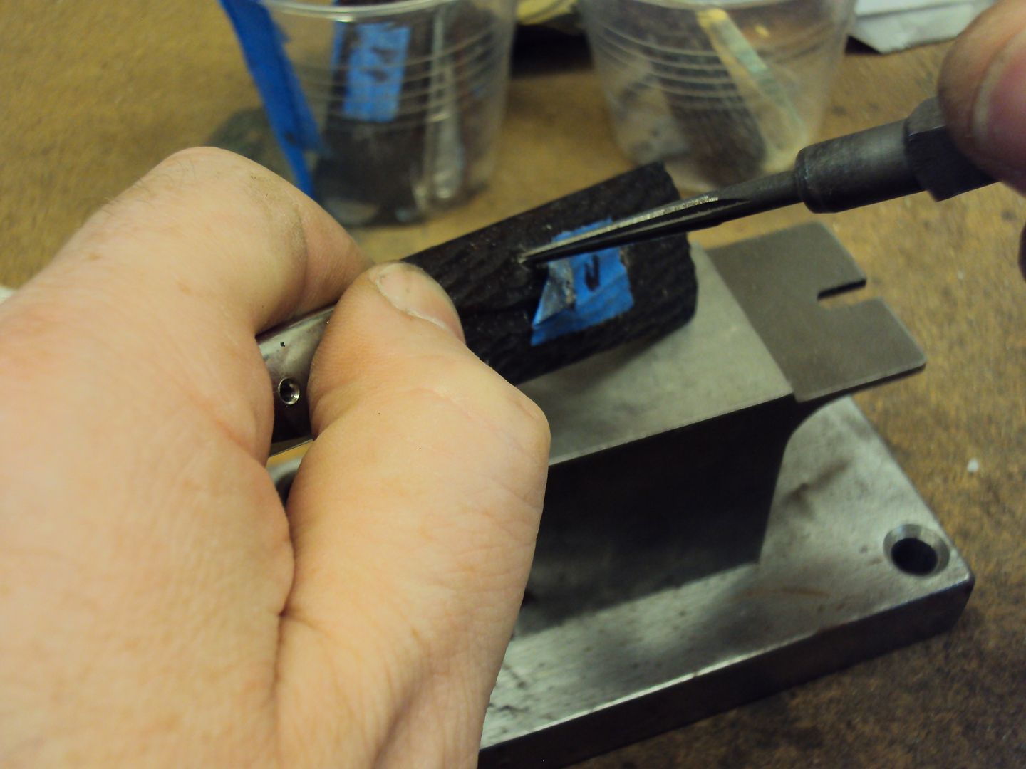

Once everything is epoxied and dried, you should pin the cover up by the bolster. Mark the liner about 1/4" in from the bolster, then mark the center line to make an x.
Then you should drill your hole. Always use a backer behind what you are drilling through. That can help to reduce blowout of the material whent he drill bit come through. I use a piece of leather most of the time. Whatever pin material you choose, drill your hole slightly larger than the pin. It should have a little wiggle room when inserted. The reason for this is when the pin is peened, it will spread. You don't want to crack the material. Once you have the hole drilled properly, use a larger drill bit to create a countersink inside the liner.
Next, take your pin material and put it in a vise. Use your hammer to slightly spread the pin to make a head like this.
Now, insert the pin from the liner side till it bottoms out . Then take some cutters and trim the pin down. You don't want a lot sticking up, maybe about as much length as the diameter of the pin.
Then carefully peen the pin that you just cut. Try to be precise with your hammer hits, and you don't have to wail on it. Take your time, enjoy the process. You want to mushroom the head. Once the pin is tight, you are good.
Take your file and file down the pin on the liner side flush with the liner. Don't worry about scratches on the liner, you will sand those out.

Question Glenn. When you drill through the liner and handle covers, you countersink the hole in the liner.
Do you need to do the same in the hole in the covers for the peened pin to sit in? Or would this crack the covers. I assume there is a reason why you don't?

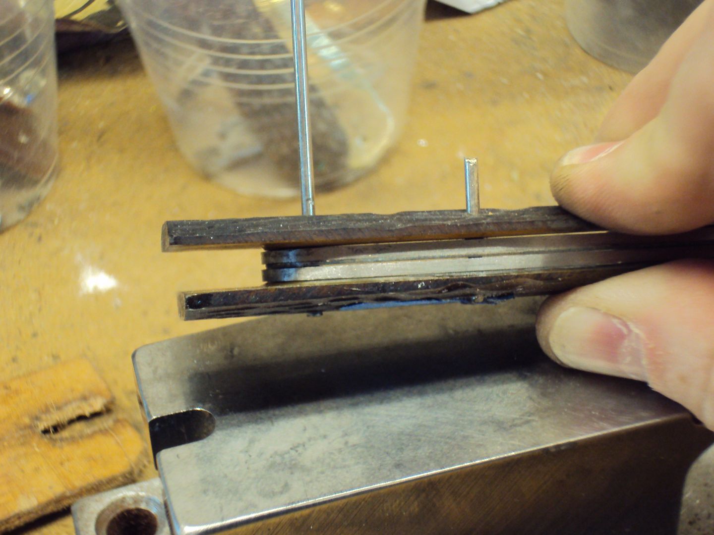

Now you can start assembly. Start by peening a head onto one end of your pin material. I usually start at the end of the knife. I also use small pin pieces to keep the whole thing in line.
Trim you pin down. Pin height should be no more than the diameter of the pin.

Now you can peen things together. Remember, light solid taps, no heavy-handed hammering. If it's not super tight, don't sweat it, you can tighten it a little later.
Once the first one is done, you can do the middle pin.
Once that is complete, you can set the blades. You have to compress the springs to allow the pin to pass through the bolsters and the blade tangs. There is no easy way to do this, and there all tools for this. For our purposes, you can use vise grips or a vise.
Before you peen your bolster pin, you want to insert a slackener into the joint. A slackener is nothing more than a shim that will allow a slight bit of space once everything is peened.
Trim the pin like you did before, and start to peen the pin. I like to use a pony clamp to hold everything together as tight as I can. Start peening the bare end first, forming a head, then alternate to the other side for bit. Keep alternating back and forth until the joint is tight. Remove the slackener, and check the blade play. If there is some, lightly peen until things tighten up.

I have seen people that have built jigs for forming pin heads. I just chuck my stock into a vise and form a pin head with my hammer.
Yes, the general idea is for the peening process to flare both sides as you peen the top side. Then you alternate to the other side to even things out.

So Glenn, just want to be sure. There is no reason to countersink the holes in the handle material then? The same way as you did with the liners?
I was wondering if perhaps that might help with the issue of cracking the cover material? Just very curious.
