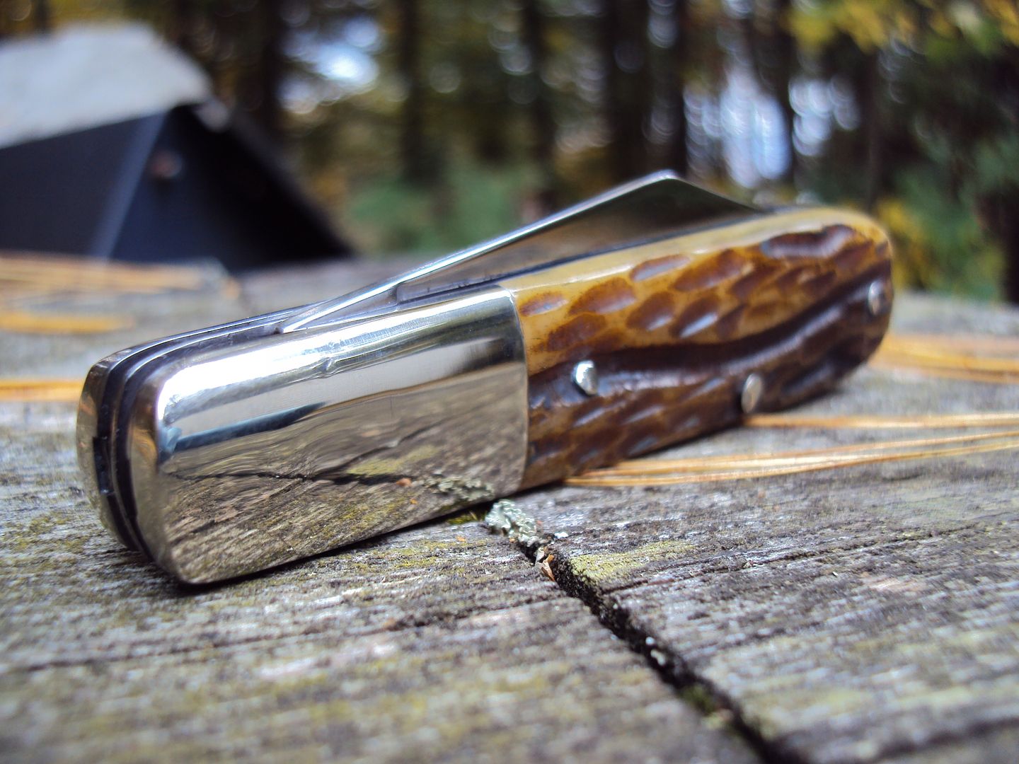

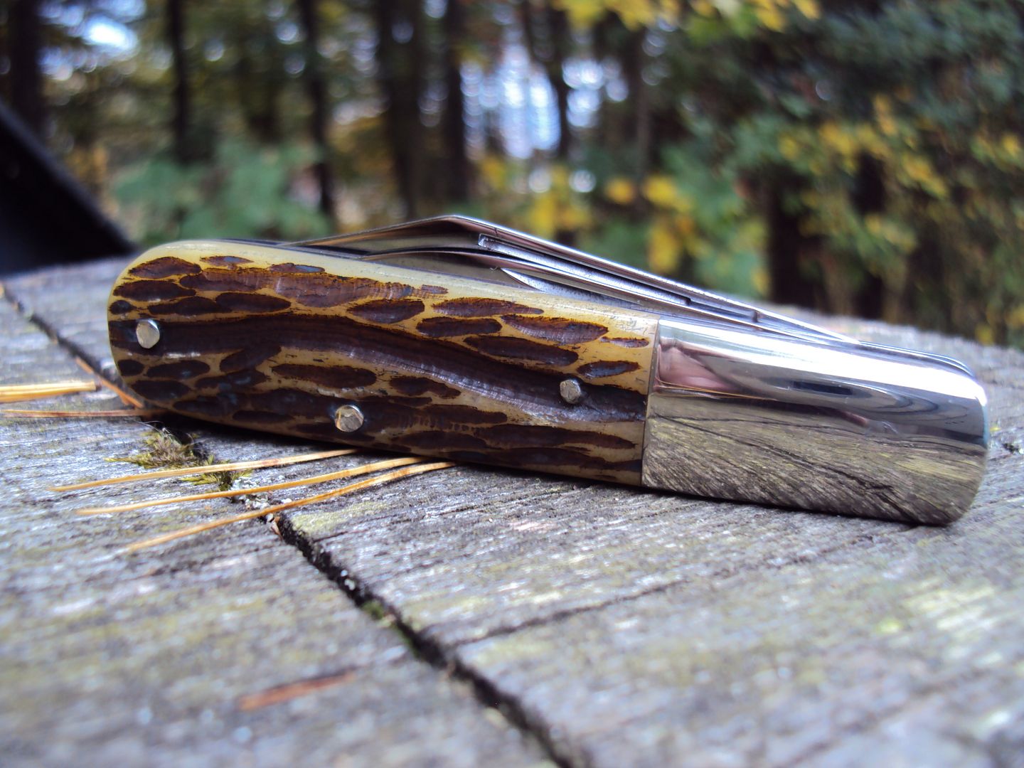

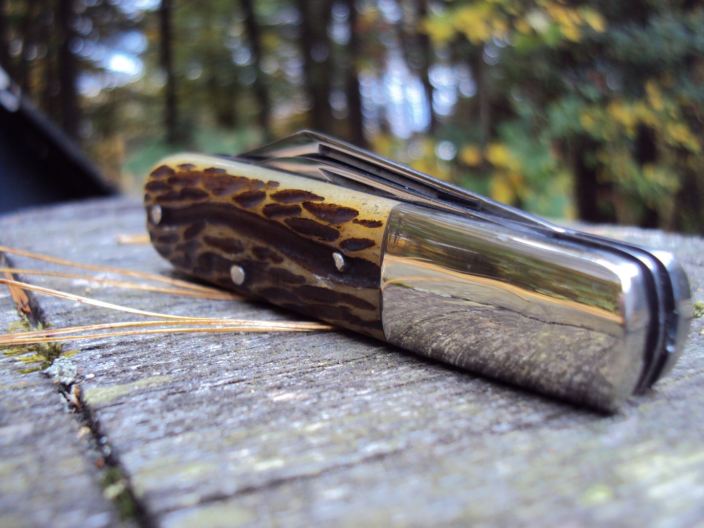

So Glenn, just want to be sure. There is no reason to countersink the holes in the handle material then? The same way as you did with the liners?
I was wondering if perhaps that might help with the issue of cracking the cover material? Just very curious.
Thanks again for taking the time to teach, learning a lot!
dave
It's more of a taper than a countersink. There may be certain cover material type more prone to chip out, that you may want to do a countersink on. By doing a countersink, your pin head spreads out more. I find big spread-out pins on cover materials to be a big turn off.
