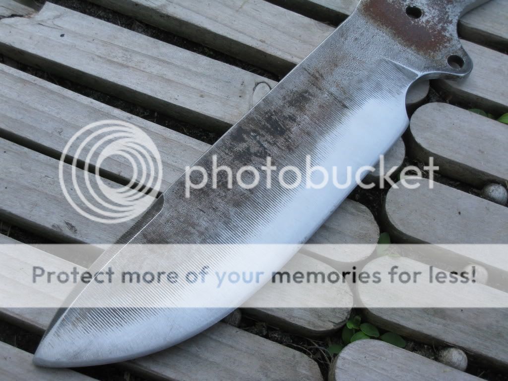

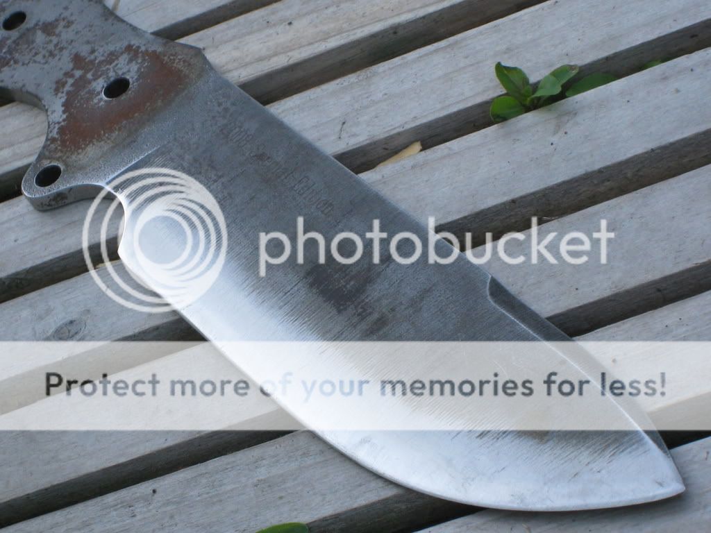

Just thought I would post pics of one of my favorite Busse medium sized choppers... I have no problem with rust in my users but was curious to see what exactly the situation was under the hood:).. Well, here are the pictures. eeeek!
This baby will be getting a straightened spine like the SHSJ and green/black linen micarta.. The blade on the SarQwill remain untouched..

Did anyone ever figure out why the sar knives are rusting? I don't have any rust problems with any of my other nekkid Busses'.

Just wondering J, has that knife been exposed to very much moisture?

The SarQ was left outside for about 4 hours during the middle of the night due to drunken forgetfulness. Other than that It has been indoors when no in use. I do not have a belt sander quite yet so I am going to have a neighborhood knife maker do the mods. His name is Tim Horan.

I have a FBM, used to be mint urban grey, never used, carried and always stored in a dry place. I took it out to show a mate and noticed the coating bubbling in a few spots, I ended up stripping it and the blade was covered in rust under the coating. Its stripped cleaned and oiled these days, but I wasn't to happy at the time.
I have also found with my stripped Mud Razor it will rust very heavily within a few days, but only in certain spots along the blade??? This is also when left clean and dry, so I am not sure what is going on here?
that would be all of the competition finish blades. jerry explained that the decarb is very prone to rusting
I told you it had a nice patina :p
It looks like you found that thing at the bottom of a river. Can't wait to see it with the new handles, good luck :thumbup:

For those that are worried about the fate of their CF Busses a healthy dose of a thin lube like Tri Flow or Break free will penetrate into those areas pretty well and fend off rust for a long time. Just hose the knife and handle down and let it soak in overnight then wipe off the excess. Reapply every now and then after exposure to water or high humidity :)
