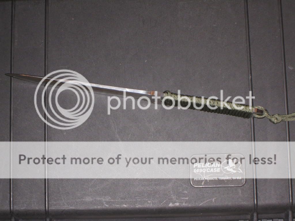

I was just messing around and tried para cord wrap for a handle.. This is freaking comfortable and now has to be one of the lightest choppers from Busse... I need to take it out to the woods tomorrow and see if the corded handle is comfortable for actual hard chopping and other random bush craft activity. If I like it I may say screw getting handles put on and leave it the way it is... Damn this is light blade now...
If you like light handles, consider having some of the tang drilled out and put Bamboo scales on it.
Bamboo is VERY light-weight and reasonably tough. But, you could still use many other materials including still using micarta. You just have to do some proper estimating about skeletonizing the tang vs. weight of handle material.
The combination would feel nicer in the hand than paracord (IMO) and could be balanced as you see fit. But, this is coming from someone who doesn't care for paracord handle wraps. Some people like them. (??????).

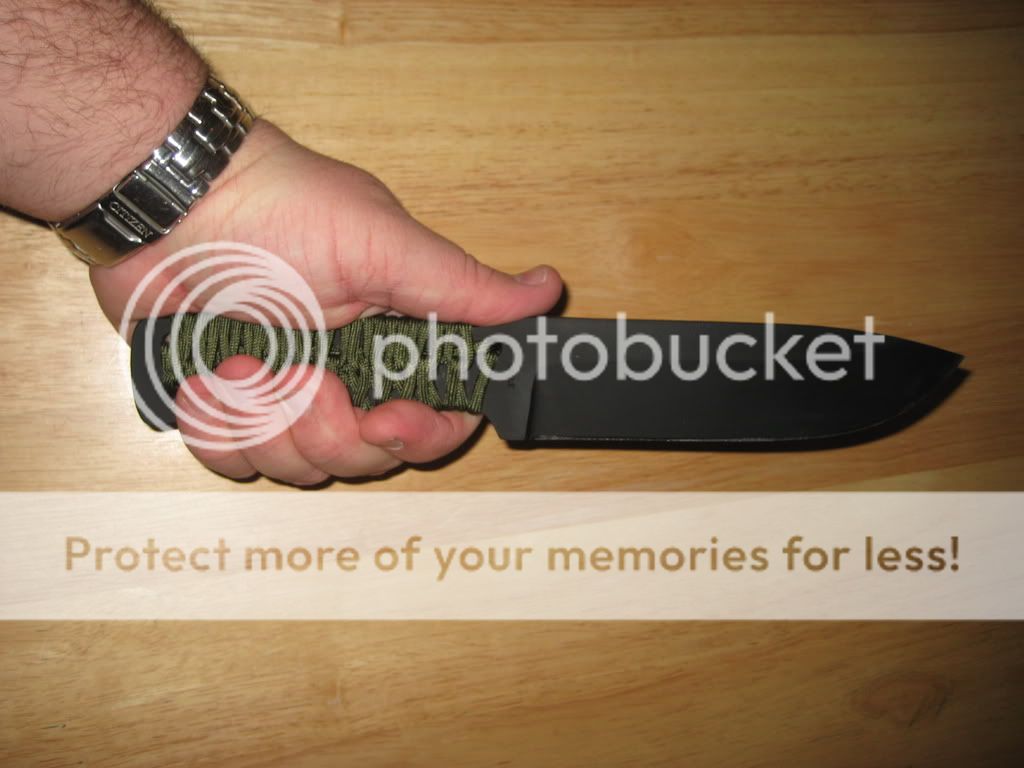

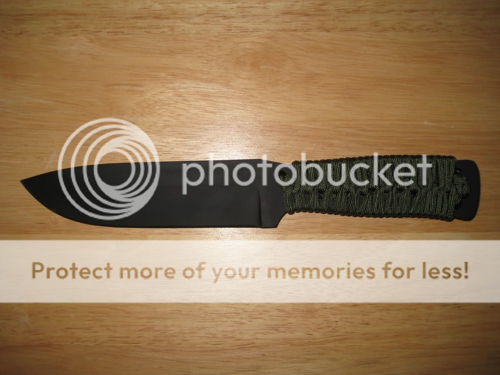

Ok............ Fine ;).... Just for you T..... It is sweet ...
My red headed Edited for inappropriate forum language, infraction issued. along side the RUCK. pic taken right after handles removed.
very cool brutha!
lets us know how it feels after a workout:)

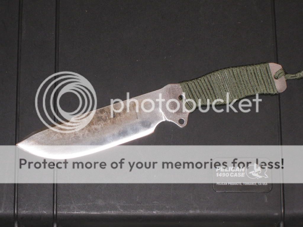

Holy Crap !!!
nice. i don't see it being very comfortable for chopping though. i put a japanese wrap on a batac and while i haven't tried it, but knowing how it feels, i wouldn't think it comfy for chopping. it does lighten the knife up nicely though, and feels great for light tasks.

Also, Uncle J, on a user with a wrapped handle, I like to run a few loops of cord before I wrap it, through the handle holes, so that it adds some width, and then braid the wrap. It gives more width and slightly more cushion. If you have a wrap style you like, you can also wet it with some thinned resin, and make it more durable.
