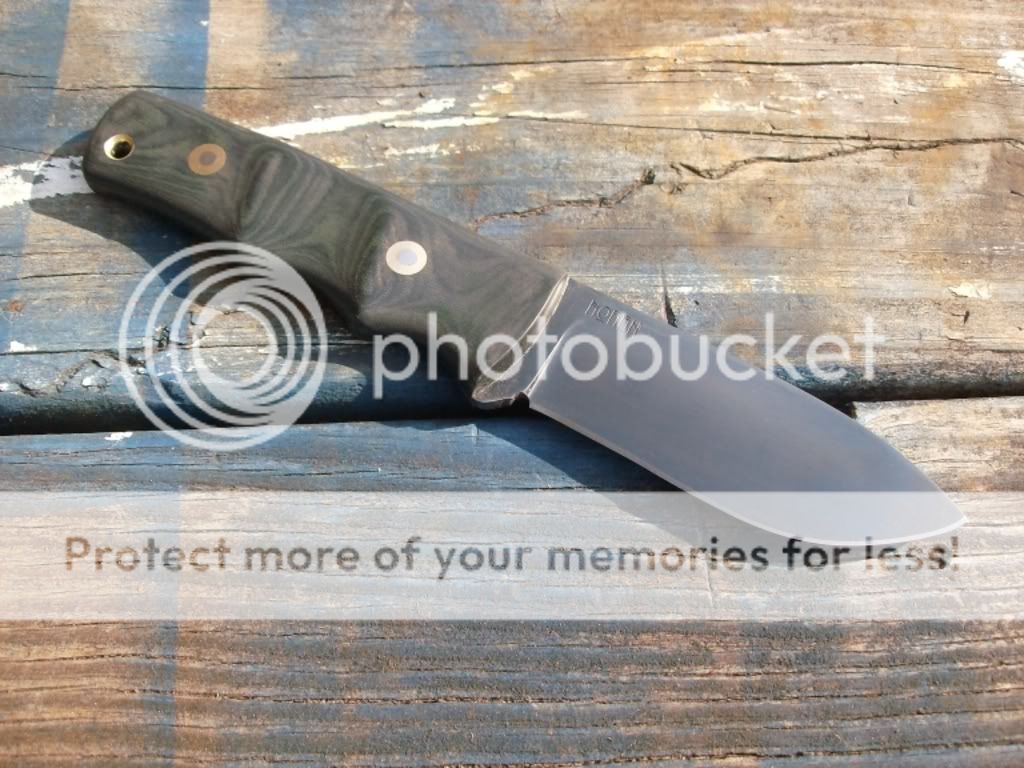

That is a bushcraft blade made by Tim Horan.. He is a knifemaker from my area.. The model is called companion. There are more pics on his webpage.
I am actually going to try and make it to his shop today after work. Great guy for sure..
Sweet knife! What is it?
