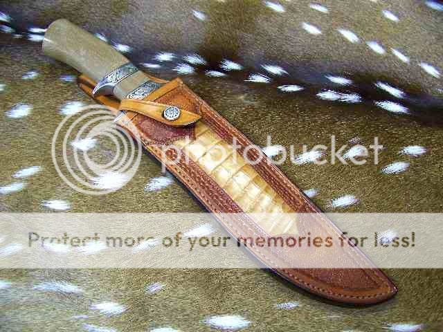

I got the engraving of the bolster and sheath finial done. It will be shipped to Paul Long tomorrow. Then to Coop for the photograph. It is almost done. Hope you like it.

Man, this looks good! I'm loving the engraving, Joe. Your work, like everyone who endears themselves to quality, has gotten even better. Witness ^^^^
I'm looking forward to wrapping up the ingredients to savor. :)
Coop
Really fantastic work Joe! The engraving ties in so well with the pattern of Dave's steel that it really makes for a visually pleasing combination!
"Like it" doesn't quite cover it. :D Looking forward to the Long and Coop contributions.
