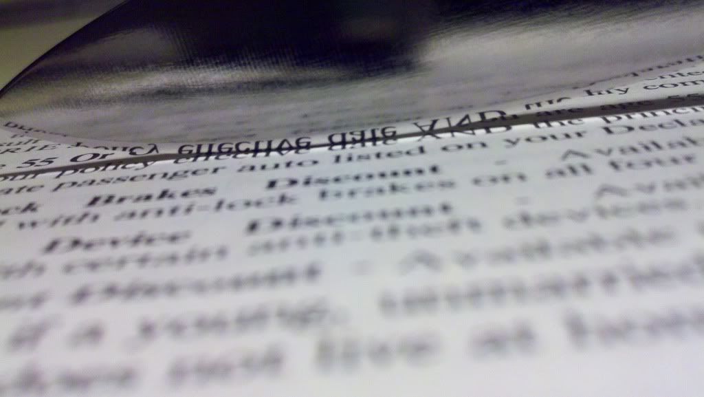

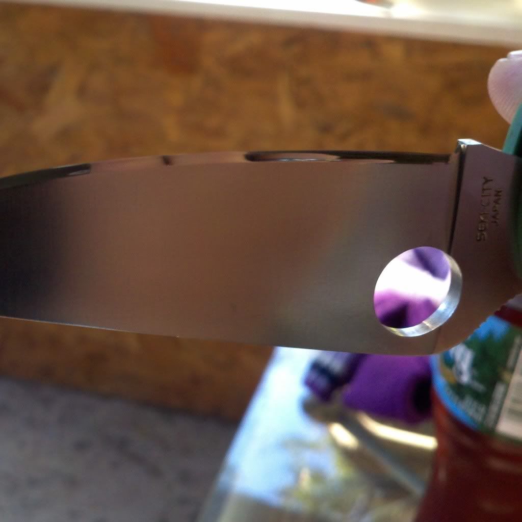

Almost there. I used the back of a belt like mentioned earlier and that seemed to help. Just have to wait for the new belts to come in, the old ones are too worn. Just a few light scratches I hope can polish out with the new belts!
I wish I had a nice camera for macro shots of my many polished edges, I think all my knives...
phone picture so it is not even close to actual mirror shine.

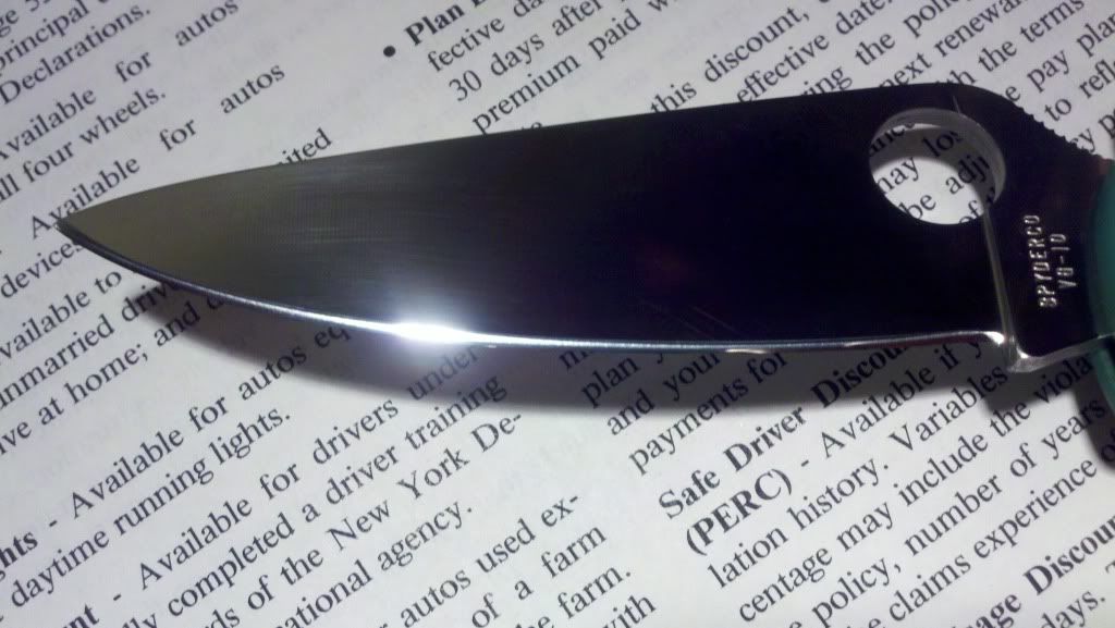

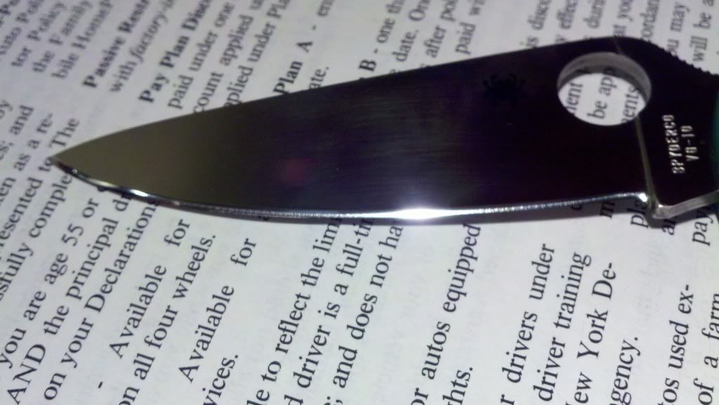

So I got my belts! Went all the way to 12,000 grit. And here is the result :
Not as good as I hoped. Still grind lines. I was hoping they'd smooth out. Even with careful attention to grit progression. Now, don't get me wrong, she's sharp as all get out! However, I thought it would be perfect. I'll have to go to the strop and see how that works. Probably the same results as before.

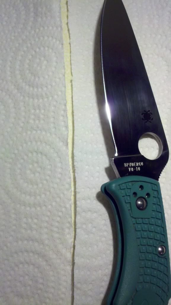

I do love that fine polish! However, it is also very sharp. Push cutting paper towels is no easy task.
It looks to me (and I can't see the edge as good as you) that you are just missing one of the grits a little. The other guys were right on the money about being very careful with grit progression. It looks like your first attempt had a mix of coarse grains and finer grains, now it just looks like you skipped one of the middle grains a little too quickly, or you might have switched to a final stropping method that is actually backing the mirror polish off a bit.
Contrary to how a lot of people use the Edge Pro, I think you just need to refine your ability to identify grain patterns, pay extremely close attention to the detail, and such (it's easier to see problems after you get to a really high grit, but then you have to do a lot of that work over to fix it). Get a loupe, and maybe even work up a progression on one of your knives, leaving a section of blade in the previous grit, so you can examine each grind pattern next to one another. I'm like the other guy though, maybe mirror polishing isn't that important - I get caught up in diminishing returns often as well, but in this case you wear the blade with every sharpening. It's like over cleaning a gun too much - it often does more damage than it helped to begin with. Good luck either way OP! I think your edge looks great, and Rob's edge is beautiful, only you know if attaining a mirror polish is worth your time and investment.
