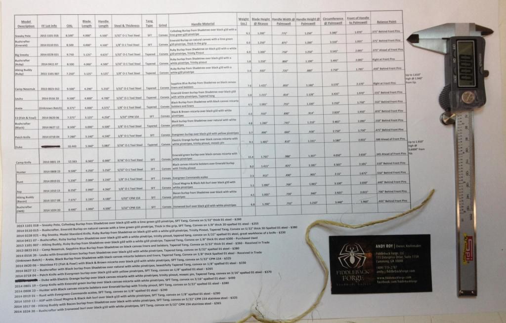

When I score a new knife, I copy and paste the description to the bottom of an excel spreadsheet to start my record keeping process. I also set up a measurement worksheet to fill out when I receive the knife.
I use the Fiddleback packaging twine to help measure the circumference.

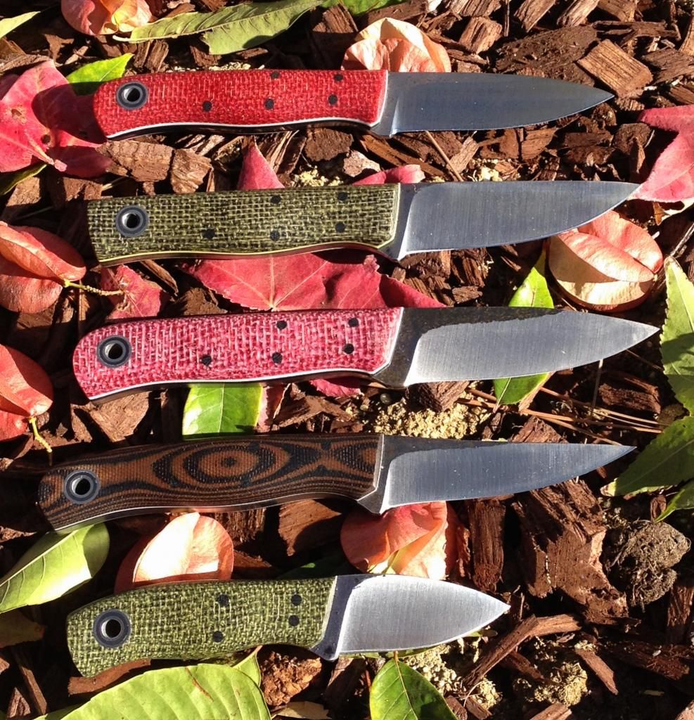

3” Models:

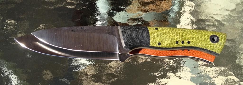

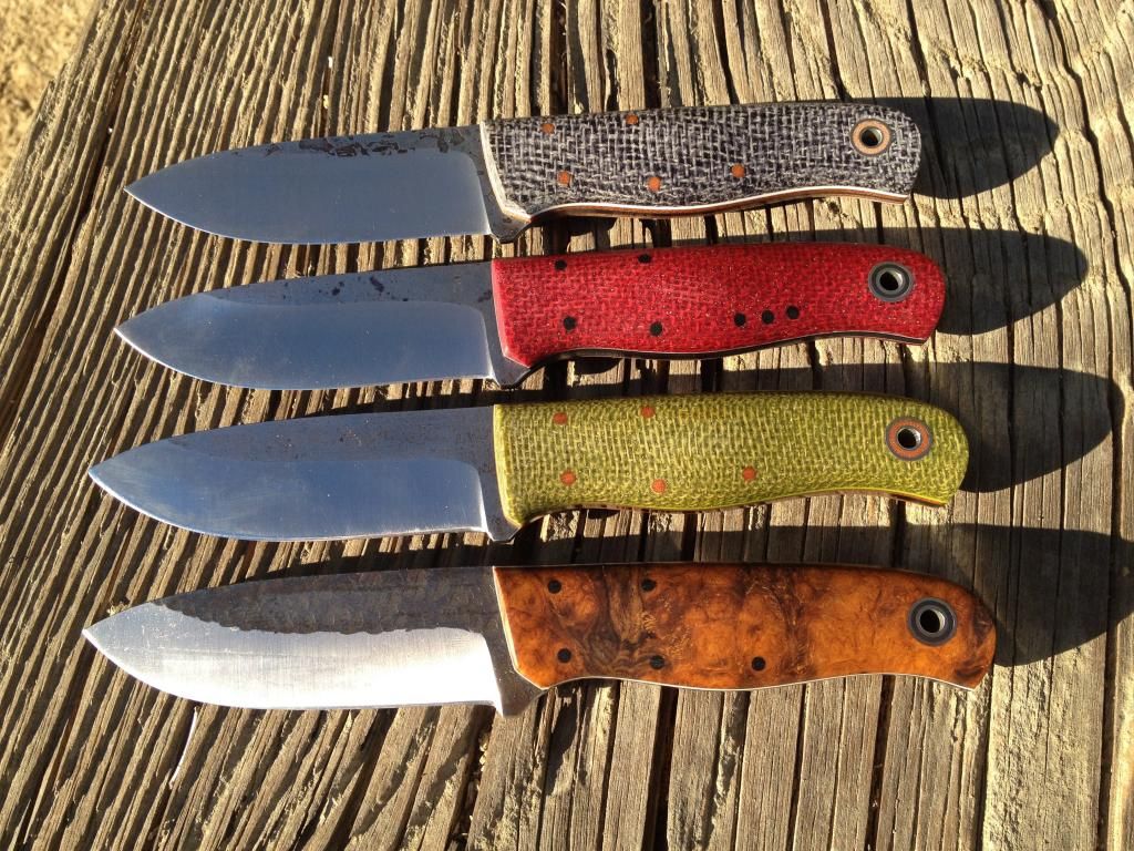

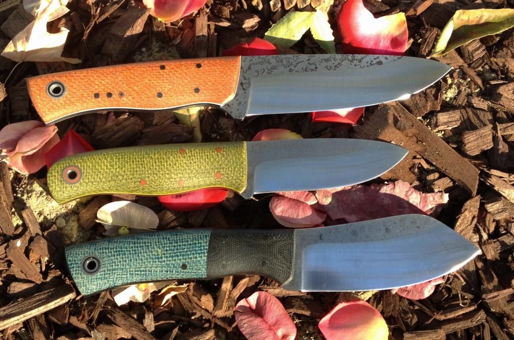

(Top to Bottom: Hiking Buddy “Ruby”, Patch Knife, Hiking Buddy “Bacon”, F2 “Fish & Fowl”, & Runt)

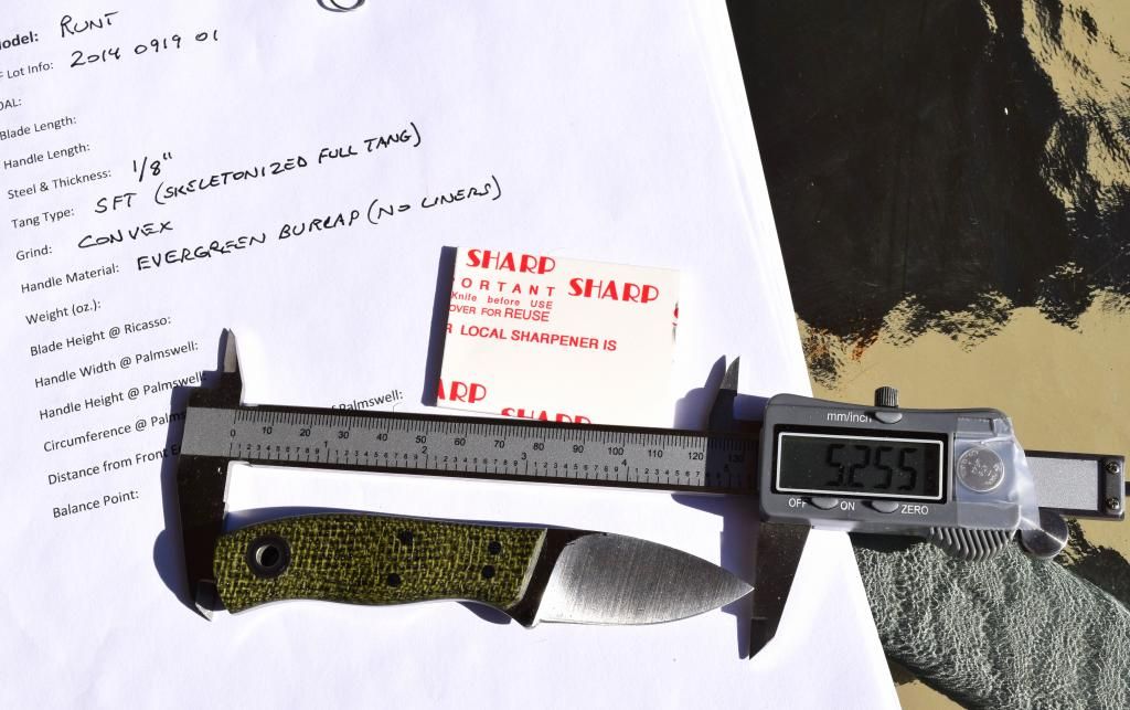

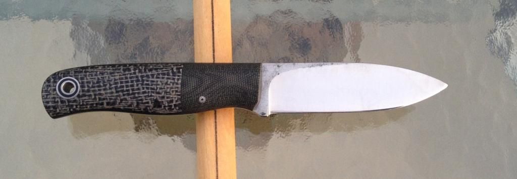

Runt:
Notes:
The Runt is the smallest knife in Andy’s line-up. It is very popular and always sells out quickly on Fridays or dealers’ shelves when they pop-up. It is a three finger utility knife. I got the opportunity use thurin’s Runt for a while as part of our “Trio Exchange” thread. That knife surprised me in a positive way because it had a thick contoured handle that provided excellent control for its size. I tried to purchase my own Runt for several months after that and finally scored this Evergreen one. This one is substantially thinner in the handle width.
Here is the link to the “Trio Exchange” thread where I discussed my impressions of the Runt if you would like more background.
http://www.bladeforums.com/forums/showthread.php/1206786-Trio-Exchange?highlight=Trio+Exchange
FF Lot Info: 2014 0919 01
OAL: 5.230"
Blade Length: 2.000"
Handle Length: 3.230"
Steel & Thickness: 1/8" O-1 Tool Steel
Tang Type: SFT (“skeletonized full tang”
Grind: Convex
Handle Material: Shadetree Evergreen burlap “Commando” (i.e. no liners) with black pins
Weight (oz.): 2.3 ounces
Blade Height @ Ricasso: .915"
Handle Width @ Palmswell: .490"
Handle Height @ Palmswell: .905"
Circumference @ Palmswell: 2.550”
Distance Front of Handle to Palmswell: 1.675”
Balance Point: .550” Behind Front Pins

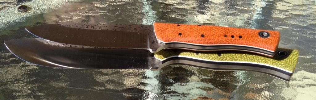

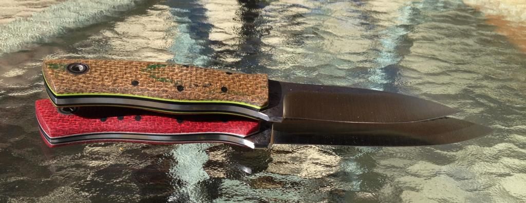

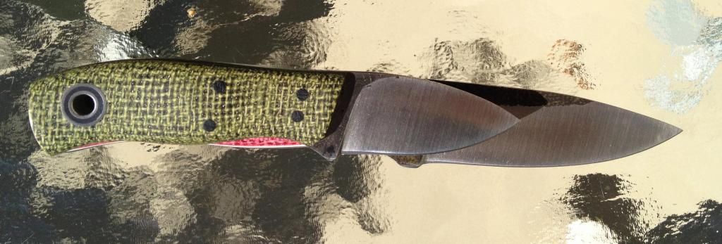

Here is the Runt on top of a Hiking Buddy for size comparison.

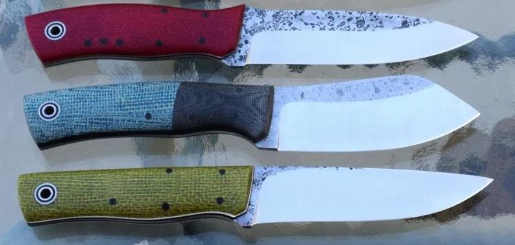

3” Models:

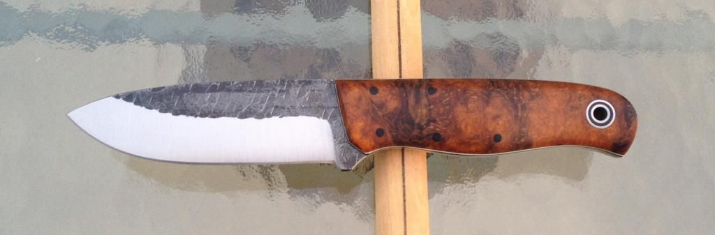

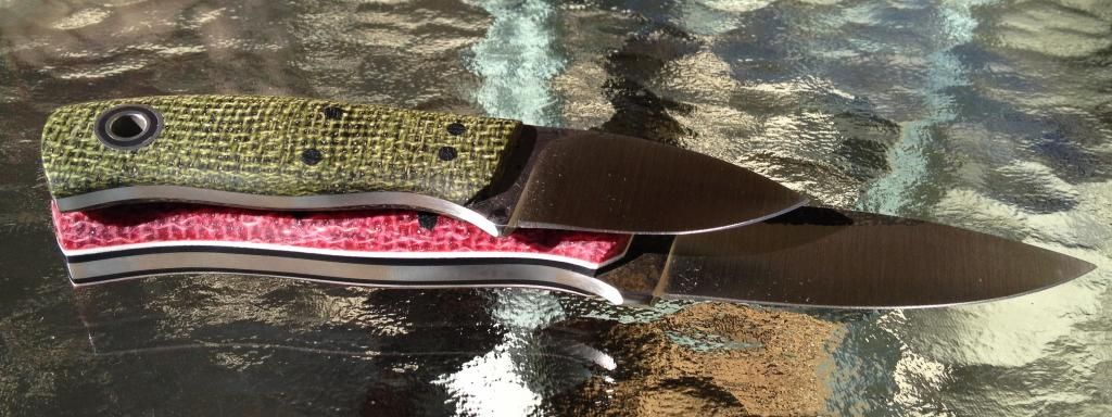

Runt:
Notes:
OAL: 5.230"
Grind: Convex
