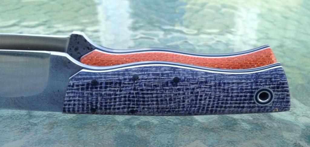

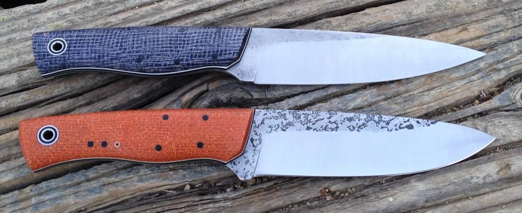

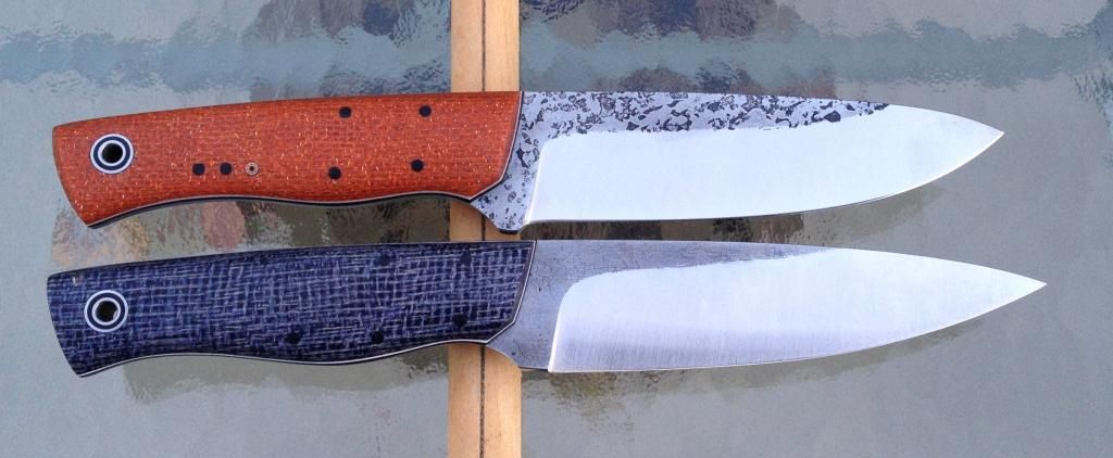

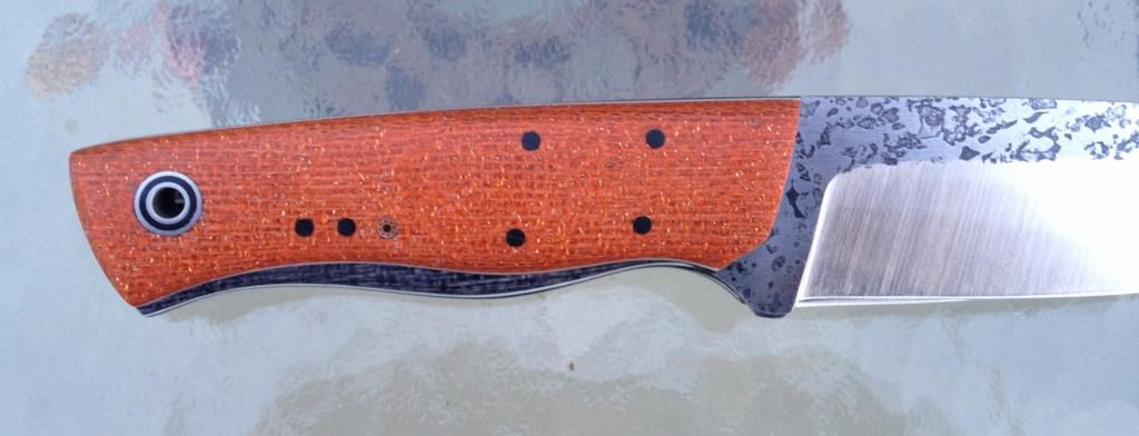

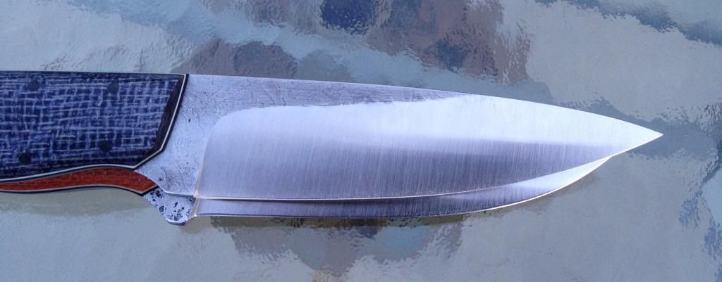

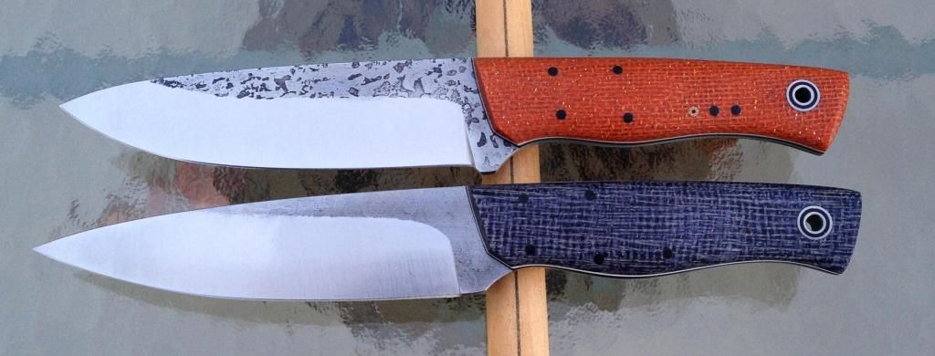

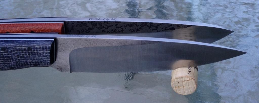

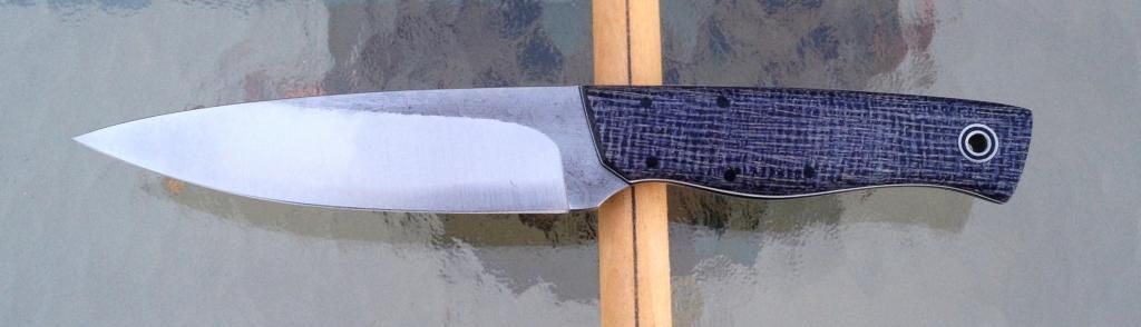

Here are a series of photos of the Woodsman with a Duke. The Duke is the most closely related Fiddleback for comparison.
The Woodsman has more of a fine spear point than the Duke.

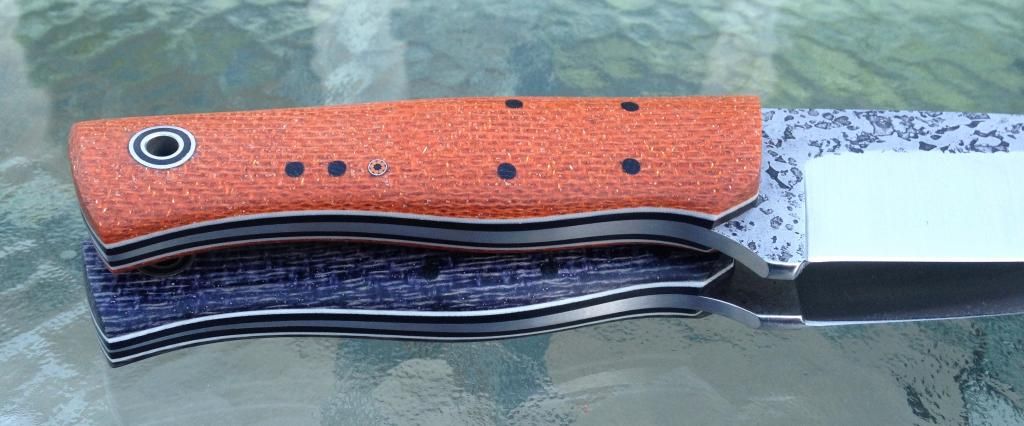

The balance of this Woodsman is more neutral than my Duke. The Duke is 3/16” tapered tang O-1 which gives it a slightly blade heavy balance. I like that on this particular knife, but using neutral balance as my standard, I had to give the Duke two smiley faces for balance while I gave the Woodsman three.

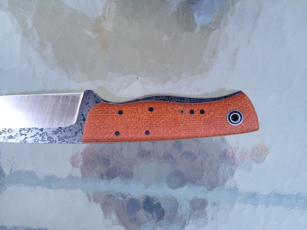

The blade on the Woodsman is more of a centered spear point that the Duke. The Woodsman has a more sloping spine and a continuous curve cutting edge of the blade that meet at the fine point of the tip. The Duke has less immediate curve on the spine and a shorter curve on the cutting edge near the front end that yield more belly and a stronger shorter tip in my opinion.

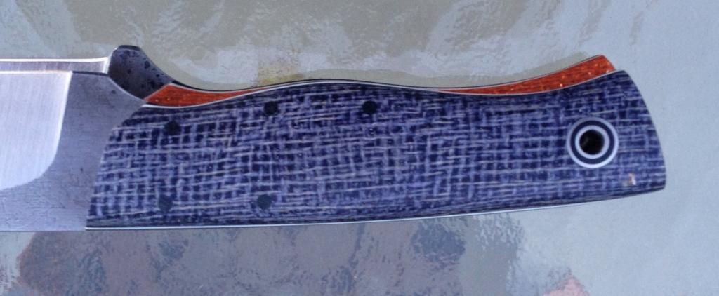

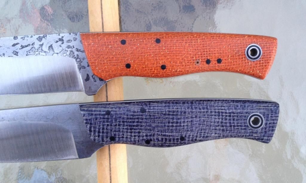

I always assumed that the handles were the same between the Duke and Woodsman. On closer examination, there are differences (at least on my two samples.) The Woodsman has more pronounced curves on the bottom side of the handle. The maximum height of the handle at the palm-swell is taller on the Woodsman but the lowest height of the forward curve is shorter than the Duke. The lowest height of the rearward dip is roughly equivalent on both models. The distance from the front edge of the handles to the center of the palm-swell is a little longer on the Woodsman also. This means that the Woodsman has slightly more noticeable lower handle curves versus the Duke’s more subtle ones. I don’t know if this is representative of each model or just normal variation based upon who profiled the blank. Either way, I thought that it was worth noting.

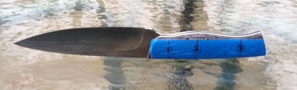

See the photo below for the referenced measurement points 1, 2, & 3.
The actual measurements are as follows:
* Position# 1 Position# 2 Position# 3
Duke 1.151” 1.221” 1.034”
Woodsman 1.105” 1.285” 1.040”

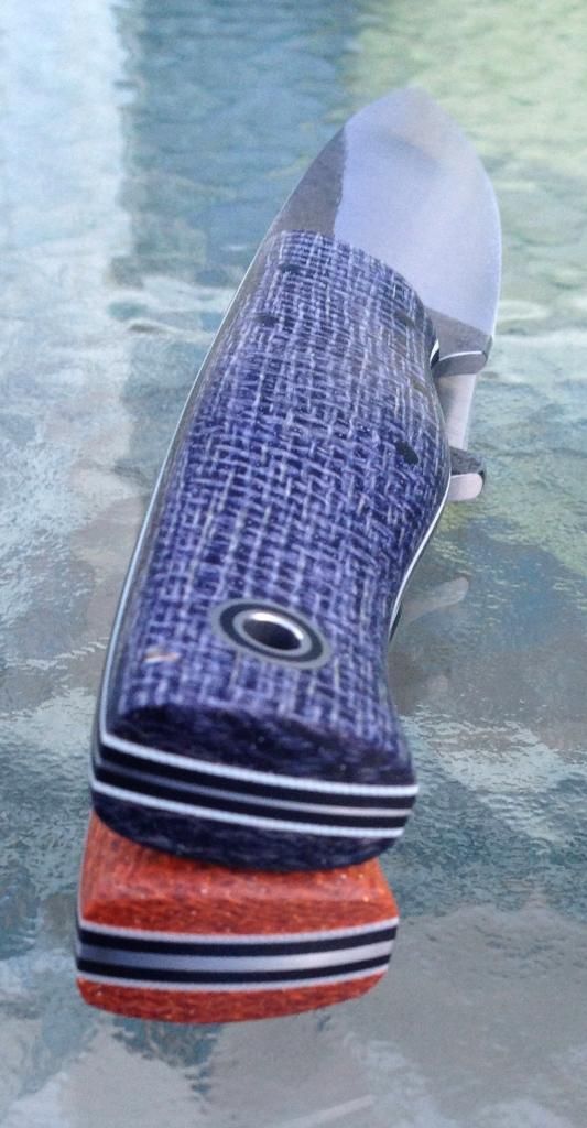

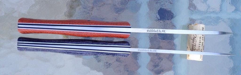

Here are a few more visual comparisons to show what I am talking about.
In general, I have learned that I strongly prefer tapered tangs on both the Woodsman and the Duke for weight reduction and improved balance.

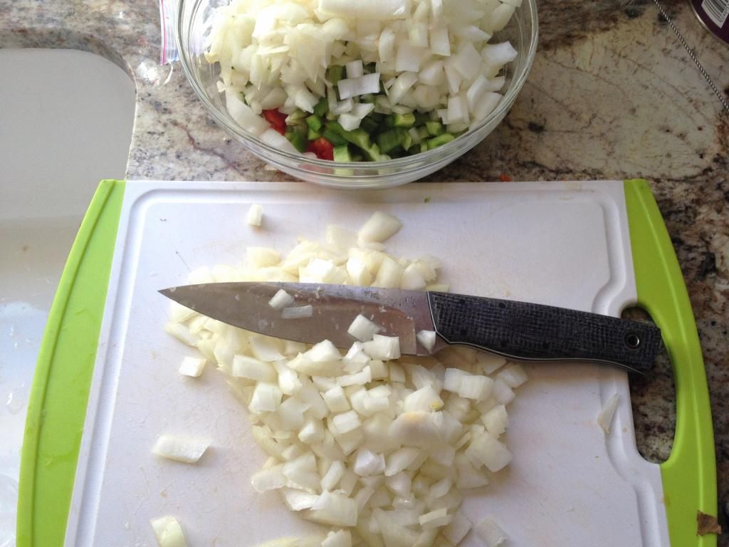

Here is the Woodsman doing some kitchen duty at home.
