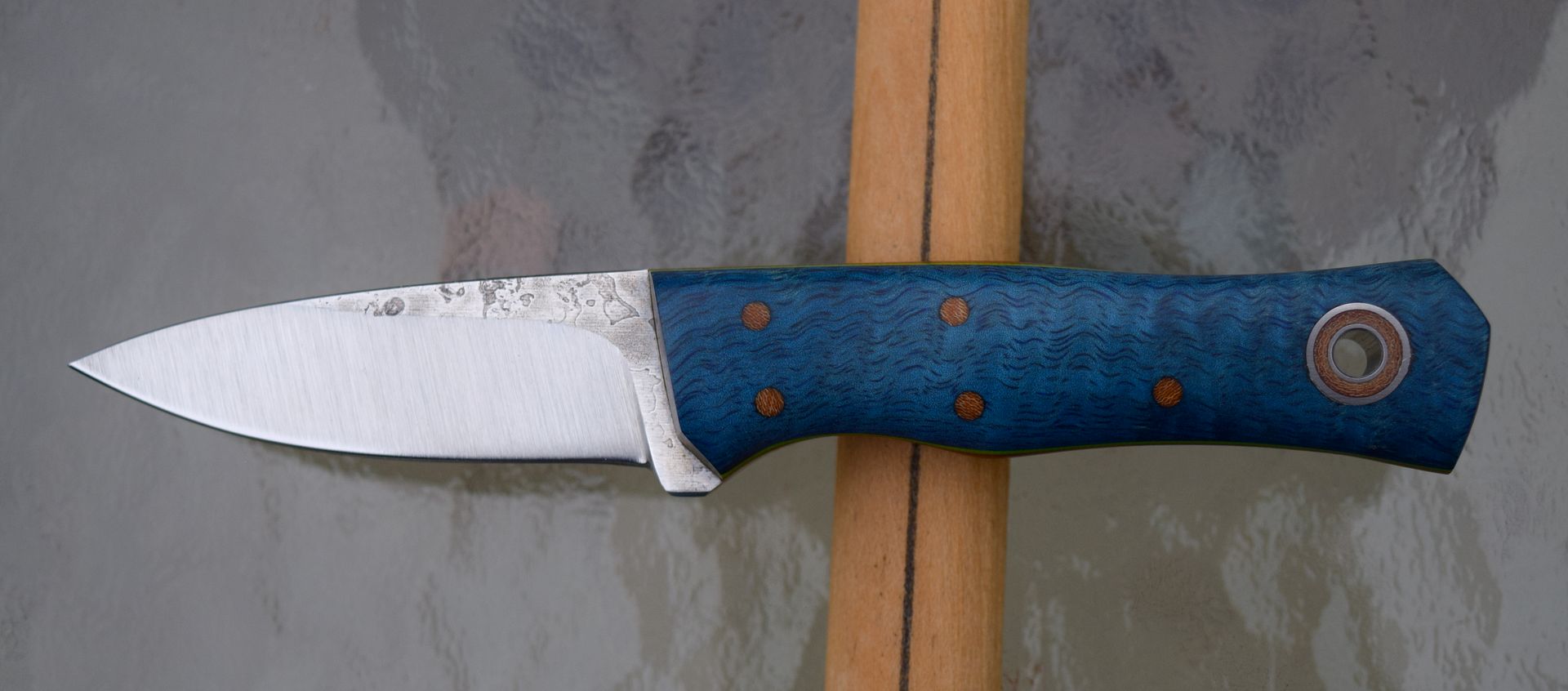

Model: Esquire
Notes: This model was introduced in the latter half of 2014. It has proven to be very popular with the EDC pocket carry crowd. This particular knife belongs to my friend Peter (“prom52”.) I asked to borrow it to determine if this model is one I want to buy at some point.
FF Lot Info: 2015 0320 09
OAL: 6.250”
Blade Length: 2.750”
Handle Length: 3.500”
Steel & Thickness: 0.125” O1
Tang Type: SFT
Grind: Convex
Handle Material: Blue Curly Mango over natural w/ lime pinstripes
Weight (oz.): 3.1
Blade Height @ Ricasso: 0.889”
Handle Width @ Palmswell: 0.703”
Handle Height @ Palmswell: 0.885”
Circumference @ Palmswell: 2.500”
Distance from Front Edge of Handle to Center of Palmswell: 1.825”
Distance from Front Edge of Handle to Balance Point: 1.361”

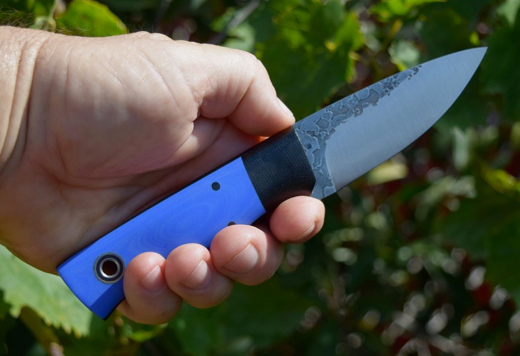

Model: Bushnub
Notes: The Bushnub is a smaller version of the flagship Bushfinger. It was introduced with a group of new models early in 2015. It fits into what I call the group of 3-1/2” models.
FF Lot Info: 2015 Blade Show
OAL: 7.520”
Blade Length: 3.455”
Handle Length: 4.065”
Steel & Thickness: 0.127” A2
Tang Type: SFT
Grind: Convex
Handle Material: Cornflower Blue G-10 over 1/8” black micarta liners & bolsters
Weight (oz.): 5.0
Blade Height @ Ricasso: 1.219”
Handle Width @ Palmswell: 0.780”
Handle Height @ Palmswell: 1.105”
Circumference @ Palmswell: 3.220”
Distance from Front Edge of Handle to Center of Palmswell: 2.025”
Distance from Front Edge of Handle to Balance Point: 1.202”

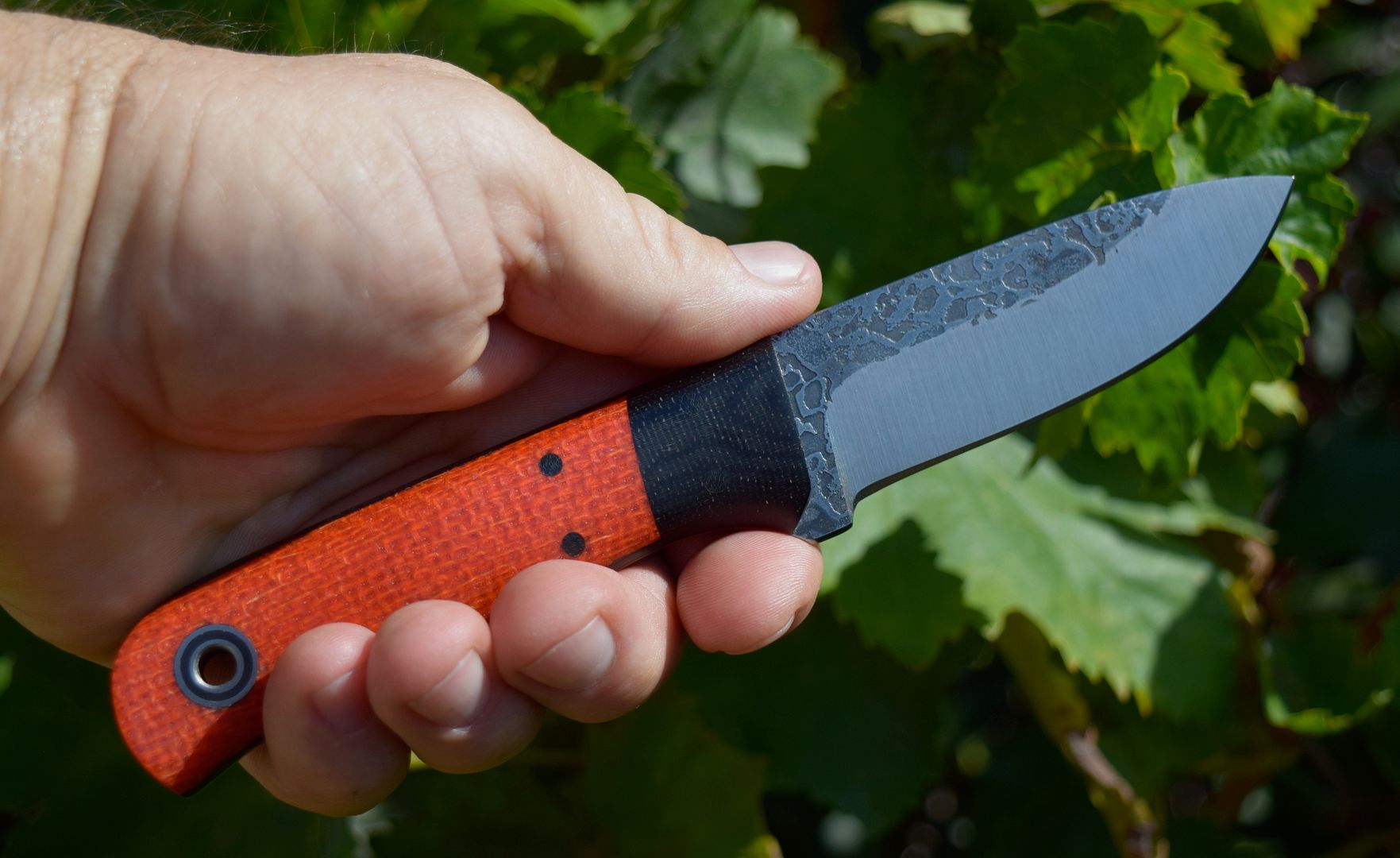

Model: Bushcrafter Jr.
Notes: The Bushcrafter Jr. is a smaller version of the popular Bushcrafter. It also was introduced with a group of new models early in 2015. Actually, it would be more accurate to say that this model was re-introduced. If you look back at the early pages of this forum, you will see that there were a couple of custom BC Jr.’s made in the early days.
OAL: 7.510”
Blade Length: 3.380”
Handle Length: 4.130”
Steel & Thickness: 0.156” A2
Tang Type: SFT
Grind: Convex
Handle Material: Tangerine burlap over 1/8” black micarta liners & bolsters
Weight (oz.): 5.3
Blade Height @ Ricasso: 1.085”
Handle Width @ Palmswell: 0.792”
Handle Height @ Palmswell: 1.010”
Circumference @ Palmswell: 3.085”
Distance from Front Edge of Handle to Center of Palmswell: 2.128”
Distance from Front Edge of Handle to Balance Point: 1.160”

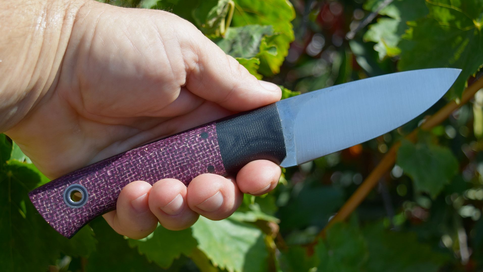

Model: Bushfinger
Notes: The Bushfinger has long been Andy’s flagship model. My first Fiddleback was a used Bushfinger and I have owned several since then. I sold or traded all of them in favor of other 4” models. When a forum friend approached me with an opportunity to buy this knife in a burlap color I didn’t have, I decided to give it one more try.
Lot Info: 2015 0619 ??
OAL: 8.820”
Blade Length: 3.910”
Handle Length: 4.910”
Steel & Thickness: 0.152” O1
Tang Type: Tapered
Grind: Convex
Handle Material: Electric Plum burlap over 1/8” black micarta liners & black bolsters
Weight (oz.): 5.8
Blade Height @ Ricasso: 1.295”
Handle Width @ Palmswell: 0.804”
Handle Height @ Palmswell: 1.140”
Circumference @ Palmswell: 3.445
Distance from Front Edge of Handle to Center of Palmswell: 2.044”
Distance from Front Edge of Handle to Balance Point: 1.255”

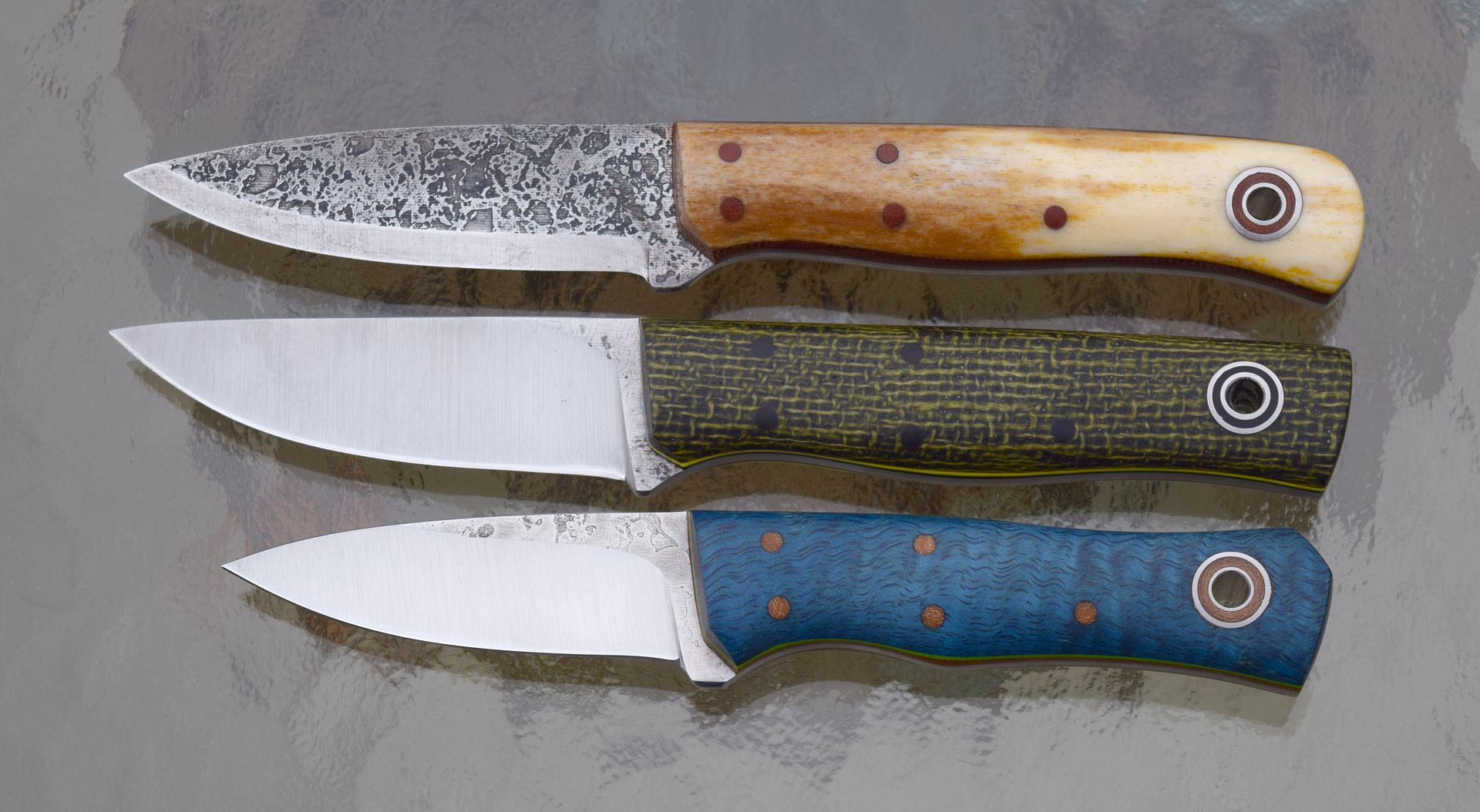

Here is the Esquire shown below a Hiking Buddy and Patch. The Esquire is 1.100” and 1.045” shorter than those two knives respectively. That is a considerable length savings if you are looking for an EDC style knife to carry in one of the popular inside the pocket sheaths.
I also like the fact that the spear point tip on this model is located close to the centerline of the blade.

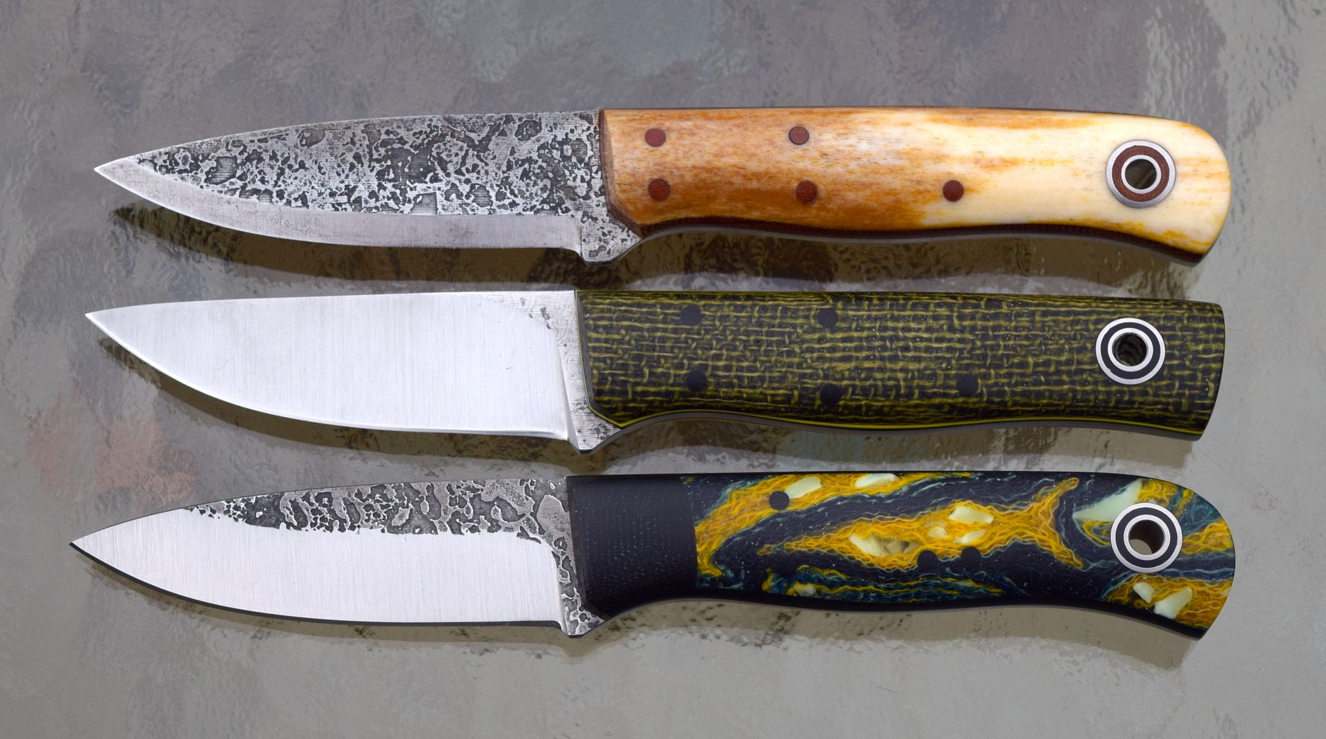

Here are the Hiking Buddies with a Patch in-between. These are similar size models with a different feel. I like both models, but in the past I have tended to reach for the Patch more often. That may change going forward since the scandi grind on the Bone Hiking Buddy adds a new dimension to things.
The two Hiking Buddies have very different personalities between the modern look of the bolstered Starry Night burlap on convex 1/8” spalted A2 vs. the old school thick handled contoured bone & scandi grind on 3/32” spalted O1.

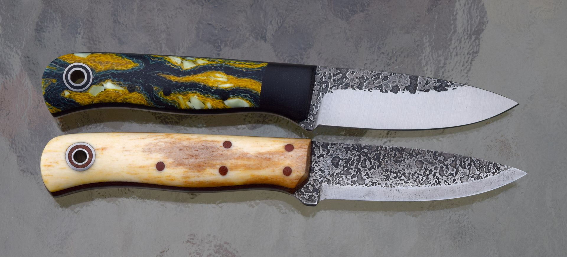

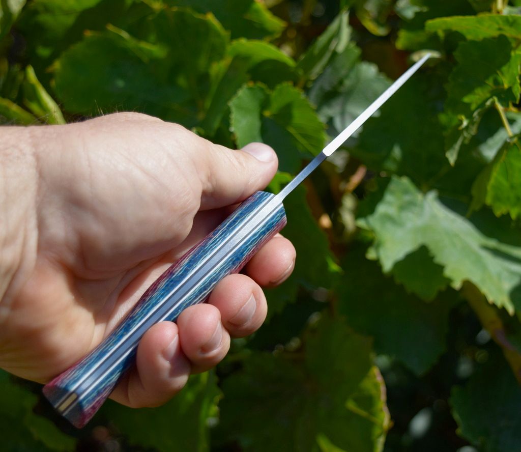

Here is another view showing the difference in handle thicknesses especially in the middle and front sections. I want to note that even though the Starry Night HB is the thinner of the two, the handle is still more full and solid feeling that prior HB’s I have owned.

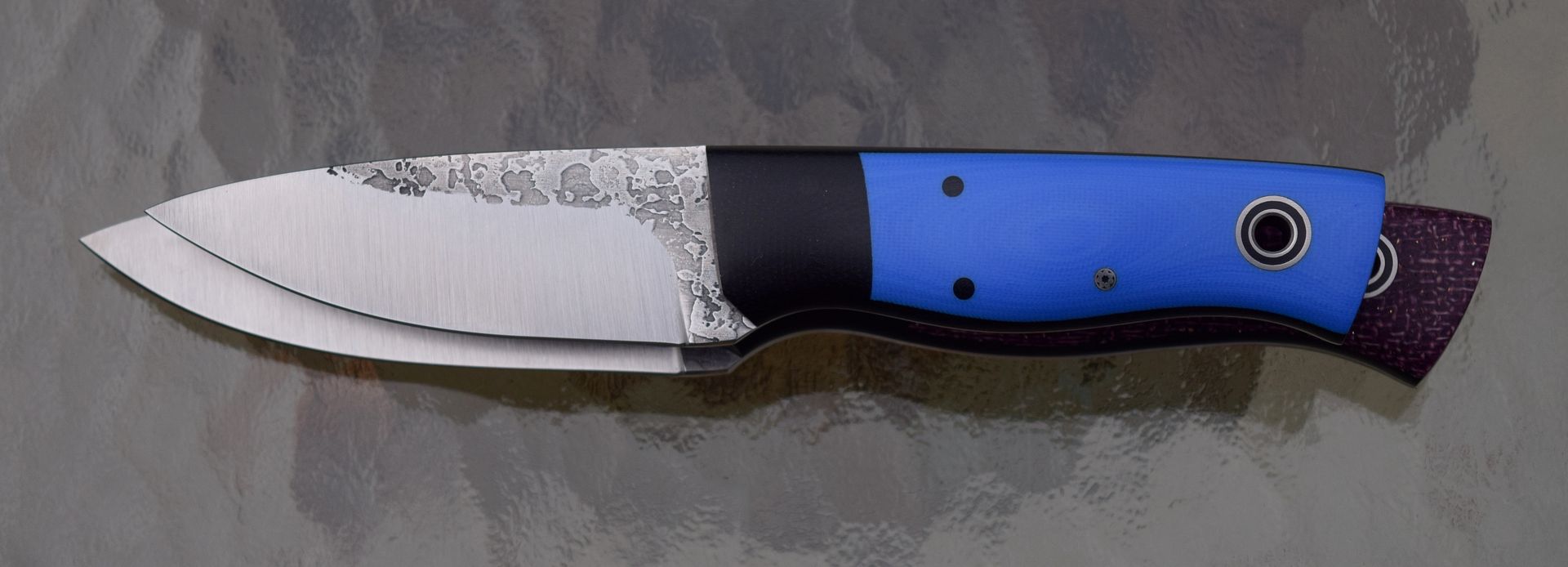

The Bushnub is 1.300” shorter overall than the Bushfinger. The blade is 0.445” shorter and the handle is 0.845” shorter. The distances to the balance point and center of the palm swell are very close between the two. That means means most of the shortening occurred on the back end of the handle while retaining most of the Bushfinger handle shape.
Here is another view of these two in the stacked position.

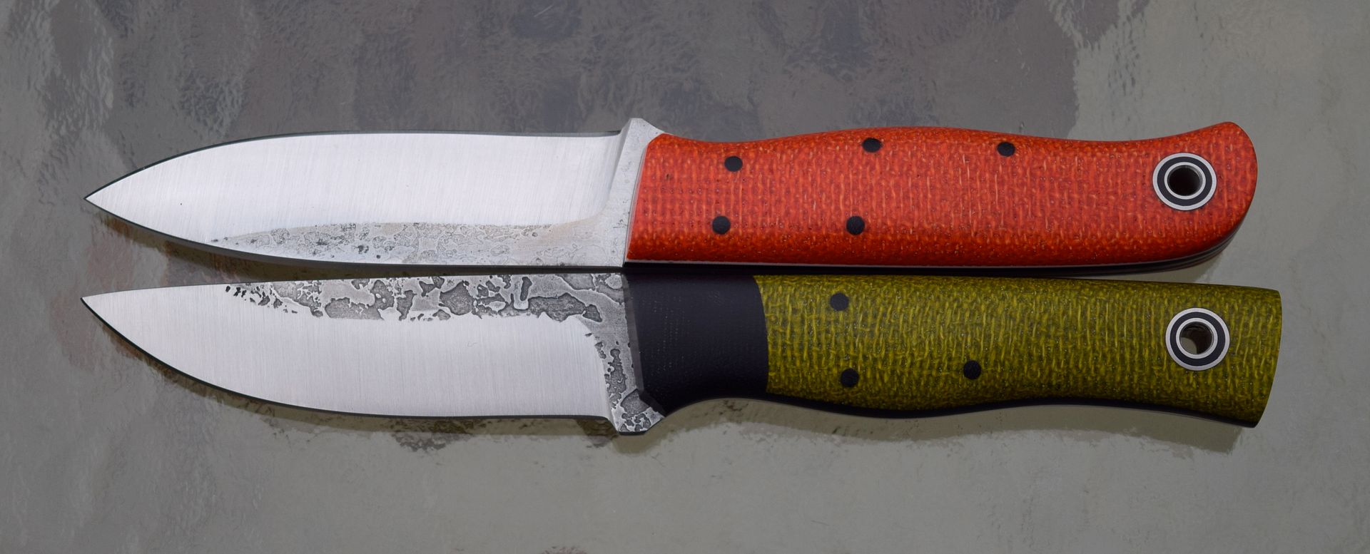

Here are my group of 3-1/2” models. I like the blade profile and centered spear point of the Monarch as well as the taller handle height vs. the BC Jr. The Bushcrafter Jr. is the most visually appealing profile of the three to me. The handle feels great in my hands due because the round butt makes more grip options work for me. The straighter top section of the handle on the Bushnub may work better for some hands, but it is my third choice in this group.
Here is anther view of the Bushcrafter Jr. and Bushnub to emphasize the difference between the round vs. square butt handles.
