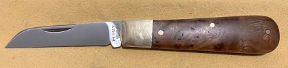

I am looking for some advice on how I might go about fixing a poorly inserted blade. Hopefully, the pictures will be adequate to show what I am talking about.
The knife in question.
The blade is centered in the blade well when closed.
The blade is aligned straight with the backspring when open.

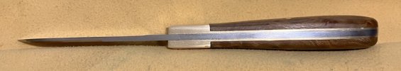

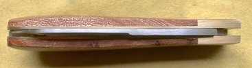

It is a different situation at half open. The blade is sitting crooked between the bolsters. It is actually enough that when held up to a backlight, the pins are visible on both sides of the blade. First the pile side at half open. Second pic the mark side at half open. The action is very rough opening. The second pic shows the wear caused by the blade being too tight to the bolster on the pile side. It is bad enough that it takes considerable force to initiate closing the blade from full open.
Below is a slightly exaggerated drawing to illustrate how the blade sits at half open.
At full open the blade is very tight to the mark side and on the pile side bolster appears to be misaligned.

Wow, that could be a few things...could be a bent pivot pin. Could be a blade pivot hole that is not square to the bolsters/blade flat. How square does the tang look? Is it wearing or look like it's at a weird angle? Could also be a pivot hole that is larger than the pin...
i think short of taking it apart, you might have to live with that. thats one of the reasons my interest in these moved on so fast, theyre are not particularly well put together, sure theyre put together and functional but thats about it.
Thanks for the replies @glennbad and @mrknife. The tang looks square to me. The only wear that seems to be occurring is on the mark side of the tang. I have the knife on my desk and open and close it frequently. It is loosening up somewhat. It is quite useable, is solid when open and sharpened up nicely. I guess I will just use it like this for a while. It is not likely to become a favorite EDC anyway as I prefer to carry a 2 blade jack with a clip or spear blade.
