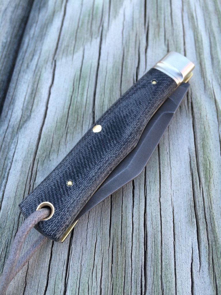

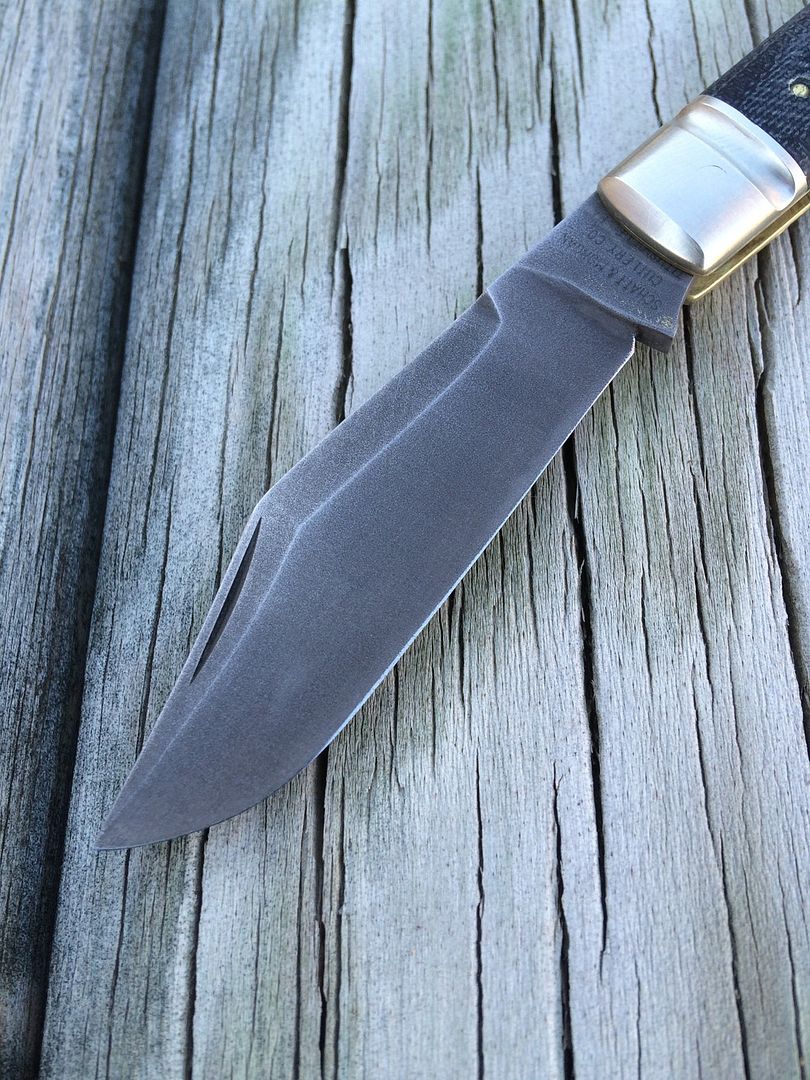

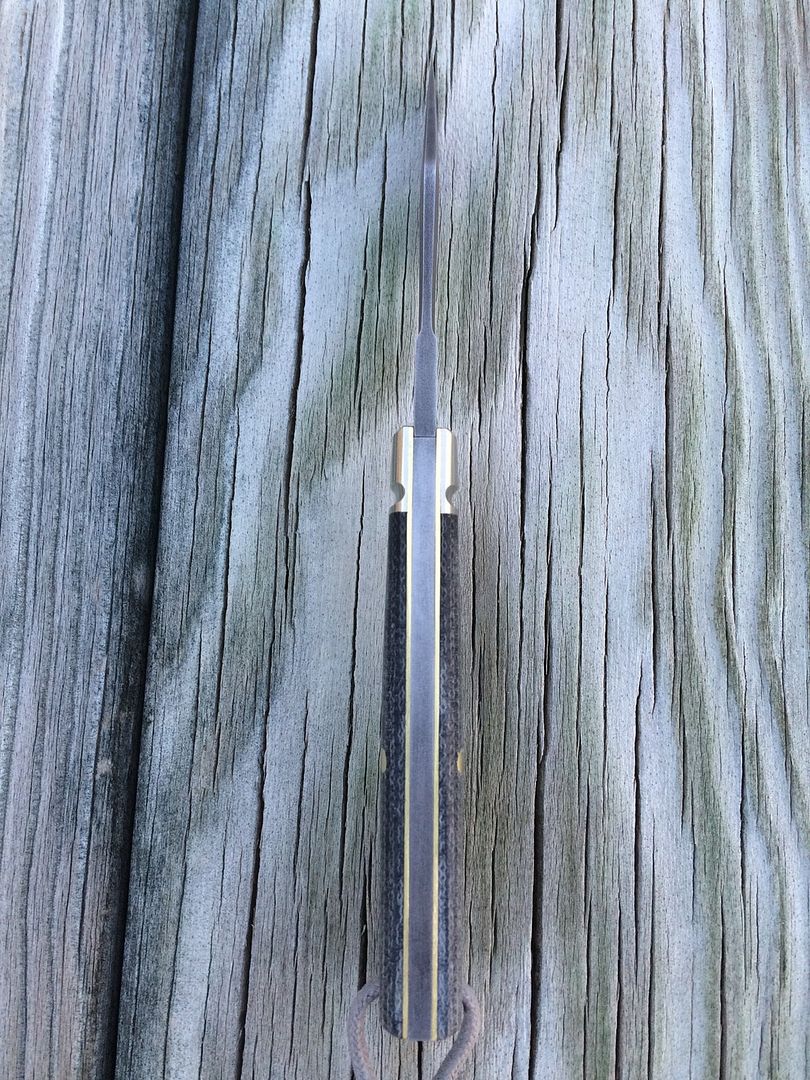

Finally finished mine up. Here's a before pic
It a Schatt & Morgan gunstock, worm groove bone, ATS-34 steel. The blade had a low saber grind on .139" blade stock (!). It was also super thick behind the edge, making it a terrible cutter. I reground the blade and swedges, acid etched the blade and spring, made some of my own denim micarta, added a lanyard tube, and rat tailed the bolsters. Here is how it looks now.
This was my first time modding a slipjoint, and I'm super happy with the way it came out! It's got to be one of my favorite knives now. There's a work in progress thread here:

Thank You for showing this knife and the process of modifying! The result is fantastic:thumbup:!!
I always wondered how the denim came into micarta, now I could imagine, thanks!:)
HOLY COW WHAT A BEAUTY SHIPWRIGHT!!!!!
That's knocking it out of the park, but for a first mod, unbelievably awesome! I'm in awe.
