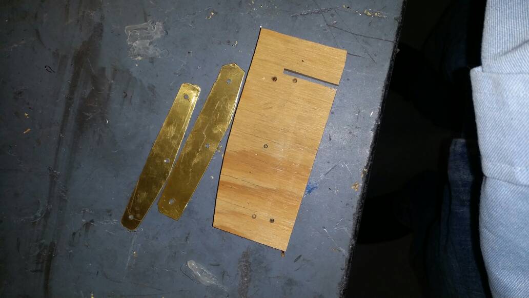

Got the drilling done in the liners, having brass turned down to pin size tomorrow.
Gonna be a fun wharnie for my dad's birthday
No im actually using a Schrade oldtimer clip blade. It was a jack with a broken off secondary, but only missing an 1/8 of tip on the clip that had snapped off. Spring is still strong so I figured it would be a good first knife to conpletely repair. No bolsters, I don't have any stock to use and this knife is going to be made entirely of scrap materials. I'll have some dark brown possibly natural micarta scales and brass pins.
I might need to make mild steel pivot pins though I think.

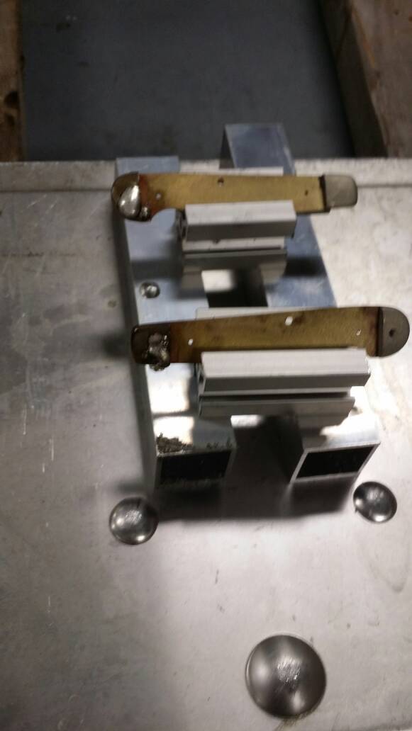

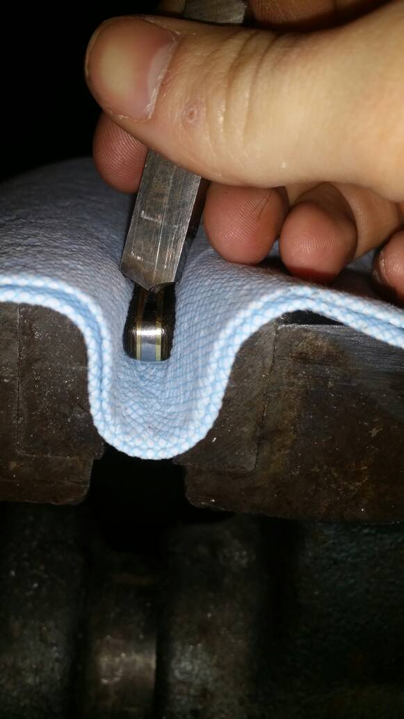

Here's how I file down pins before assembly, they fit nicely in corrugated cardboard.

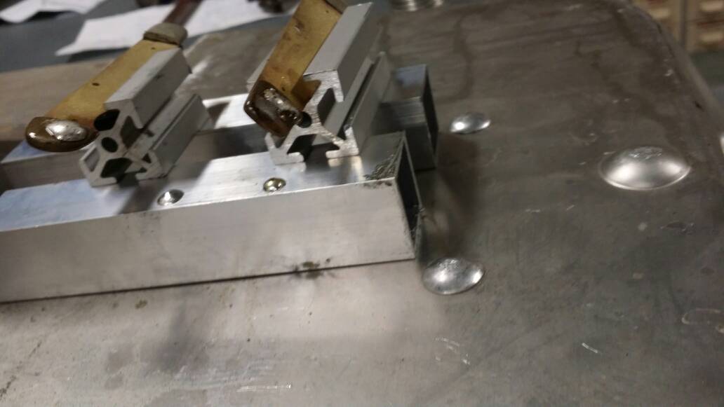

Soldering on the Camillus to fill in countersunk holes.

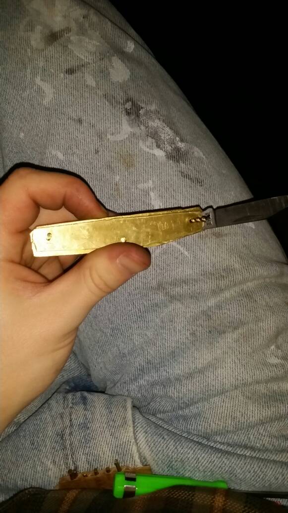

Here's an assembly, snap is very strong but I suspect that is the reason the pin in the bottom holding the tail of the spring is slanted when assembled. Going to file the holes on liners and spring to ease tension.
Any other ideas to fix this? Or should I cut out another liner and be extra careful that it all lines up?

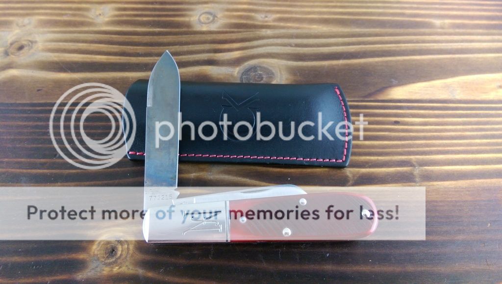

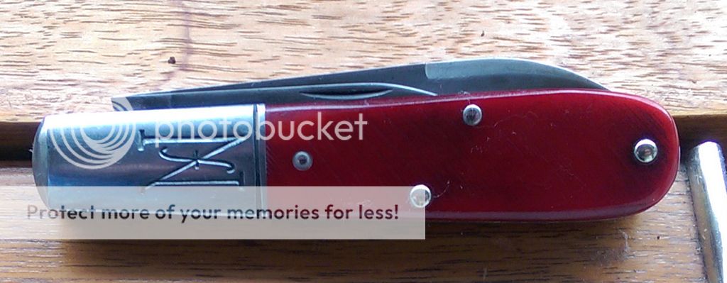

As for me, I've spent a little time on my 77 barlow. My goal was to be able to pinch open the main blade. After playing with it for a while I wasn't sure I wanted to go the easy open notch route. It seemed like it might bother me when I was using the knife, so I was looking for alternatives. The first thing I did was to reshape the secondary into a wharncliffe. My goal was to increase the amount of steel I'm able to grab hold of on the main blade. I didn't touch the edge at all, I just rounded off the top of the blade.
This helped a little, but I still struggled to really get a hold of that main blade. At first I was going to shorten the secondary and reshape it back into a coping. This would have given me another 1/4" or so at the spine of the main blade to grab onto. Then I realized that with how high the coping blades ride on these knives I could just lower that down and get the same effect, so that's what I did. The secondary originally rode pretty much parallel to the main blade on this knife.
I don't have any pictures of both blades closed from before I started this project, but here's one with the secondary closed and the main at the half-stop. You can kind of get a feel for how high the secondary is riding.
It was definitely a lot easier to pinch open after working on the secondary blade. The last step of the project was a little filing on the tang of the main blade so that it's not such a hard snap into the half-stop. This lightens the pull a bit when you're first starting to open the knife, which is the hardest part when pinching it open. There was no rush, so I went a little at a time and used it for a couple days and then a little more. When I hit that point where it's easy to pinch open, but still has good snap it was done. It's still a little tough on the fingers if I open and close it a couple times in a row, but for pulling it out, using it, and putting it away it's just right.
I also rounded off the edges at the butt of the knife. I did this for two reasons. First, I didn't like the feel of the sharp corners during use. Secondly, when I first started carrying this knife I was using the CK slip it shipped with. The slip is great, but I had never used one before and wasn't used to it. I was in my basement and went to pull my knife out and the slip had kind of flipped so that it was almost upside down in my pocket. When I pulled it out the knife slipped out and fell onto the concrete floor, chipping the bone right at that edge. Rounding out the corner eliminated that chip.
I feel that this is as close as GEC's come to a perfect knife, and now that I can pinch the main blade open it's just a couple steps farther out ahead of the pack. This knife's been in my pocket every day since Christmas. I couldn't be happier with it.

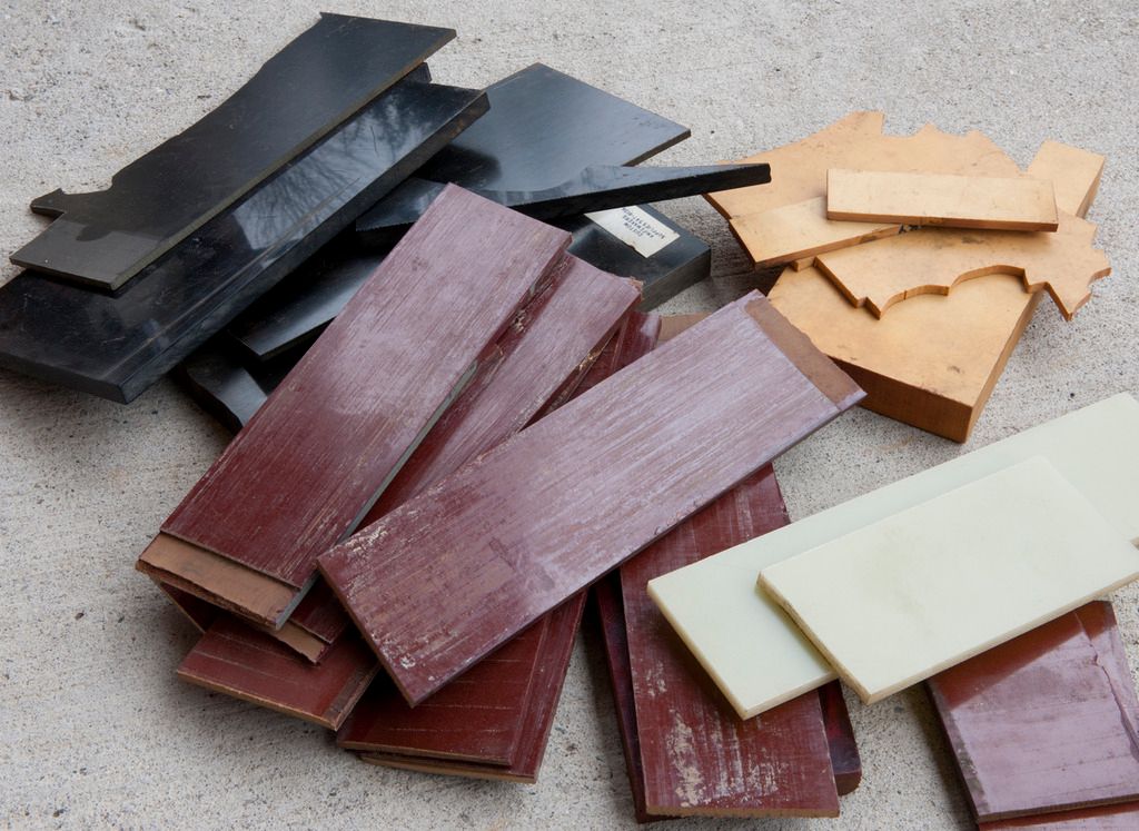

A fellow knifemaker was looking for some vintage Westinghouse Micarta in white and black, so I dug out the stuff I have had sitting around for the past 40 years. Since I don't use it, I almost forgot it was there.

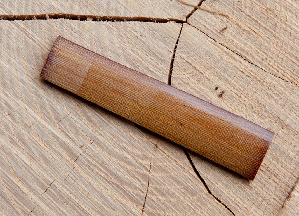

Along with the white and black, there is also a fair bit of vintage Westinghouse natural linen Micarta. It is a finer grain than the usual natural Micarta, very tough, and it will take a polish if desired. It does have an antique look to it. I cut and sanded a piece to different grits to show the effect.
I don't know how much of the white and black my friend is going to use, but if any of you fellows would try some of the linen material for your traditional mod's, send me a PM. I will be glad to send you some, free of charge of course.
