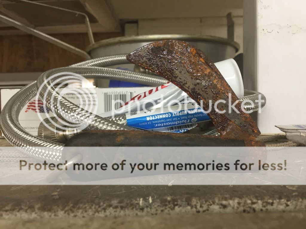

Here is the next one from my bag of goodies. This is an old Sabre brand hawkbill that was left in a tackle box or something. Pretty rusted and useless in its current condition
So I've taken it apart and started cleaning up all the rust. I decided to use a piece of old growth heart pine that one of my buddies gave me. I figured this is an old timey farmers knife so why now use some old timey farmer wood. I've got one liner glued together drilled and sanded. Unfortunately, I left the other one at work so I'll mess with the other side tomorrow. Anyways, here is the progress so far

Thanks Conner, I'm pretty excited about this one. I started piecing it together today but one of my pins started to bend over. And then I ran out of time on my lunch break. I also wasn't very happy about the entire fit of the knife. The gaps between the liners and spring were bigger than i could really tolerate so I'm going to do a little bit more flat sanding before completing the knife. The case has been in my pocket every day since its "rebirth" 😀
Okay fellas, here is the Bighazedified Sabre hawkbill back from the brink of death. I got her put back together last night, applied a few coats of Formsby's tung oil. Then I sharpened the blade, reprofiling the tip a little and added a swedge. Here it is fresh off the buffing wheel. It's got one little knick by the front pin. That's what I get for using pine for the scales but all in all I'm pretty happy with the results. Especially for a knife that most people would have tossed in the trash

Very nice job! :thumbup: You've given that poor old hawkbill a new lease on life, looking better than it did when new. I love the grain in that wood. :)
