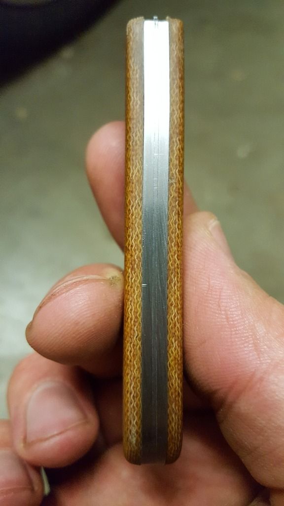

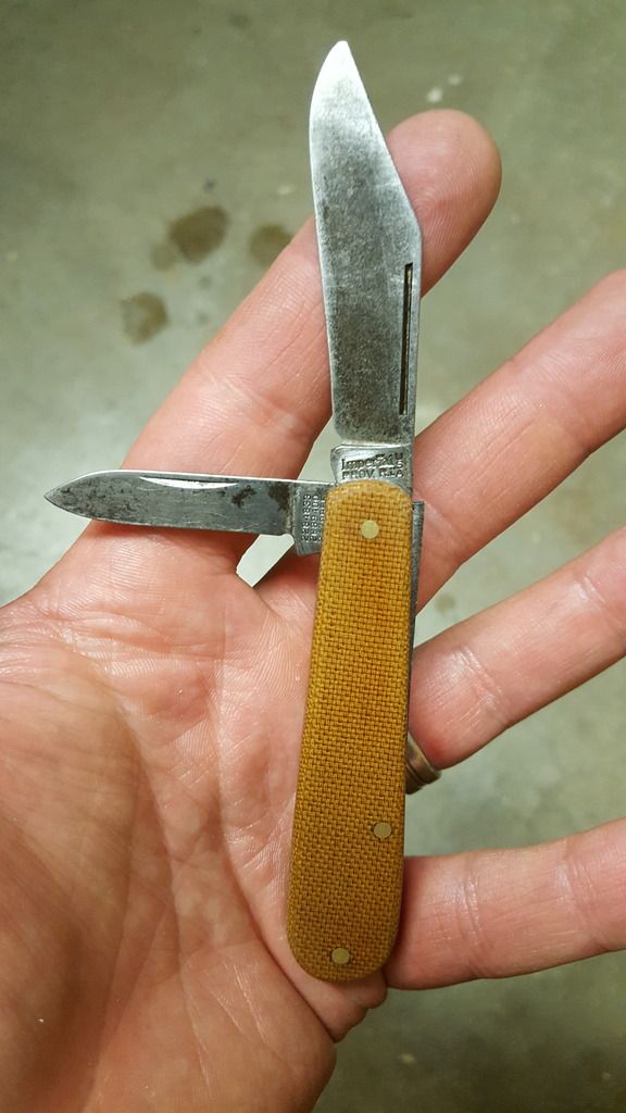

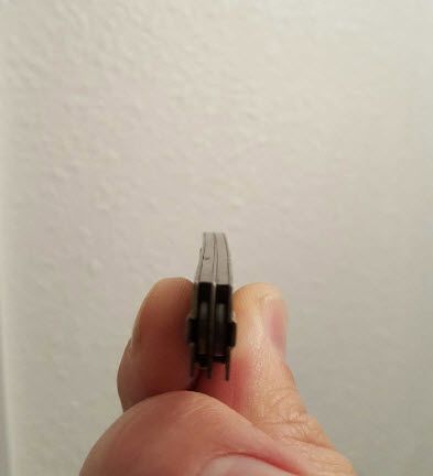

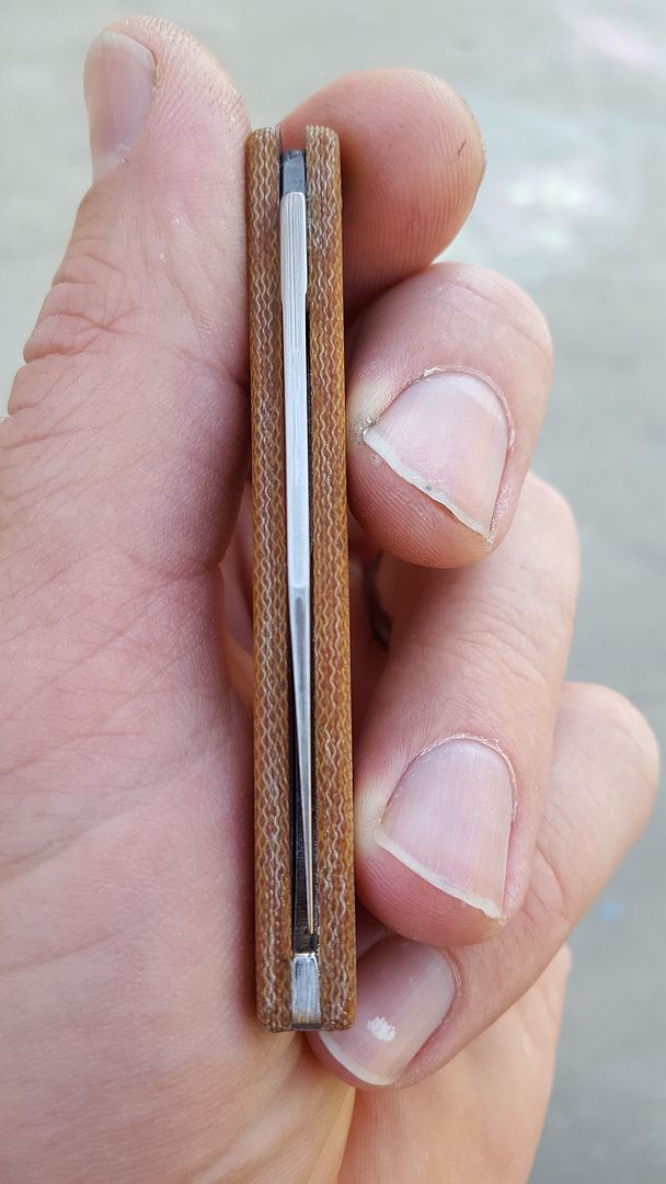

Has anyone had luck straightening offcenter blades? I did it on a Case peanut to great effect, clamping the blade between two pieces and giving it a little tweak here and there and got it dead center, but I think I was able to manage that because the blade was so thin - I turned a 33OT middleman jack into a single spring linerless micarta knife, but the blade is badly off-centered (it was with the original handles too) and I'm trying to live with it but it is really bugging me
I tried tweaking it with the blade clamped into a vice and it's a tiny bit better, not rubbing the side anymore, but the rest of the knife came out so clean and nice, I want it to be perfect. Looking at it, and the picture shows it pretty well, I think it may be ground that way (I'm guessing they use 34OT stockman blades, which are pushed over close to the liner for clearance. It's very parallel until the clip starts, then it veers to the right) so I may have to live with it... Any thoughts or suggestions?

That is really a slippery slope. It's very easy to snap a blade clean off if you hit it wrong. Typically there may be a little room at the tang to for some small adjustments, but it's very risky. I would only risk it if I had a blade to replace it with.

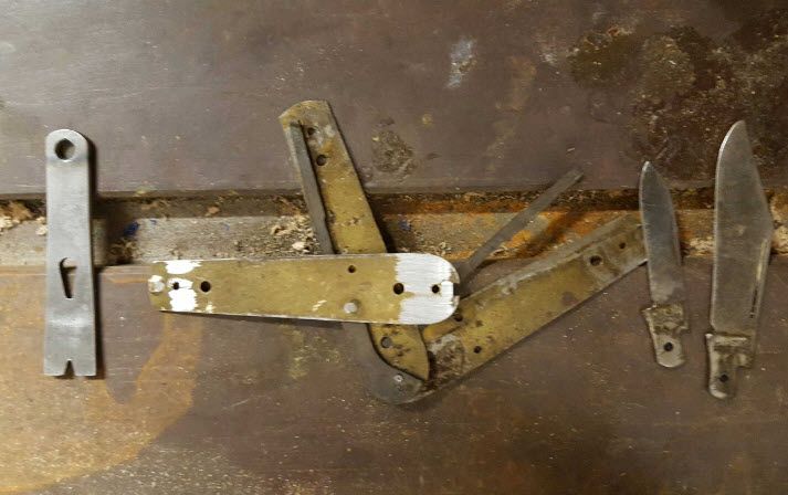

After the success of my little Old Timer mod (and the fact that I still have some brass rod and brown Micarta burning a hole in my workbench) I decided to restore it and see if I could make it usable again. I am going to make it a shadow pattern again, because I don't have the means to cut liners or bolsters right now. This presents a problem with the bolstered look that I want to preserve, but I have an idea on that - we'll see if it works in the next couple of days.

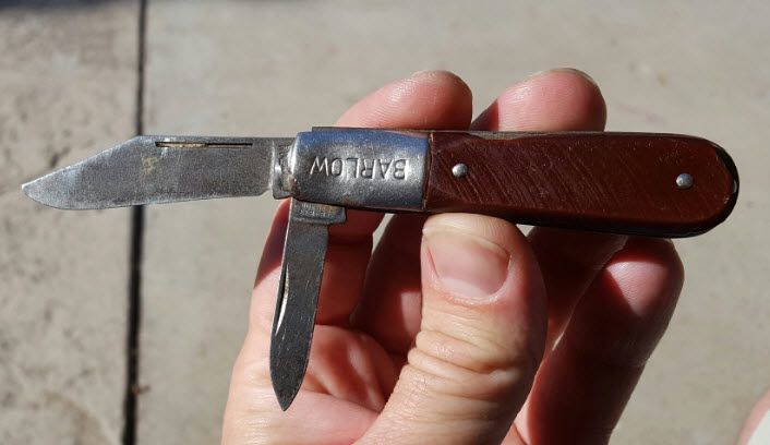

I used some pliers to open the blades up - here's a before shot
Down the spine - crushed bolsters and chipped covers
I used a screw driver to remove the shells - surprisingly solid knife underneath - I soaked it in WD40 for a while and flushed it out with soap and water and cleaned a mountain of gunk out. At this point, it's opening and closing without pliars and has some *very* surprising snap!

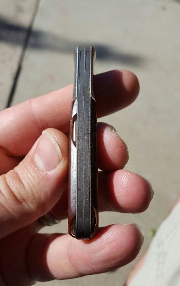

However, this could present a problem - see the back springs swerving off to the left? I think I know why the bolsters were crushed - looks like grandpa used it as a pry bar or door stop. Thanks grandpa!

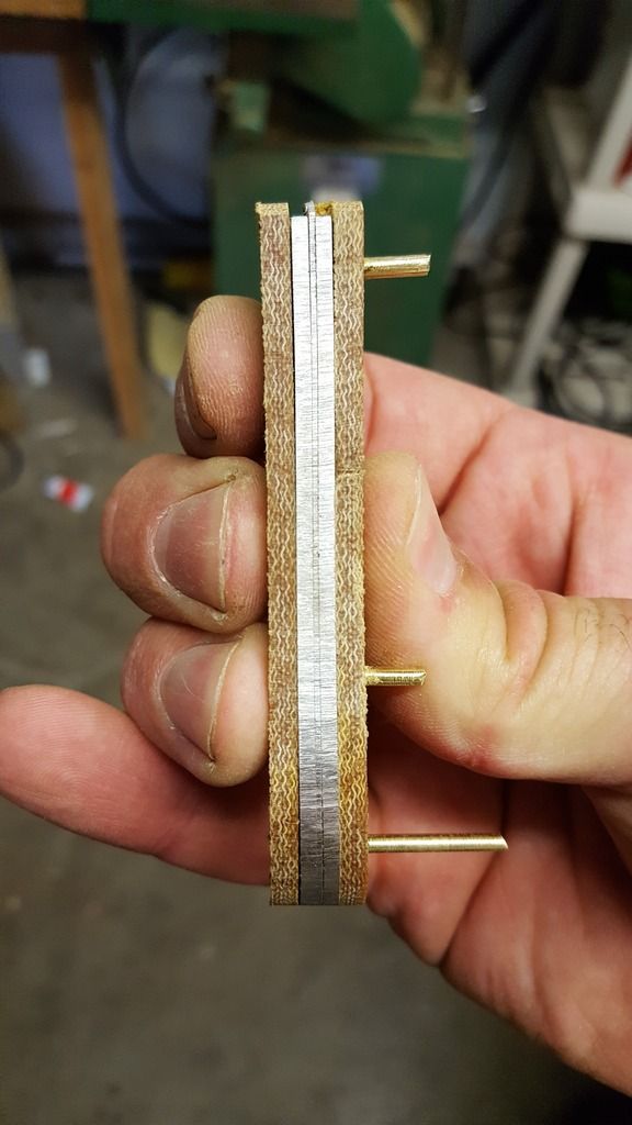

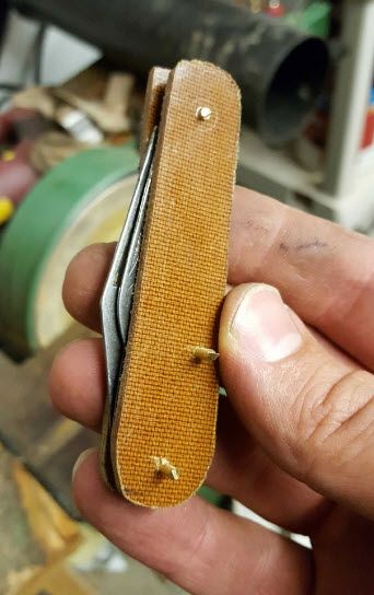

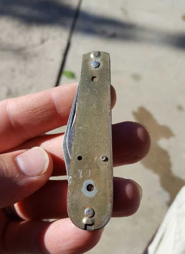

I ground the heads off the rivets for disassembly as I'm not planning to re-use the outer liners. I spent a while working on the back springs trying to get them straightened out without much success. My plan is to clamp the knife as I pin it and see if the tension of the center liner and scales can provide enough pressure to keep the back springs straight.

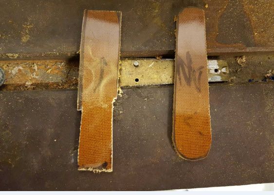

Here are the covers knocked out - the one on the left is as-chopped from my jigsaw, the one on the right has been rough-shaped on the disk sander
Finally, here's where I left off last night, holes drilled and roughly assembled. Putting it together was a bear with those bent backsprings! It's kind of unfortunate, too, that I will have to take it apart and put it back together because it took me a good 20 minutes to get it pinned up with the blades in. I'm debating on whether or not to clean the blades up - I'm leaning toward "no" because I like the Grandpa patina. I am also going to polish the cam on the tangs and the spot on the backspring where the tang rubs as there is some galling on both surfaces that really make the "walk" rough.

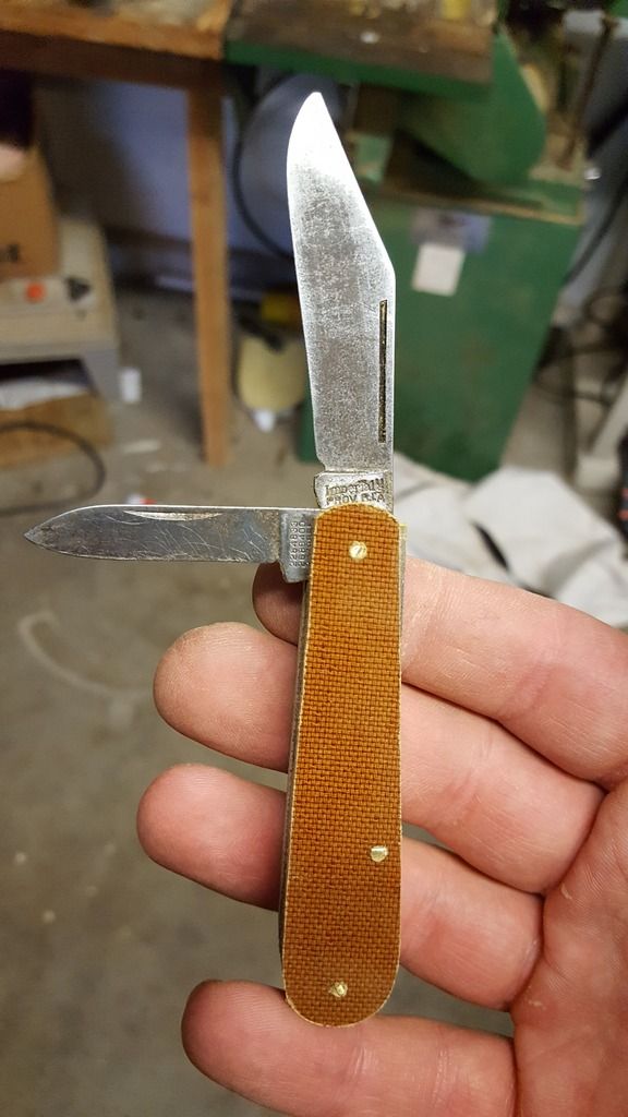

Thanks! Got a little bit more time to work on it tonight... got it stripped, cleaned, buffed where I wanted it buffed, and put back together. The backspring issue seems better:
Overall, it looks MUCH more like a knife peened and with the handles in their final shape

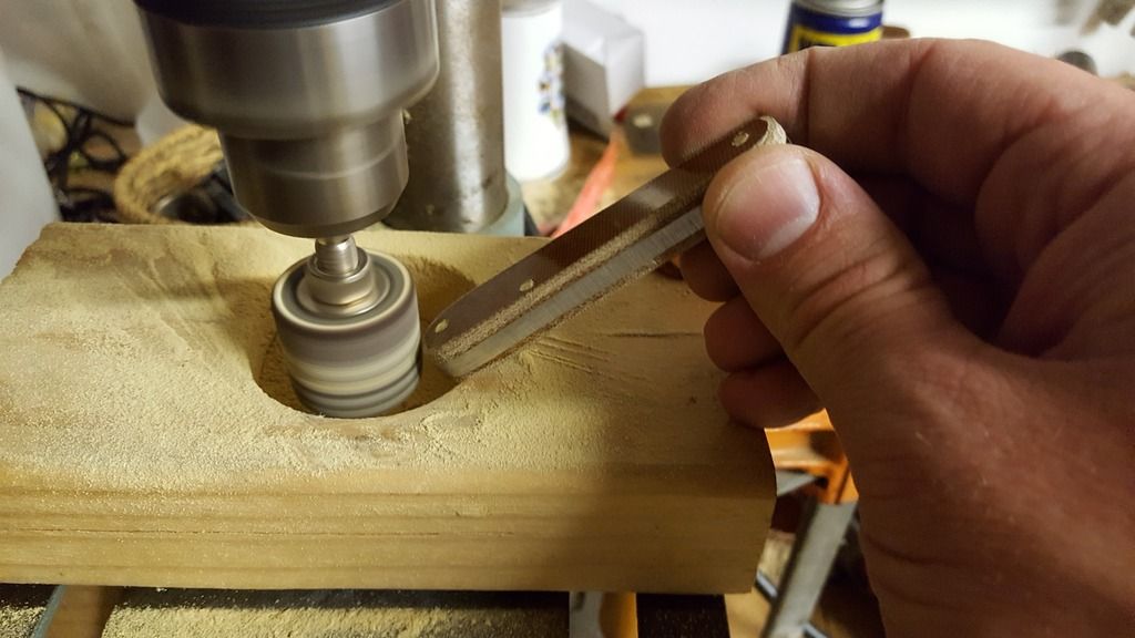

With the knife back together, I spent some time on my ultra high-tech hafting machine
Not the most dignified condition for the knife, I'm trying not to panic, but rounding all the edges on the drum sander saved a lot of time over hand-sanding all the edges
15 minutes of hand sanding with some 220 grit paper and a little shot of wd40 has me feeling much better :D

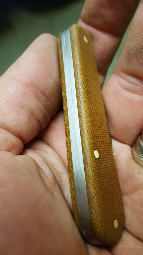

Really happy with how the backspring came out.... all the straight lines on this barlow make it easy to get a good finish:
Here it is in it's current condition.
I'm trying to decide about my bolster idea... I'm really pleased with the knife as-is, but you know the old saying... if it ain't broke, fix it til it is! I have a scrap piece of micarta that I'm going to use to experiment. If it comes out OK I will give it a shot tomorrow...
I wouldn't change a thing. Looks great!
Thanks gentlemen... the micarta experiment didn't work out as I'd hoped, so I decided to leave the knife as-is. I thought about it for a while and as I was over borrowing a router bit for a woodworking project from my dad, I handed it over to him... it just felt right giving it to him since it was his dad's. he seemed impressed, and yes, it did just disappear into his pocket!
