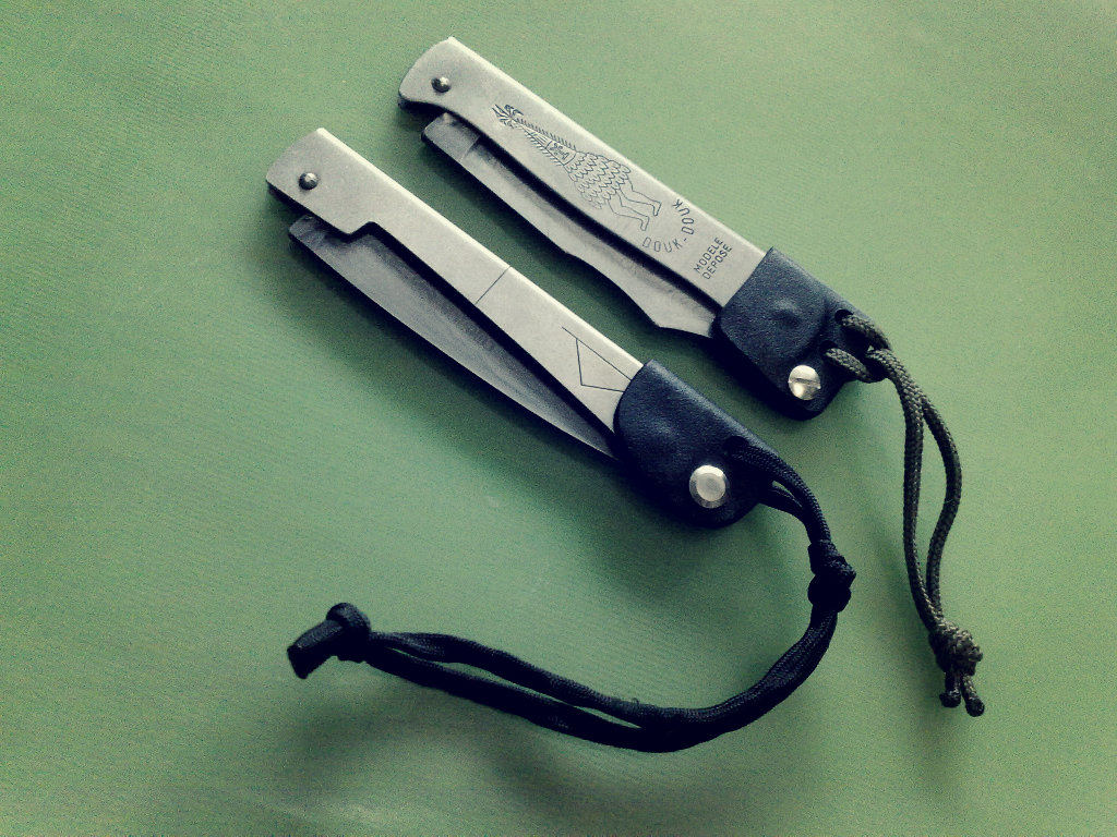

... Took me about an hour with the belt sander and 150 and 400 grit paper.... Hope you like the mod.
