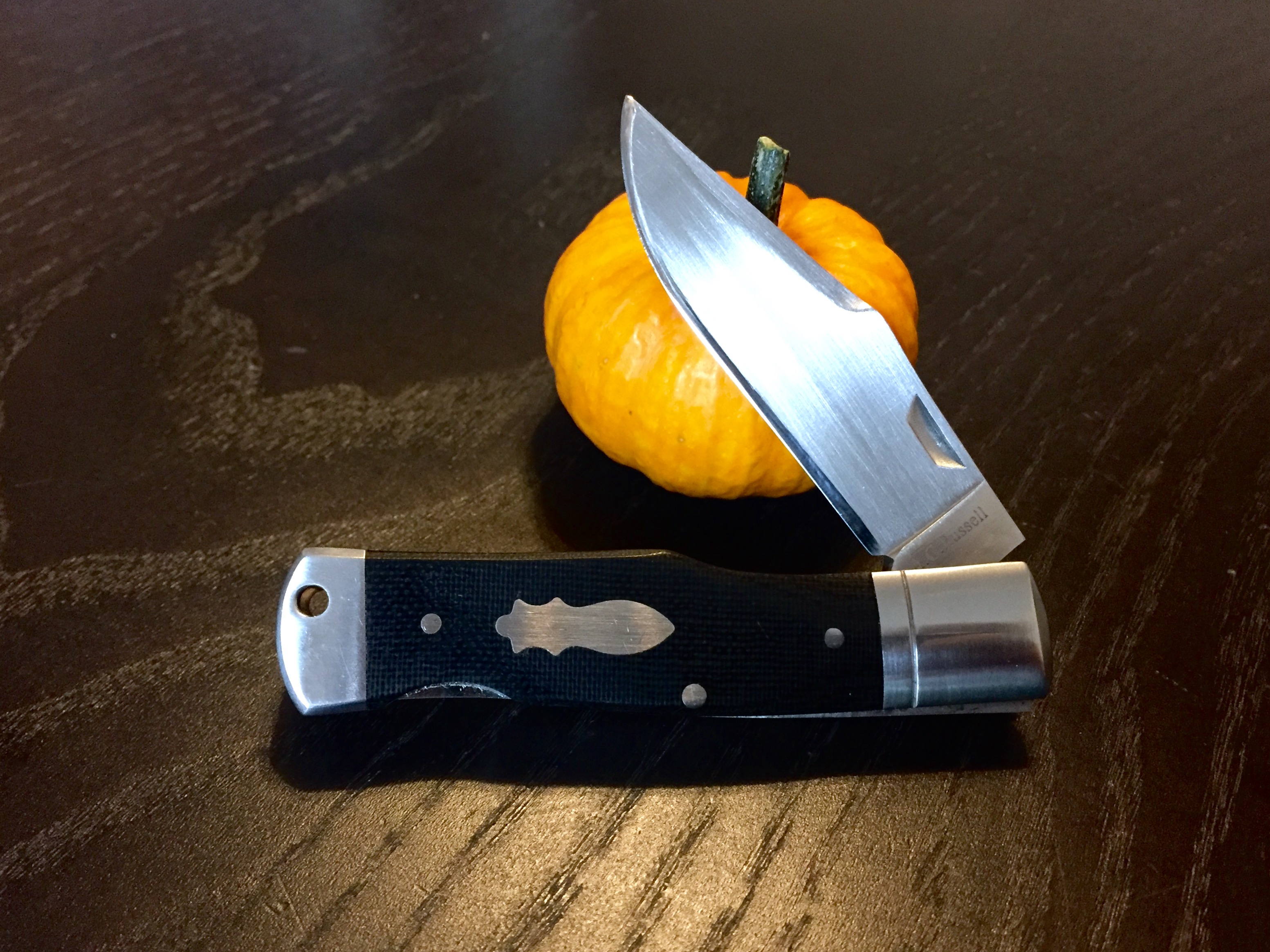

So far, my attempt in progress.
I found these nice little bar clamps and some ivory bone handles of an older knife.
Everything went quite well, till I hammered down the pins and the scales broke...:(
As bone seems to be quite difficult, my next attempt will be some wood.
I've got a little square-cut, but have to saw it in the right thickness. Still don't know how to do this..?

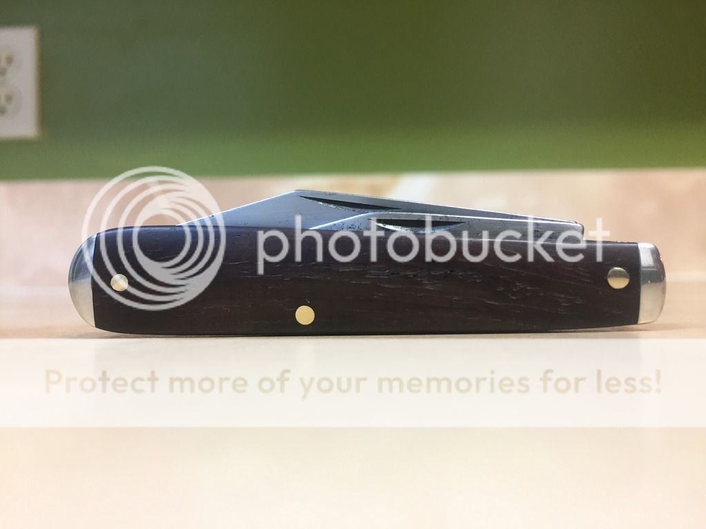

My meteoric decent into slippie tinkering has had a couple hiccups recently. I was using a vintage Kutmaster tl-29 to disassemble and rescale as a single blade, and noticed the blade was slightly bent toward the pile side liner. I tried to gently correct it with a vise and slight pressure...snap!
Crap! Looking at the break, my father said the grain looked very rough, indicating poor heat treat and soft steel.
Having a perfectly good liners with scales glued and sanded, and a polished spring, I decided to find a replacement blade. The bay luckily has reasonably priced duplicate availability. A few days later, I was ready to start where I left off. But, the blade was bent exactly like the previous. Stupid me thought, "maybe I'll try to be MORE gentle." SNAP!
I'm done with Utica until I find some info on a way to date them and find a better "era" of knife. Camillus hasn't let me down yet and they are plentiful.
Your father is incorrect. It is not "soft steel". It is "hardened steel". It breaks easier than it bends. If it were soft, you could have bent it back.
Derrman, the only place they're a bit softer is roughly an eight inch or so above the tang shoulder. That's about the only place it'll bend if the tang is anealed. If the blade's not touching the liner I'd just leave it alone. These knives weren't made to be a perfect fit, they're utility knives at heart.

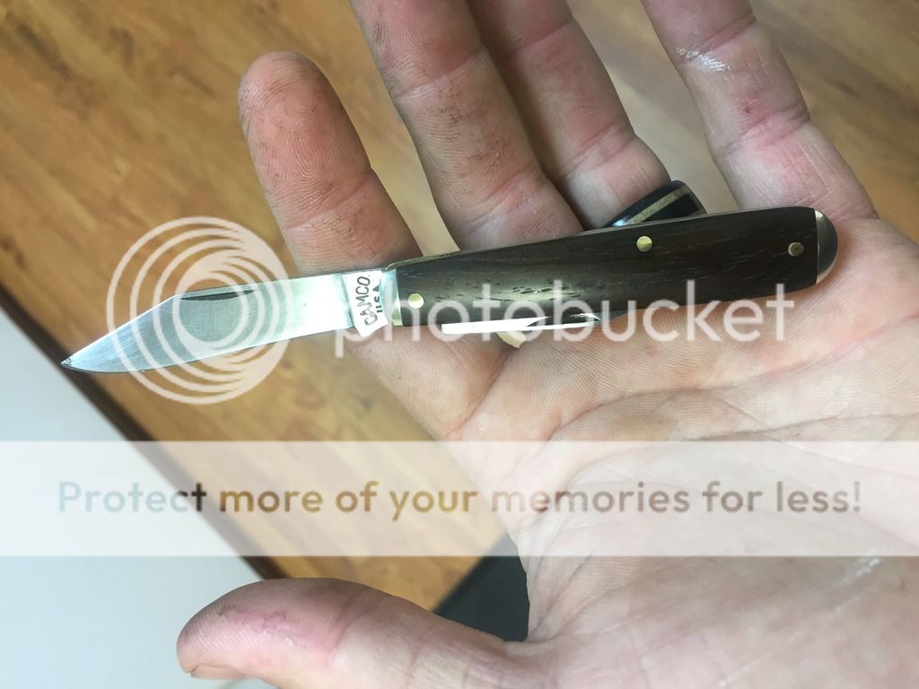

That is the first knife completed at my own shop. Before I've used my dad's tools and machinery. After a new HF belt sander and lots of hand sanding, a proud accomplishment.

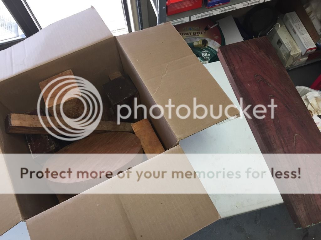

It's been a little while since I participated in this thread. I finally found a "cheap" cap lifter jack on eBay and it showed up in the mail yesterday. It's an old Camco with celluloid scales and legit baby bolsters. I've get her disassembled already and now I just need to figure out what kind of covers to put on it. One of my buddies gave me a box of exotic woods today that I wasn't expecting so my choices just got complicated. I'm thinking about cocobolo but I'll have to look through the box some more and pick something out
I figured out what was going on with my Photobucket. So here are the pics I was trying to upload last night.
Here is the cap lifted jack before disassembly:
And here is the box of wood I had to pick through to find something I liked:
