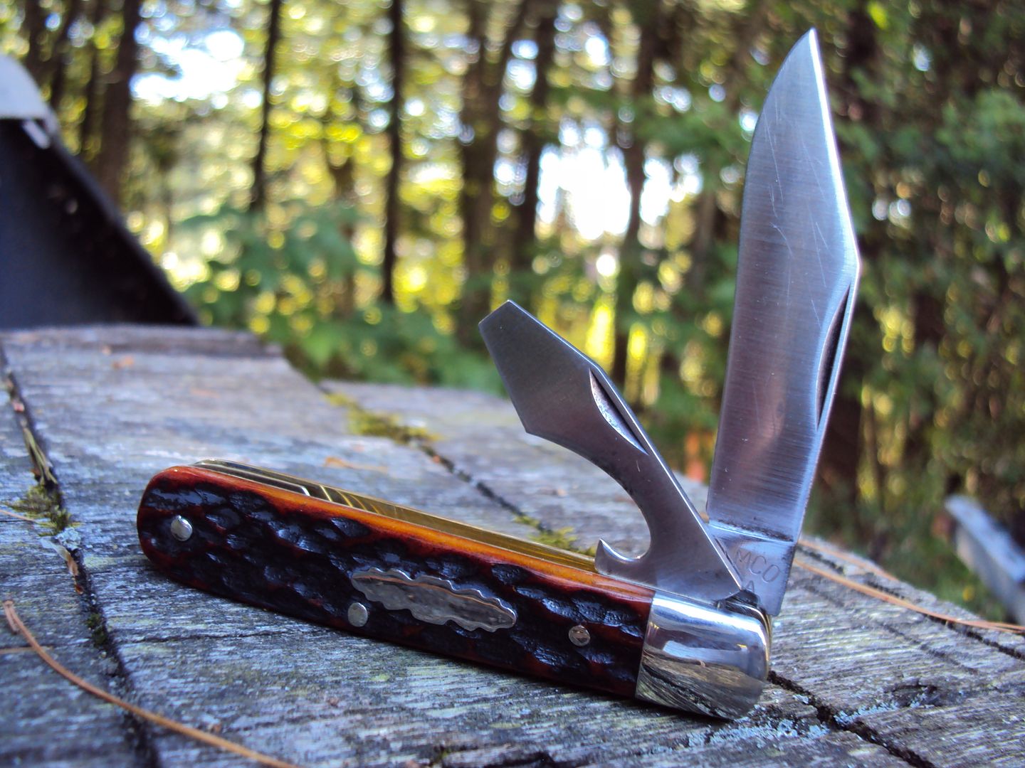

Glennbad, as requested, here is the finished product. I'm trying to remember if it was you or not but I've seen one of these little cap lifter jacks with bolsters added and stag covers. If it was you, I'd love to see a picture of it. I've been looking through old threads trying to find a picture without success

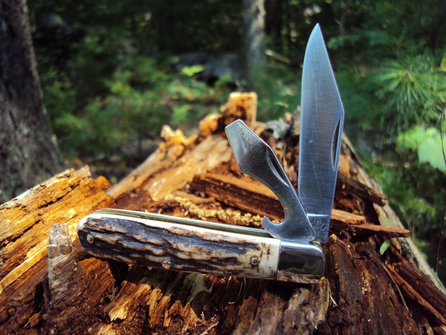

Sorry I did not reply sooner. I've been pretty sick the past few weeks, and haven't felt up to doing much more than scrolling through some threads lately. Here are a few that I have done.
Wow Glenn, those are BAD! That last one with the stag covers is the one I was thinking about. That's awesome. I need to get some nickel silver stock and step this up a notch 😜

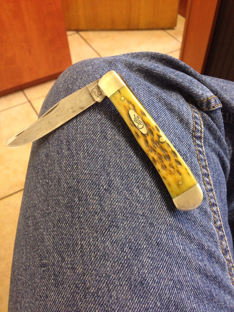

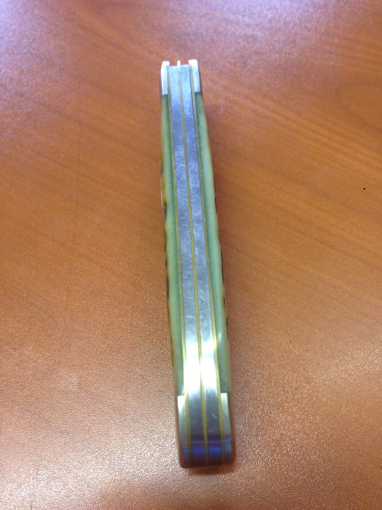

Recently had my Case double bladed trapper fall and it took some chips out the edges of the amber bone. Took it to my grinder and rounded all the corners off, domed the frame, reground the blades so that the main blade is a flat grind now and the spey is a thinner hollow, added half stops as well (can see that in the video) but they are not flush in the half position. I do not know how the inside of the blade-spring ration looks so did not want to push my luck. Did make everything flush in the closed position on the springs.
Photos below is after some pocket time of coarse and everything is scratched again as a well loved traditional should look like :D

That looks nice! I'm a sucker for the case trappers. It looks like it will just melt in your pocket now.

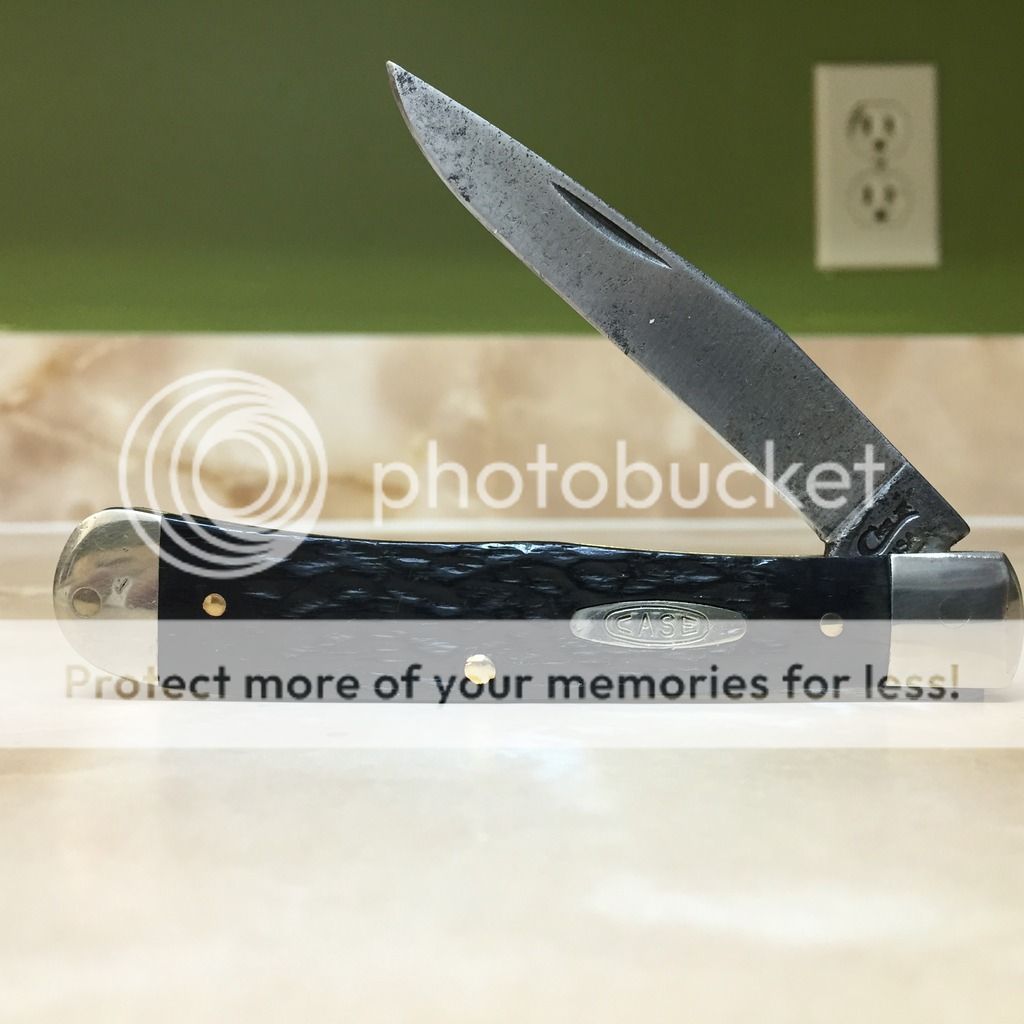

I rebuilt one a while back that was in rough shape. This is what it looked like when I got it
And this is the after. I removed the Spey blade and repaired the crack in the scale with some fiberglass resin. Then repinned the scales and gave it a dye job
Really impressive work on that well loved piece.

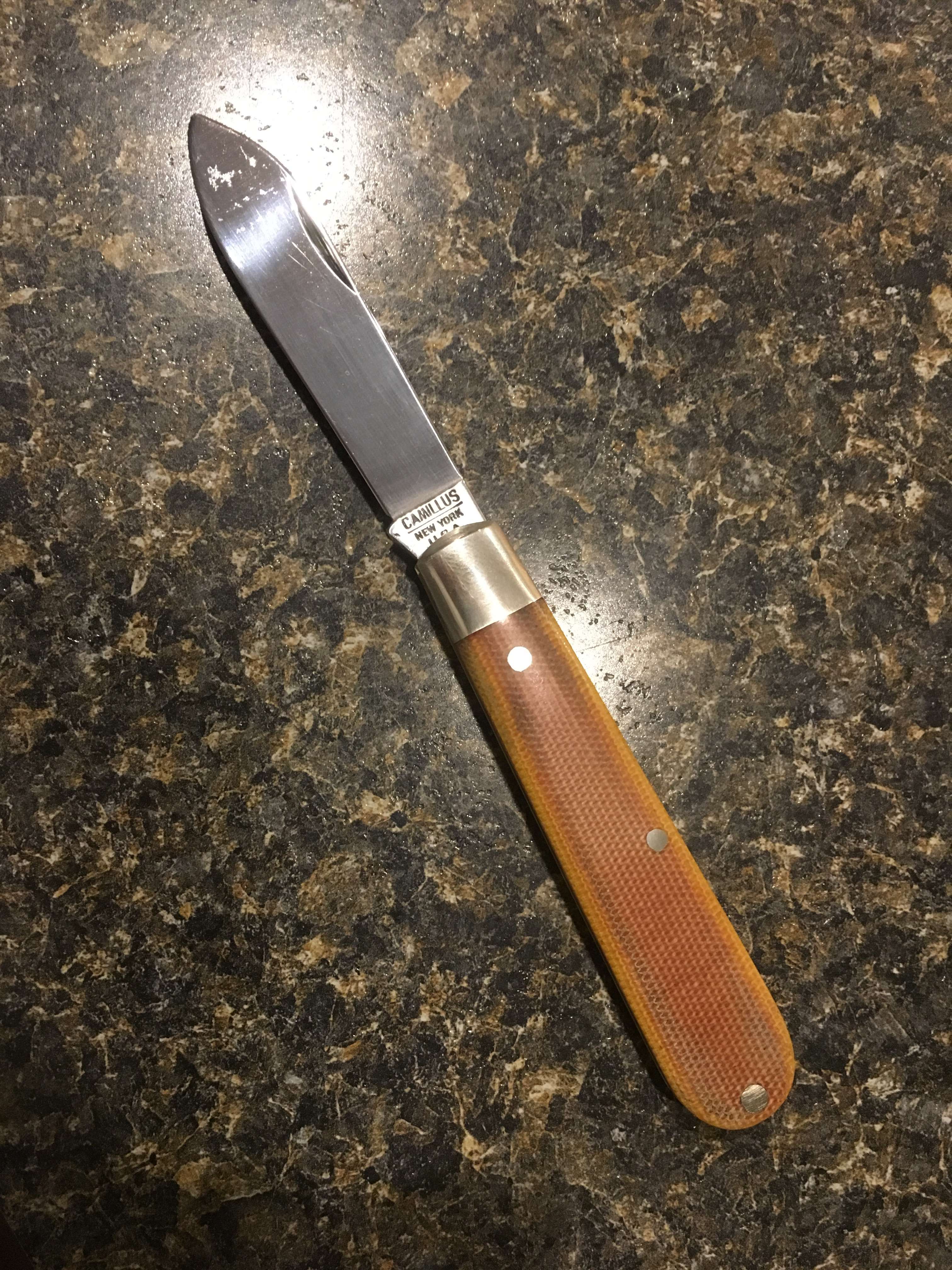

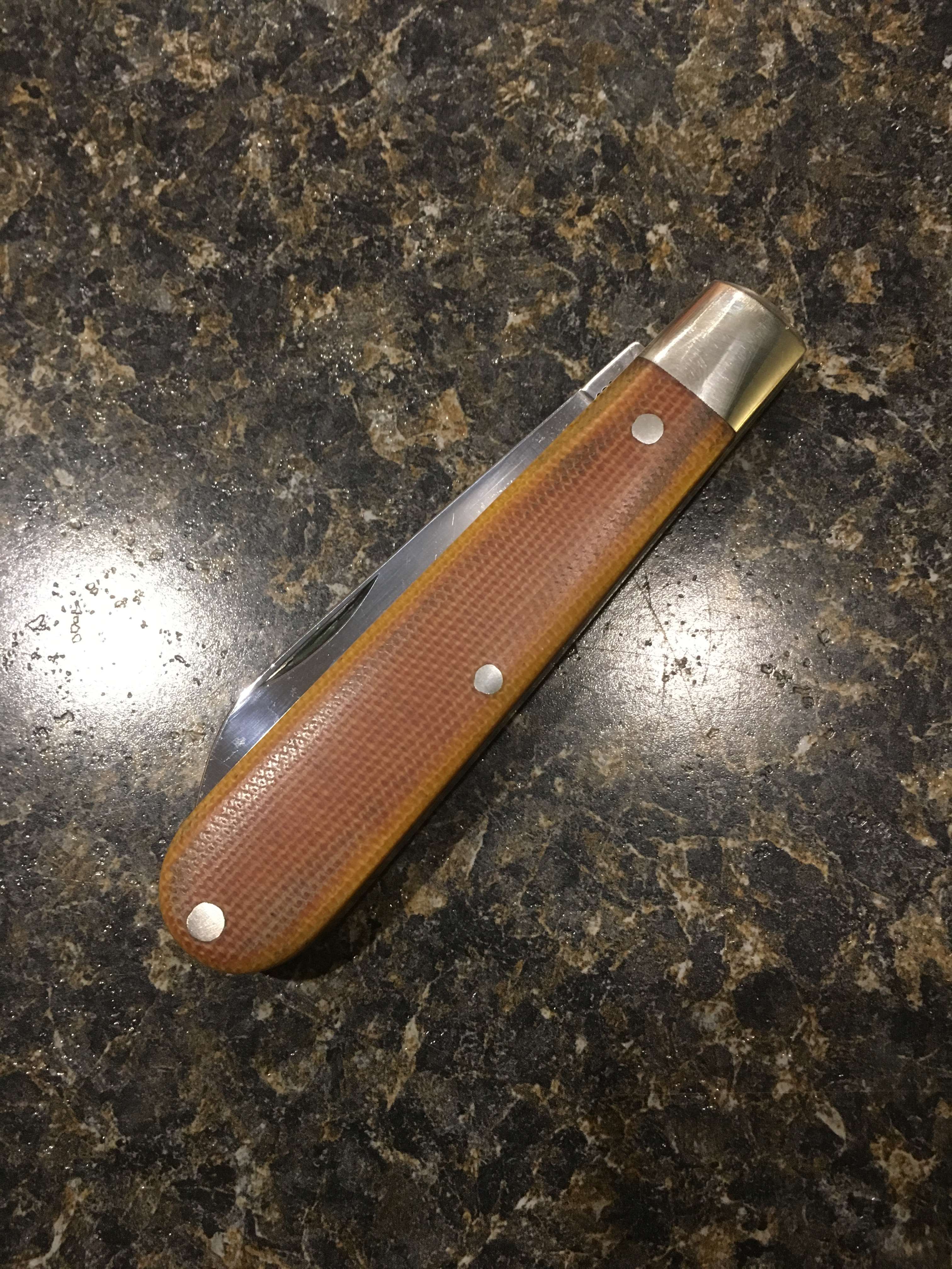

Thanks guys. Marthinus, OD canvas would be sweet. I was actually eyeballing some case trappers last night. I'd like to get one without so much wear on the blades to rebuild.
The natural micarta is tough to keep clean while buffing. Maybe some acetone will clean it up.
