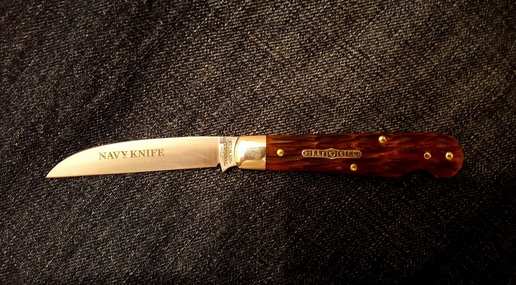

Here's a Navy knife I converted to a warncliffe.
OK, I'm going to try this tonight... couple questions if you have a minute...
How did you remove the bail? I'm hesitant to grind the head off the pin, because I imagine that will trash the bail, but if that's how you did it, I'll go for it.
Also, do you have a picture looking down the spine of the knife? Looks like it'll get awfully thin at the tip... just curious to see before I break out the files

HeathH,
I did grind the head off and like you said, I had to grind into the bail a little. You might be able to reuse it if you were more careful grinding, but you do have to hit it a little.
I will get a pic of how thin the tip is, and the bail, in the morning. It gets pretty thin up there, but seems consistant with most all other warncliffes that you see.

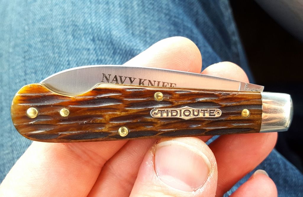

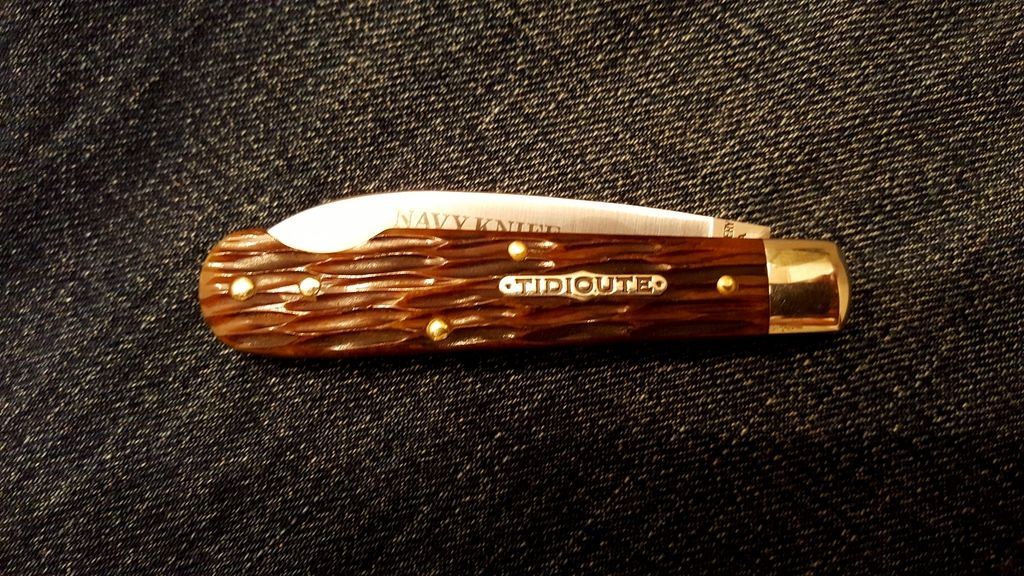

Nah, don't sweat it sir! The tip ended up plenty thick. Here's my Ramrodded Navy in poor lighting:
I think I'll leave the etch on for now, I kinda like it. I also did a subtle drawn swedge that came out better than expected. Thanks for the inspiration! I love it!!

Great job HeathH ! Looks perfect! Your swedge and pin look great! The swedge was the part I was most worried about.
Its hard to capture in a photo. I tried to get a shot of the bail too.
Mark

Thanks sir, the pin was definitely my biggest worry, I've never peened a pin on bone before, I was worried about cracking it but it came out ok, if not quite as nice as the machine spun pins that are on there from the factory
I'd never noticed this before either but the center of the "o" on the tidioute shield is the head of the pin holding it on, very clever touch from GEC
