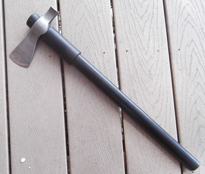

Stain. Or you flame blacken it and multiple coats of BLO. You can also put steel wool in vinegar and let it oxidize then use it as a stain.
Could someone have an idea for universally available agent for darkening the shaft? I have my hawk modding going and I'm not sure what to use.
Here is one I just finished with black wood stain. Minwax ebony. They look great in brown too.
Nice looking hawk! :thumbup:
I was thinking of leaving the paint in the deeper spots but I will sand the whole thing. I tried some patina yesterday but it looked bit unnatural with the paint.
This is painful project, I have only little spare time to pimp the hawk but the project is in my head all the time. :D

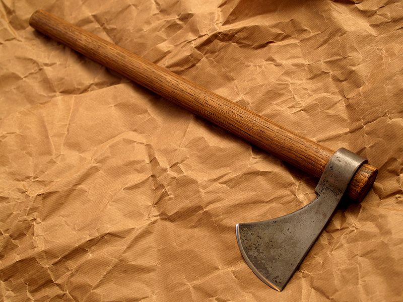

My contribution to the thread is a modified Rifleman's hawk.
Trimmed hammer poll
Trimmed beard
Shaved the hump off the top
Satin polished
Cold Blued
Properly fitted
Stained and BLO haft
