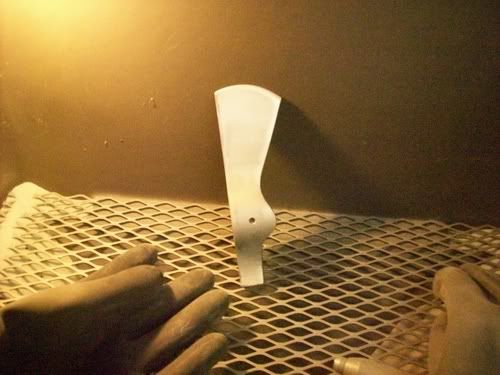

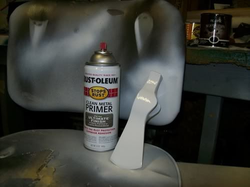

Once we have a good fit, its back to head prep. A sandblaster is by far the easiest way to do this. It also provides a great surface for paint to adhere to.
After the blasting, I give the head a good bath in water and soap. Then, hit it with a coat of primer.

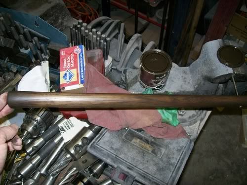

After the torch, I hand sand with 150grit, then work my way down to 400. Your hands are the best judge of when she is smooth. Also, run a soft cotton rag up and down, feel for the snags. If the cloth hangs, sand a tad more till the cloth will glide over without snagging.

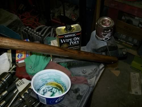

Now for the stain. My friend wanted a darker Hawk. This particular color is Black Cherry. I did 2 coats, and lightly sanded with 400grit after it dried.

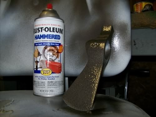

Head Paint. Some use powdercoat, some like parkerized, other like a natural look. Consider that nearly no coating will stand up forever. Once you use the hawk, its going to get worn. I went with Rustoleums Hammered in a dark bronze. 2 coats.
Back to the handle. I am using Minwax rub on poly. This stuff is pretty tough.2 coats, sanded with 400grt at the end.

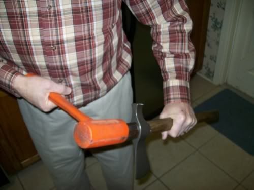

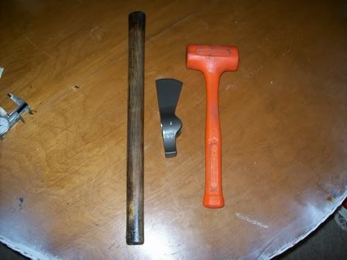

Now that we are all dried, and prepped, its time to install the head. This is the best method I have found, and if done correctly, makes for a HELL of a strong fit. I have yet to have one loosen up on me. First, we heat the head in an oven at 200deg for 20min. This will cause the eye of the head to expand, and allow it to go further up on the handle. We are using a 2lb deadblow.
Liberal disclaimer-Things tend to get hot when you put them in the oven, consider gloves for removal.
After the head has heated, we remove it from the oven, slide it down the head, take the handle if your weak hand with a modest grip. With several STRONG, and accurate blows, give the top of the handle a good rapping. This is my father going through the process so I can make the picture.

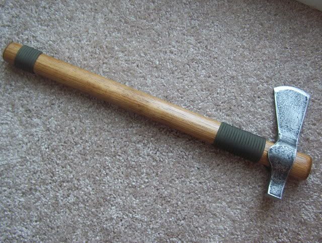

And here we are, all modded, wrapped up and ready for delivery and hard use. I originally did a small bit of wrapping below the head just because I thought it looked cool, but after using my hawks, it really does a good job of catching some missed strikes, and will save that nice handle from a premature death.

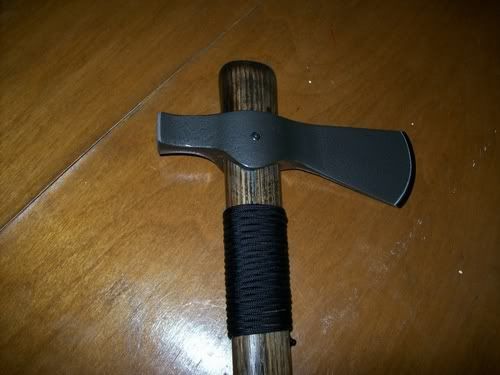

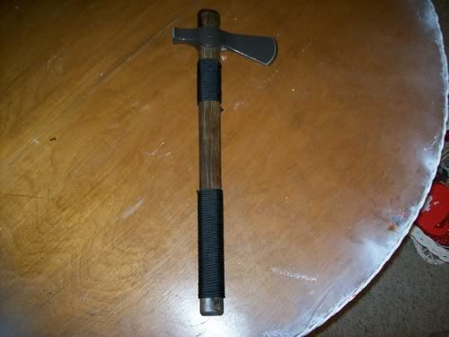

Finished my Trail hawk today
Sand Blasted then Cold Blued the head.....
Sanded the handle then Tru-oil and a coat of black shoe Polish.....then after I let the shoe polish dry for 6 hrs...I steel wooled all of it off to give the wood a burned/old dark oil color....
Gripped from bottom 85% of the Handle with Green 550 cord....

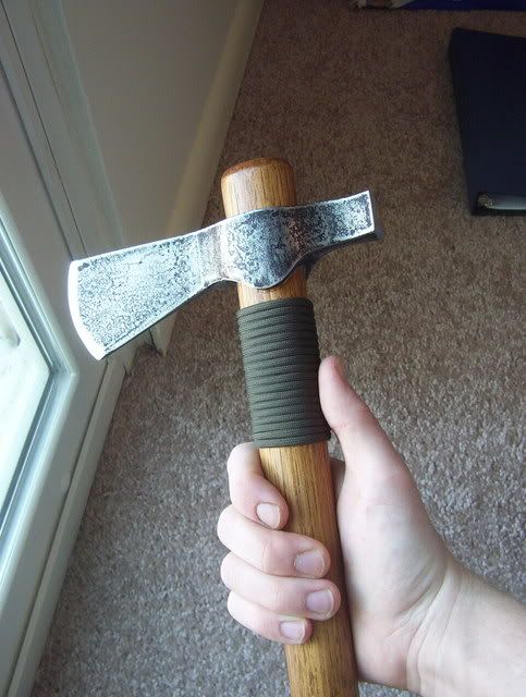

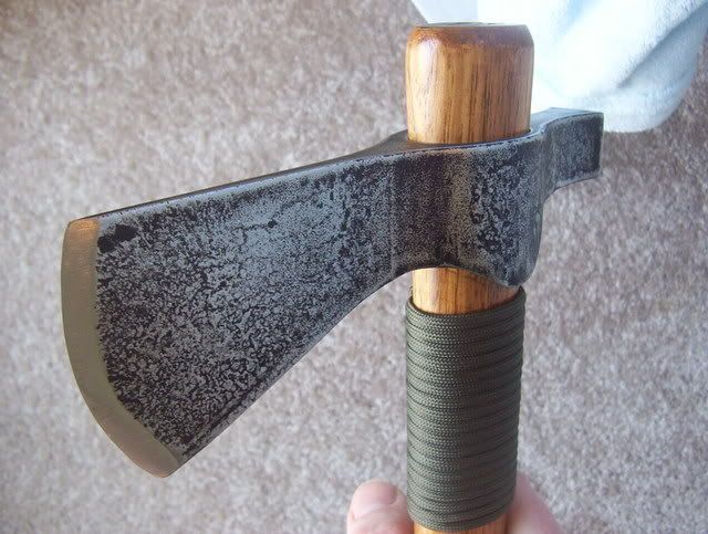

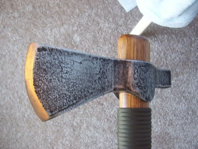

My First Modded Trail Hawk-
I say first because this was a lot of fun, and assuming it passes my tests once it hits the woods, I'll be getting a couple more of these to dress up!
There isn't too much about mine that's revolutionary, but the package fits me well and is very simplistic. On the head, I just slowly hand sanded until only specs of black were left in the cracks from the forging. I had originally intended to fully strip it, but it looks so cool and 'fresh from the forge' this way. I think it will still do a good job protecting from rust, since it's deep in the cracks, but of course it will still require a lot of care overall compared to any paint type finish.
I wasn't happy with the edge when I got the hawk, so one of the first things I did was sit down with a bastard mil file and a rigged-up jig to thin it out a lot. Looks like a scandi hawk now! But it will slice like none other and easily shaves me. It's got a slight convex edge to it (fine grit sandpaper on a mouse pad, plus cardboard strop). I don't believe that I've weakened the edge such that a throw or chop will damage it, and even if that happens I'll just take the edge back as far as any dings/dents and have a steeper angle for next time.
The haft was sanded heavily by hand, then three coats of walnut stain were applied. I put three coats of polyurethane on top of that, sanded between each application.
I did a simple paracord wrap at the top and bottom. I wanted a top one to protect from bad strikes and the bottom is pretty much for 'looks' and aesthetic balance. I applied some hairspray on the haft before and after the wrap to help keep them in place a little more securely. I tried doing a 'full' wrap at first, at both the top and across the bulk of the handle, but I didn't like how much fatter the grip was after that (odd, because usually my first complaint about a knife is an overly tiny handle!).
Overall, I like how it has turned out and how it handles right now. I've done some very light chopping around the apartment and a lot of choking up + slicing, and it's performed quite well. The main competition for this is my Fiskars, which makes for big shoes to fill! When I get a chance to take this out (hopefully this week) I will report back on how well I feel it fares in the woods.
Thanks for looking! :thumbup:
