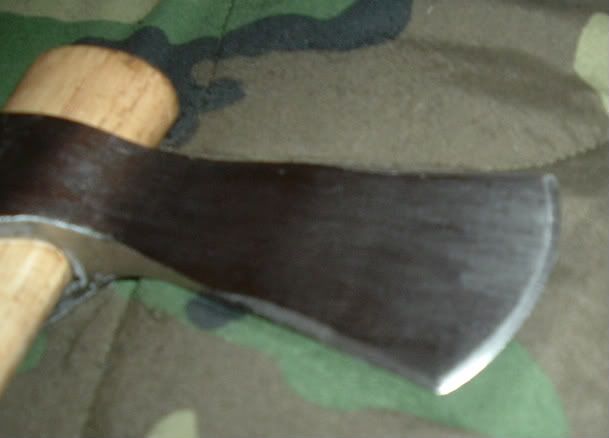

A rough pic of my first mod ,I will try better pics when my batteries recharge.
I went for what I thought would be an authentic look. I was suprised at despite how light the axe head is , how great it chops , I would not like to fight someone axe to axe like in the old days :eek: , lol...
Fascinating how they used this style of axe in combat.

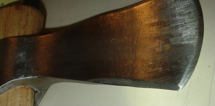

Head, paint removed , simple filework , blued/steel wool/blued/steel wool/blued/steel wool/oiled to cure , edge polished and sharpened - will roughly cut newsprint.
Handle sanded , stained , sanded , lightened ( color wise ) , burned , edit- , I forgot that I took sanded the sealer back off because I thought it looked too shiny , so I went for several soaks in orange oil and beeswax as a sealer , for a more natural look.
Old leather pistol belt for grip , set with pins and Gorilla Glue , lanyard hole/brass tube , leather lanyard.

Re-did pics , close up of head and handle , these pics turned out much better. :D
feel free to comment , like it love it hate it ? lemme know ! :D

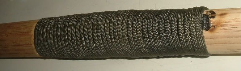

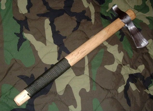

One of the key things I wanted to do was a cord wrap, but without dramatically increasing the size of the handle. To this end, I reduced the diameter of the handle under the wrap and gave it a slightly more ergonomic profile. Feels nice. The cord was applied wet as TIGHT as I could wrap it, and the ends were melted into the holes drilled in the handle. Will probably do a separate hole and piece of paracord for a lanyard.
The wood is sealed with some Minwax polyurethane stain/varnish combo stuff I had left over from a furniture project.
As I wanted this to be something of an all-purpose 'hawk, I elected to sharpen an inch or so of both the top and bottom edges to give them a bit more "bite" in a fight, so-to-speak. The sharpened lower surface for "hooking" and the top surface to either give it some cut-on-the-thrust capability, or to enable me to choke up on the head and use it more like a knife. This is all mostly theory on my part, but I hope to get a chance to play with it sometime soon.
The head was deburred and smoothed internally with a sanding drum on a Dremil, then stripped down to the white with the same little drums. Then, after the handle was finished, the head went in the oven at 200 deg. f for awhile and the handle went in the freezer. While still hot, the head was pounded into place on the taper of the handle using a block of wood, then allowed to cool, after which a quantity of thin cyanoacrylate glue was "flowed" into whatever gaps remained between the handle and the head. That ought to hold her awhile. :-)
The head remains in the white...got a little out of sequence from what I had originally planned. Might go back and finish it with Oxpho-Blue (if I can find that bottle I bought a few years a go) or some Alumahyde II (ditto). Am open to other, more rustic suggestions for finishing it as well.
I am pretty happy with it so far. looking at getting a Norse Hawk or something to butcher on next. :-)
