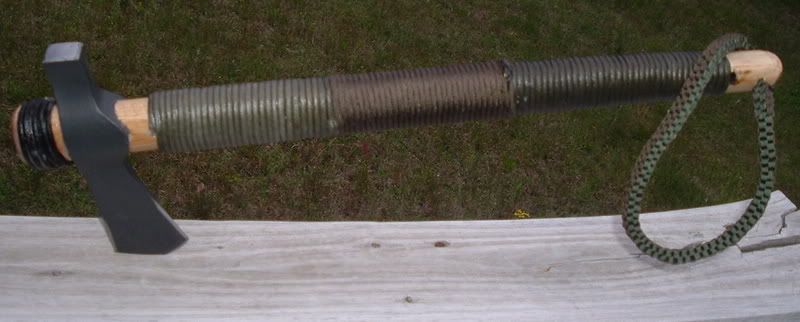

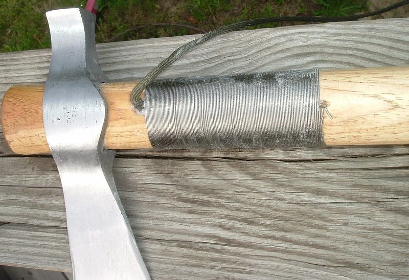

I have taking a liking to brushing on Cyanoacrylate glue after applying the cord wrap. I really like the way this feels in the hand!
In an attempt to harden the hadle against breakage under severe use, I thought I might try wrapping the handle tightly in tempered stainless steel wire (which I paid too much for from the craft store :rolleyes: ), then gluing it all down with a mix of baking powder and CA.
I then wrapped over the stainless wire with more paracord, and then soaked it down with CA as well.
Where we are at now. Next: a woven paracord lanyard of some sort.

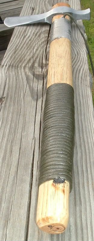

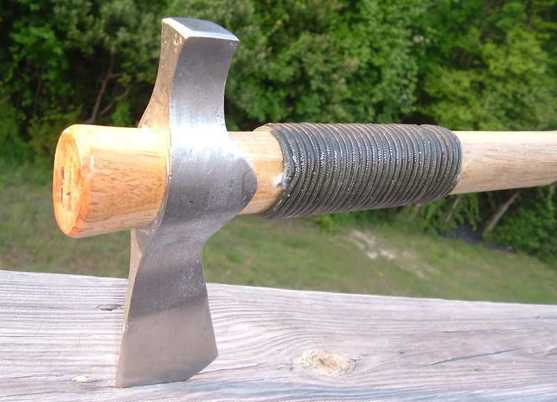

...in progress.
One of the key things I wanted to do was a cord wrap, but without dramatically increasing the size of the handle. To this end, I reduced the diameter of the handle under the wrap and gave it a slightly more ergonomic profile. Feels nice. The cord was applied wet as TIGHT as I could wrap it, and the ends were melted into the holes drilled in the handle. Will probably do a "separate hole and piece of paracord for a lanyard.
The wood is sealed with some Minwax polyurethane stain/varnish combo stuff I had left over from a furniture project.
As I wanted this to be something of an all-purpose 'hawk, I elected to sharpen an inch or so of both the top and bottom edges to give them a bit more "bite" in a fight, so-to-speak. The sharpened lower surface for "hooking" and the top surface to either give it some cut-on-the-thrust capability, or to enable me to choke up on the head and use it more like a knife. This is all mostly theory on my part, but I hope to get a chance to play with it sometime soon.
The head was deburred and smoothed internally with a sanding drum on a Dremil, then stripped down to the white with the same little drums. Then, after the handle was finished, the head went in the oven at 200 deg. f for awhile and the handle went in the freezer. While still hot, the head was pounded into place on the taper of the handle using a block of wood, then allowed to cool, after which a quantity of thin cyanoacrylate glue was "flowed" into whatever gaps remained between the handle and the head. That ought to hold her awhile. :-)
The head remains in the white...got a little out of sequence from what I had originally planned. Might go back and finish it with Oxpho-Blue (if I can find that bottle I bought a few years a go) or some Alumahyde II (ditto). Am open to other, more rustic suggestions for finishing it as well.

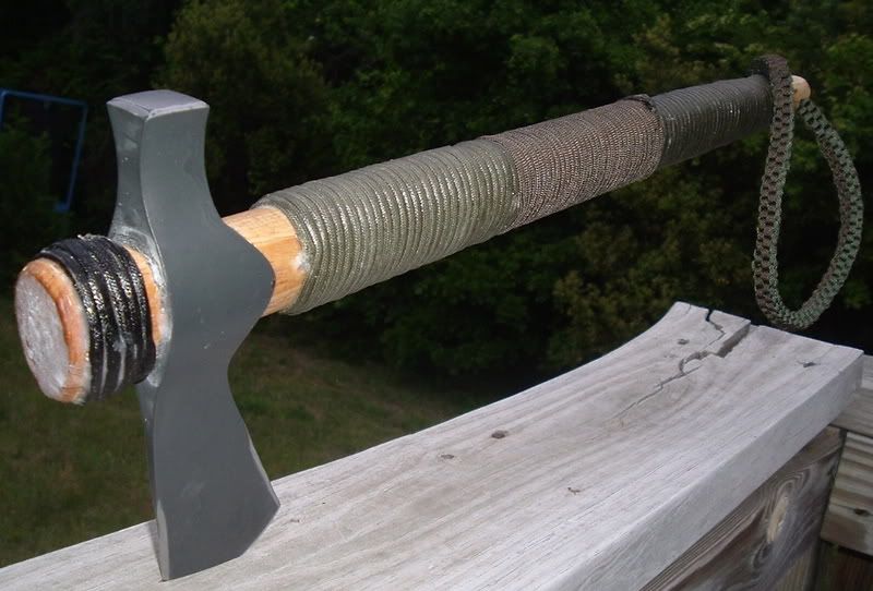

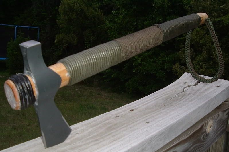

Okay, here is the semi-finished product:
I ended up spraying the head down with (dark) OD Brownells Alumahyde II, the toughest nonbaking, one-part paint I have ever played with. Takes a few days (at least) to set up, but it makes for a pretty tough finish, the best I have found this side of powdercoat, in any event.
I added some more wire and paracord wrap near the top, soaked it all down with CA glue and baking soda. Seems to have sealed things up nicely. While the OD paracord just under the head and at the grip are saturated with CA and are unlikely to go anywhere anytime soon, I figured that it might be nice to have some "useable paracord in the mix, so the coyote brown wrap in the middle is just tacked down with CA at the ends but is otherwise removeable.

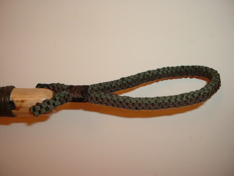

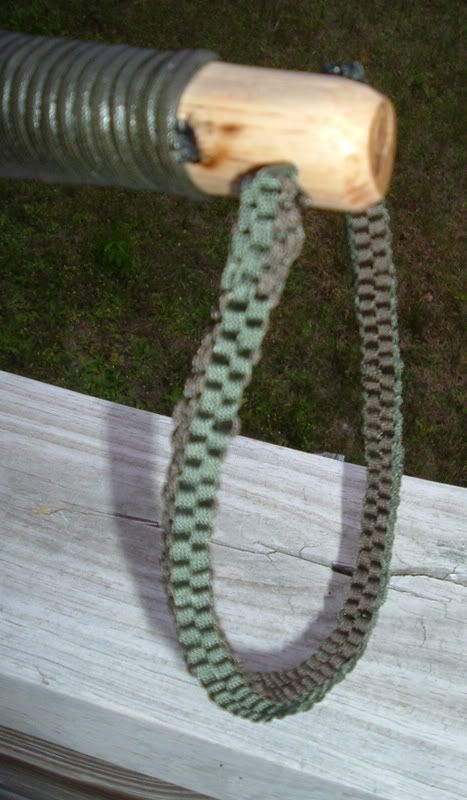

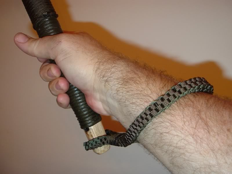

The lanyard is square-braided out of OD and CB paracord (gutted). Might be a bit long at this point, but it is easier to cut than to stretch. :)
Overall, I'm pretty happy with it! Have some brush removal to do tommorw so looks like I will get in a little field testing. Wish me luck. :)
I found the loop to be a bit large, but instead of cutting it, I decided to tighten it up with a little wrap of gutted paracord and a dab of CA to make sure it stays in place. I gotta' tell you, this lanyard feels as nice as it looks. :):thumbup: The lanyard ends up having a "springiness" that makes it cling close to the hand, but still be easy to get into and out of.
