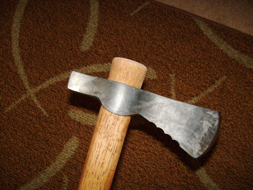

I´ve got a CS Trail Hawk a few months back and I havent got around doing anything with it exept stripping the paint of it. Then the outher day i had a few moments of spare time so here is my innitial work. I´m thinking of trying to darken the head with either mustard och lemonacid. Any tips on this? Opinions?
I soak my hawk heads in apple cider vinegar for 48 hours. It works great and really gives the head a dark patina. BTW, I have a friend who sandblasts the paint off the heads for me. :)
Lookin Good.................
Just a tip for paint removal. To shorten time and get it done with one application almost every time. Put the paint stripper on and then wrap the said item to be stripped in saran wrap very well. This will keep the paint stripper from drying out and allow it to work for a much longer period. I usually leave items in for 30 min and when done the paint just falls off.

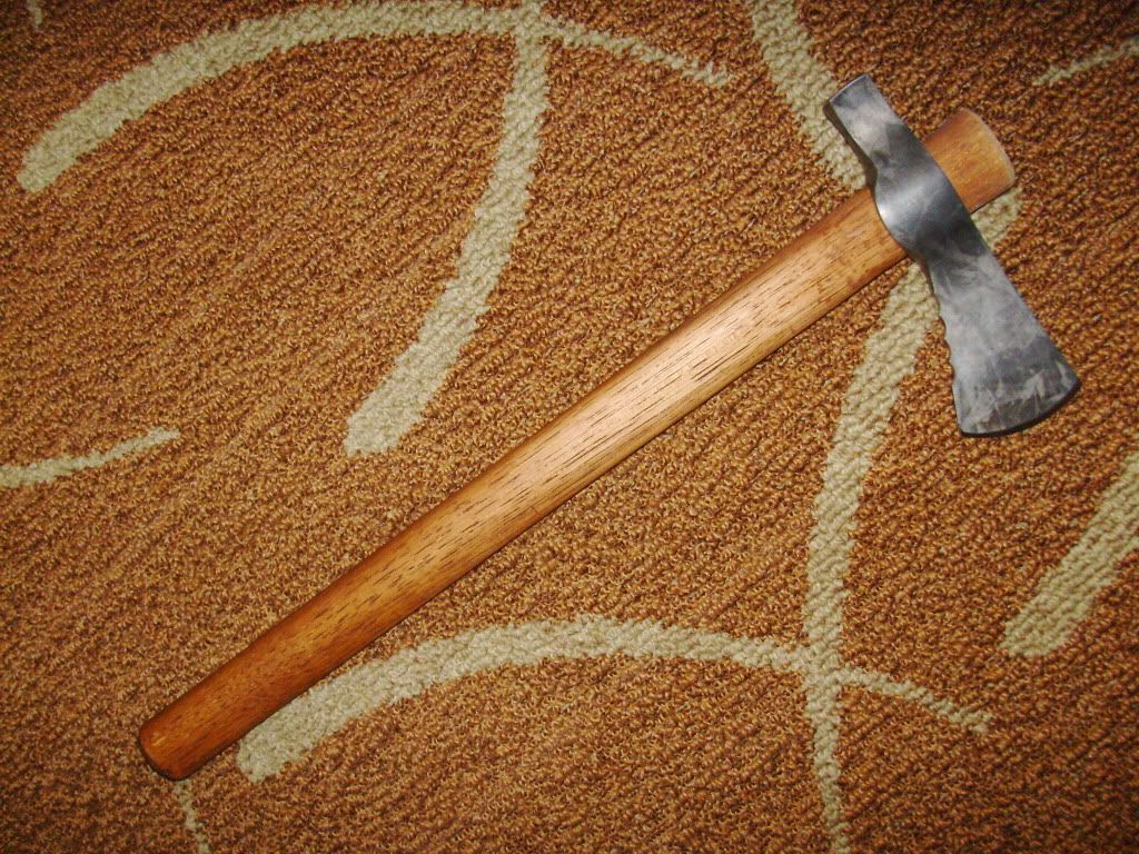

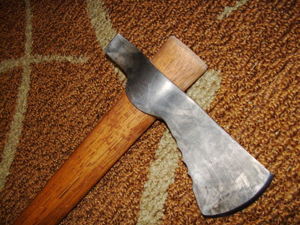

My hawk I bought a few years ago. Second time modding it.

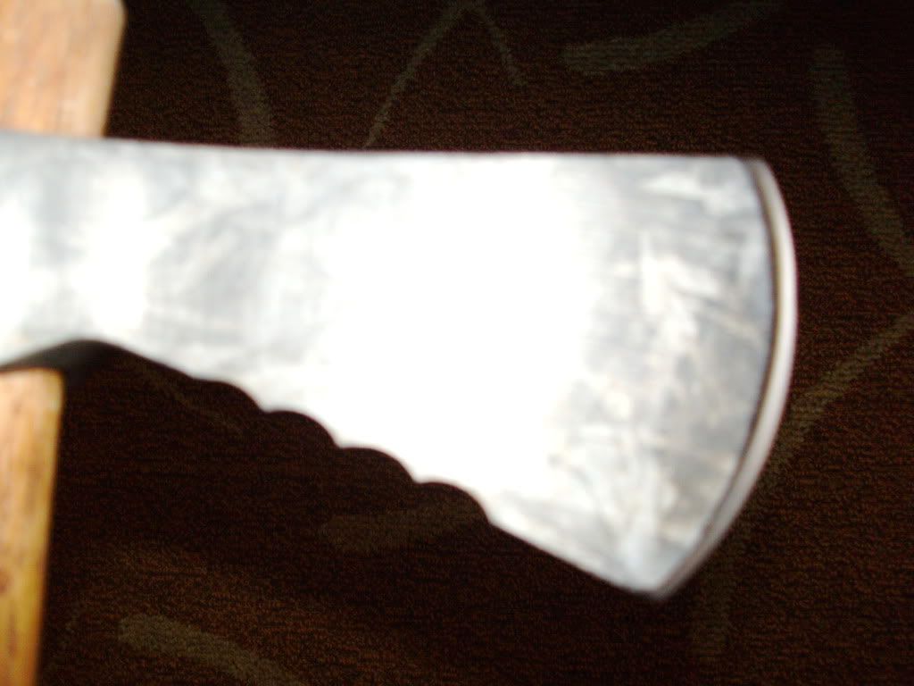

Stained the handle, did some cosmetic work to the head and added a patina. Then put a convex edge to it. It needs something else... just don't know what. I did some P-cord wrapping to it but didn't like it or the feel.
No I'm likin' it too. You should have seen my Swamp Rats when I stripped them.:eek: They had machine gouges and pits all over the place.
DingoBubba...that is darn sweet what you did to the under-side of that CS tarilhawk head bro...what did you use to cut it...a file?
To quote a famous chopper, "I cannot tell a lie"... actually used a Dremel with grinding stone bit. Then finished with a sanding bit. Didn't take long at all. Cooled it every so often with water. Think I'm going to get some tiny files tho and do a more decorative pattern to the upper part. Was fun to do. Think I'm gonna need some more hawks now.
