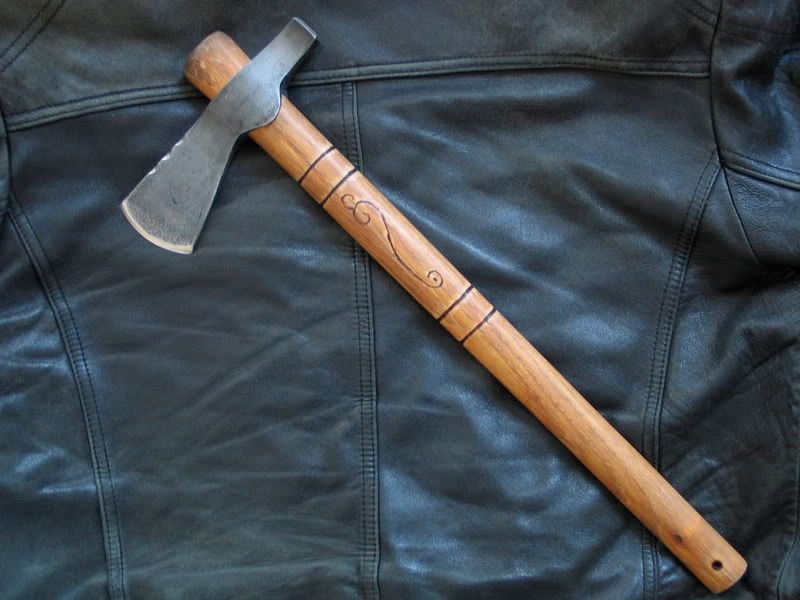

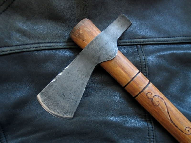

Here are a few shots of my first Trail Hawk mod job. This ‘hawk is destined to become a regular companion on weekend hikes and overnighters.
Started off by sanding the handle with progressively finer grits, working down to a fine steel wool finish, wetting the wood between grits to raise the grain.
Once the sanding was complete, I sketched the handle designs out using a pencil, then followed up with a file. After this, I went over the filed area with my wood burning tool. I also added some scrollwork on both sides, just for kicks. The handle was then given ten coats of Lee Valley Tried & True Danish oil. I was tempted to apply a darker stain, but the contrast between the detailing and the natural wood looked pretty neat as-is. I’ll stain the next one!
For the head, I began by stripping away the existing coating. At Magnussen’s suggestion, I opted to convex the blade with a slack belt. It needed reprofiling anyway, as it arrived with an uneven grind and a miniscule micro-bevel. Once the detail work and sanding was done, I cleaned it up with acetone and dropped the whole head in a pot of boiling white vinegar to force a patina. After this, I decided to go back and add a bit of file work. I’ll need to redo the patina at some point, just to make things uniform.
The last step was to hammer the head onto the handle and tighten the set screw. Eventually, I will wrap the grip area in leather.
Et voila, the finished product!
Definitely the first of many.

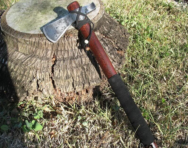

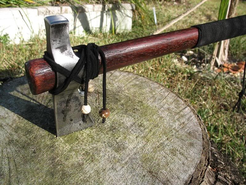

My first attempt at a Trailhawk mod :P
- hand sanded hawk head
- red mahogany stained handle and polyurethane coat
- suede thong wrapped handle and dangly bits
thanks to everyone in this thread for the inspiration!
