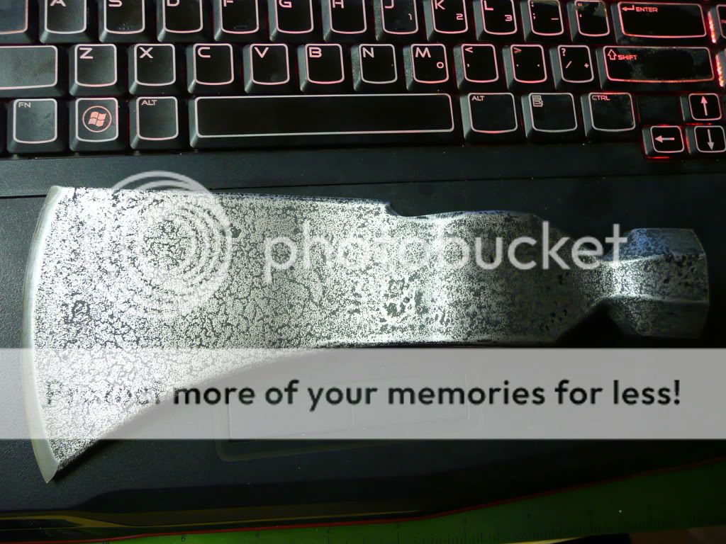

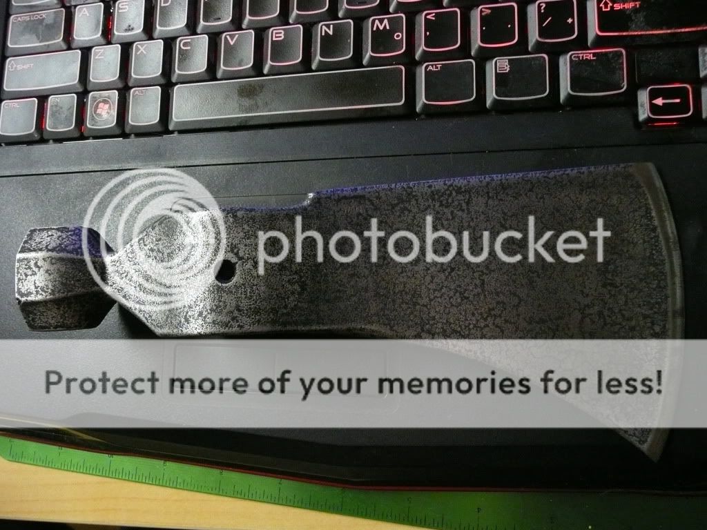

Here's what I got so far

Azn: Nice start on that Riflemans and is that an Alienware I spy in the background?
ioelus: I used a regular soldering iron, too. Slow but it works. Considered buying one with higher power but I don't do it enoug to justify. Even if dremel is unsteady, the burning part evens out the marks.
Thanks!
Sanding the head was much harder and took much longer than I anticipated
And you are correct, that is indeed and alienware laptop in the background
Nice! simple, traditional and beautiful, and I like the stain on the handle. Did you take off all the black paint by sanding? :eek: I would recommend using a liquid paint stripper if you do any more of this.... saved me a lot of labor :thumbup:
I did take it all off by sanding because I didn't want to take the paint out of the pits and such
Perhaps if I just use a little stripper it would have sped up the process...
:P
