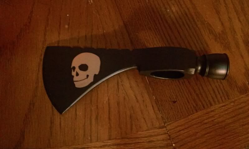

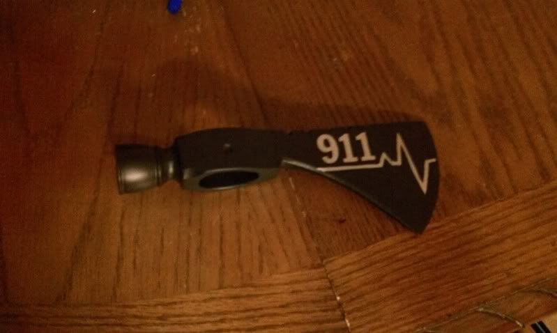

Hawk #3 (CS Pipehawk) ready for etching tomorrow:

That skull is awesome! I like it. Are you an EMT? Just guessing by the Dfib nickname and pqrs wave lol. No t wave :D.
Yeah, 14ish years as a paramedic. I'll have to tell the people that ask the patient was hypokalemic, hence no t wave.

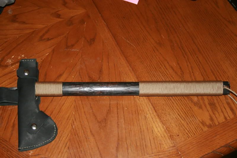

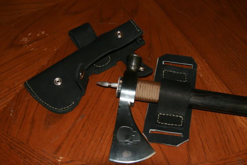

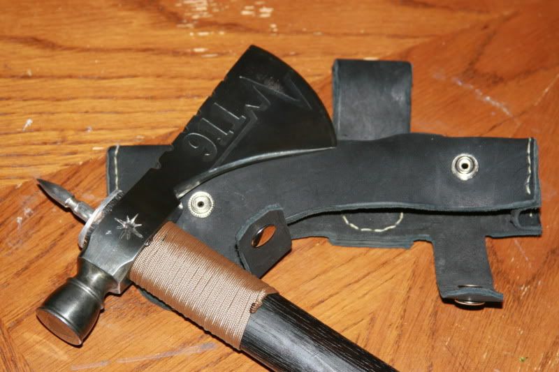

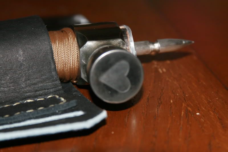

Here's some pics post etch and blue.

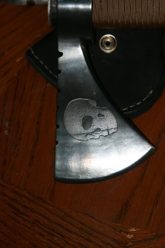

I had some issues getting the bluing anywhere near consistant, and as you'll see there was a spot on both sides of the blade the blue would not take. Also if you look closely at the skull you can see the heat treat line really intruded on the etching process.

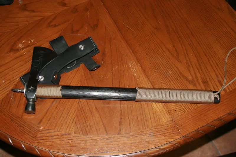

Still have a little work to do but she's 80% done. The top of the handle needs to be touched up a bit, handle needs wrapping, needs a final sharpening, and I have to finish up the sheath.
I've made leaps and bounds on leather work since my first effort. (All thanks to info found on bladeforums!)
Edit - Done as she is going to get!
Replaced cell phone pics with ones from a real camera.
Left the cell pic of the spike, I forgot to get a close up with the SLR.... Doh!
I wanted to make sure that understand right this etching process. You put your design on, paint the head, remove the design, put the etchant on the design, then after the design is etched remove the paint from the tomahawk head. I’m sure it’s somewhere in this thread but how long do you leave the etching on?
Wow great job Dfib. I had the same problem with the temper line. But the line goes right between the eyes of the skull and it looks like you meant to do that. That spike is awesome! How did you make that?

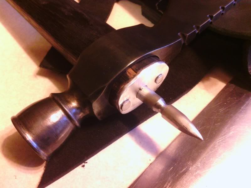

The spike started as a 5/16" piece of round stainless stock. I shaped the point roughly with an angle grinder, smoothed it with an 80 grit dremel flapper wheel. The groove was started with a 1/8" double cut carbide burr and smoother with an old narrow dremel flapper wheel that had taken on a convex profile. The top cap is actually a bit of aluminum sheet I had sitting around from another project that was rough shaped via dremel, set with tacks and then sanded with the now infamous dremel flapper wheel. The hole for the spike was a bit of a pita to drill straight with a hand drill...
Most of the work I've done on all the hawks was with the dremel. Just goes to show it can be done easily in a basement without much for an investment in tools.

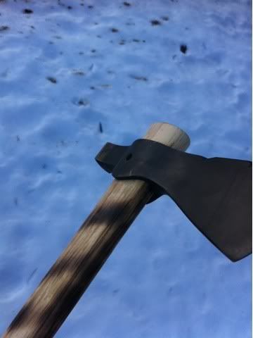

Lil more work on the hawk today. Boiled it in distilled white vinegar/lemon juice for 45min then sloshed it around in a baking soda/water solution after it was cooked down. Then took the handle to a belt sander to get the fit a lil better. Then torched it up a bit. Gonna go get some oil to finish the handle. Can't decide if I wanna use linseed, tung, or Danish oil.....

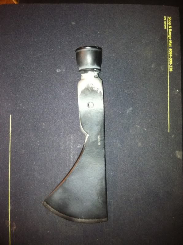

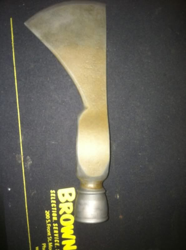

However...I decided to pick up a pipe hawk and have been playing as well. I didn't care for the sharp corners on it and made them go away, left the paint on during that phase to use it as a quick visual reference.
Then I decided to see if the sand blast and vinegar bath would rough things back up in the places I had worked over. It is darker of course, but does have a large transition from smooth to the rough finish.
Trying to decide if I should go to work with a flap wheel or dunk the entire thing in etching solution and try to make things match up again.
Any thoughts?

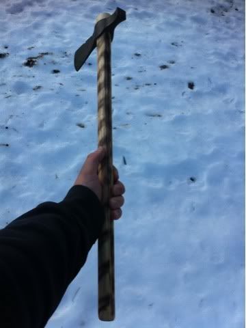

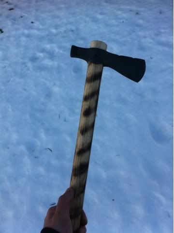

I also burned some rings on the haft using a butane powered hot knife....NOT easy to keep things straight. I'll post a pic of it once I apply a bit more stain.

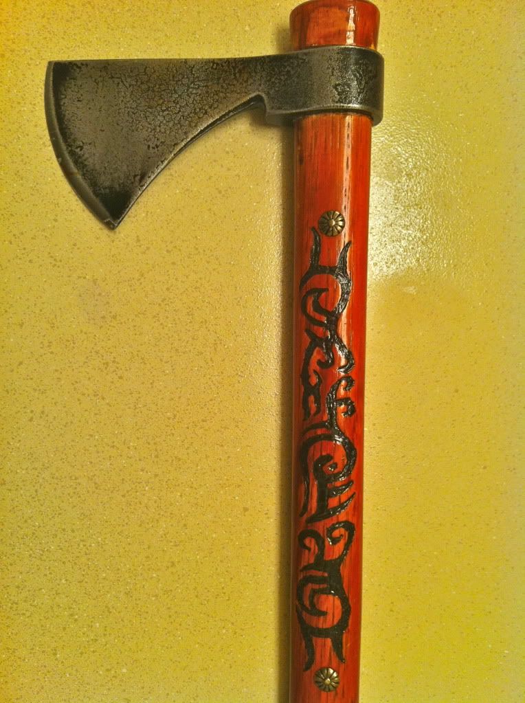

Something I did with a Frontier hawk head....
Obviously I stripped the black paint. :rolleyes: put a better edge on it, filed out some rough edges. Made a handle from some local oak, (I bought the head by itself and was pleased to see there was no screw hole) used some old leather for a sort of collar/overstrike guard and lanyard. Nothing too ornamental :( since I plan on using it. Throws well. Hoping to expand my collection.
Any thoughts?

Wonder what it would look like if you media blasted the hawk? Maybe an easy way to soften the transitions? I know you have more tools than you know what to do with.... ;)
Edit- Disregard the last, apparently hooked on phonics failed me again!
Light flapper wheel treatment, then media blast it again maybe?

I know what you mean, and very nice work!! Particularly like what you did with the frontier hawk.
