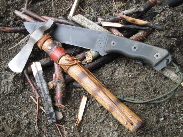

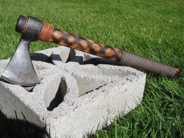

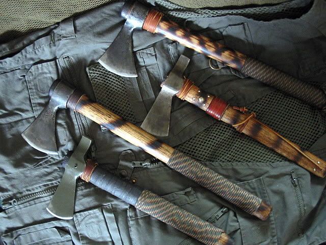

Here's a couple pics of my very first trailhawk and also its my first ever hawk mod. I think it turned out great and I really like the way it feels in my hand with the suede wrap. the burn rings were done using a mini butane torch from Harbor Freight that costed me a whole $8.00,lol and it worked perfectly for that task. The haft was stained with minwax american walnut and the jimping which came out kinda messed up was done with my $10 Harbor Freight rotary tool. It was my first time trying to do jimping and I didn't hold it at the correct angle so it was pretty sloppy from my attempts to correct the angles. Also I cut about 3-1/2 or so inches of the haft which made it a much better length.

It was my throwing hawk so it worked perfect. Also made a handy size as a camp hatchet. I would throw the longer ones as well but could not get the same speed.

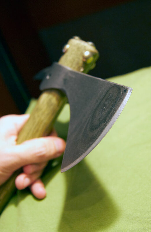

Frontier hawk. Made the handle myself from some local oak. Did some cross hatching with a small file, some filework on the head. oil finish.

Great looking hawk you got there btw!
I like the file work on both the head and the handle
