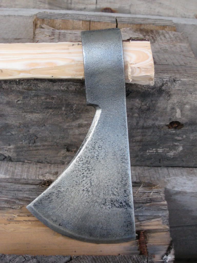

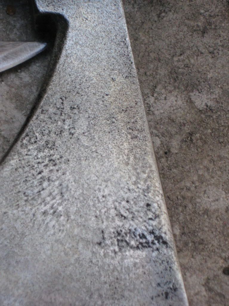

Modded Frontiers Hawk. Made some mustard patina on it. The haft broke during throwing, in the fields. So I made one within about ten minutes, using the Mora 711, wich rested on my belt.
Kind regards
Andi

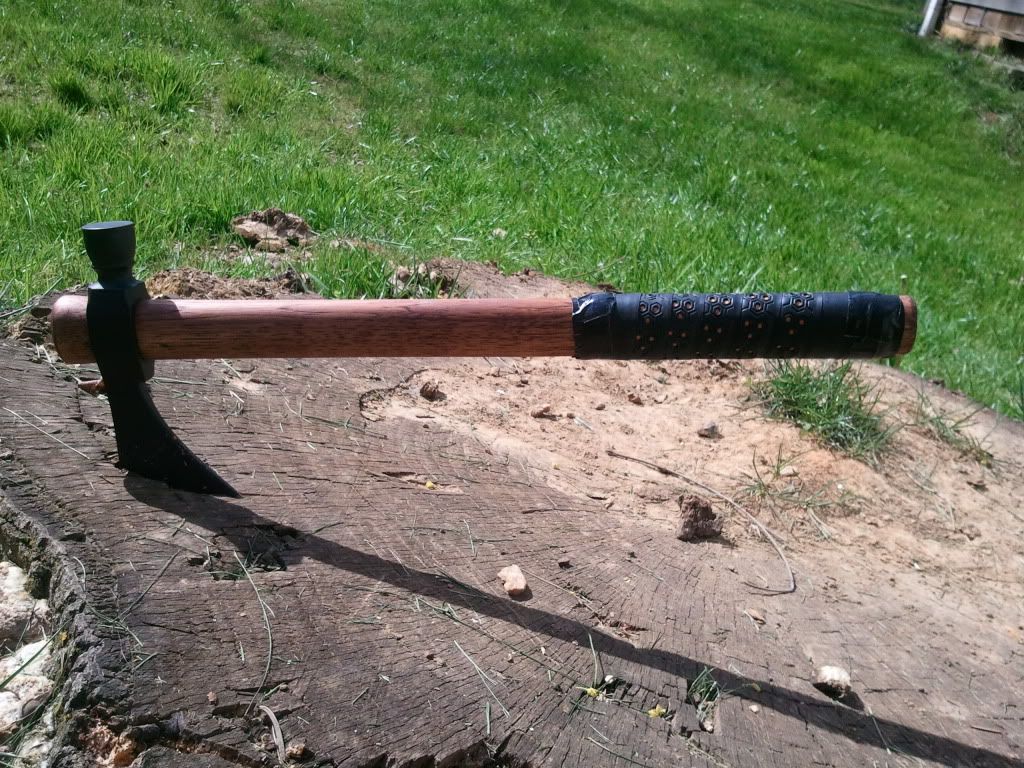

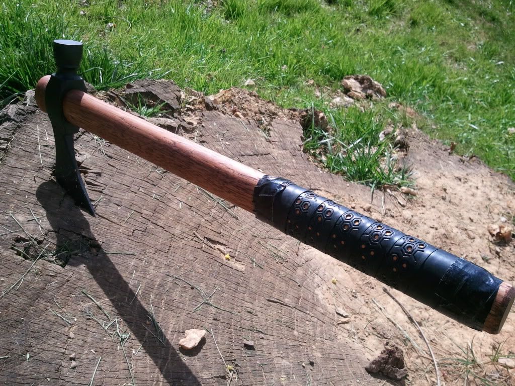

Just finished up another mod today. This one's going in the bug-out bag so I went less traditional and more practical.
Haft was cut to 19" and stained
Handle wrap is baseball bat handle wrap I got from Wal Mart. This stuff is great! Has adhesive backing so it goes on easy, rubbery texture for a secure grip and it has some shock absorbing characteristics. Highly recommended
Blade got coated in about 5 or 6 coats of flat black Duracoat. Since this will be sitting in my trunk strapped to my BOB for most of the time I wanted a coating that'll really protect against rust. Looks nice too ;)
