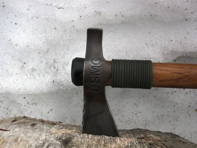

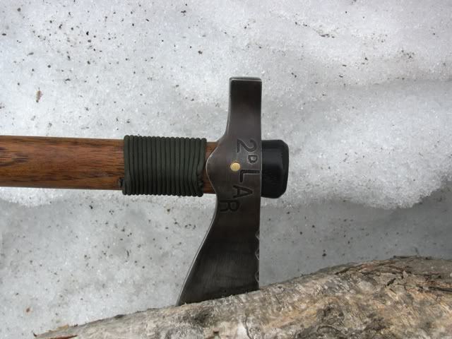

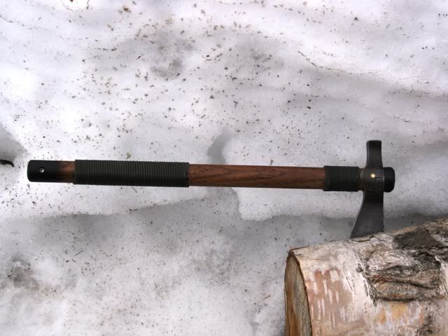

Today has been fun. I finally received my blueing solution and quickly got to blueing, I originally wanted to brown my hawk but decided not to at the last minute. Anyway, here's some pics of her
I also filled that hole with a brass screw I found in the road a few weeks ago, I just filed the screw smooth and peened it in then filed it flush as well as I could without ruining the blueing.
It might not be perfect but I feel it really compliments the blued metal.
Thanks guys. The blueing was easier to apply than expected, I only applied two coats for a lighter finish. It does seem to wear off pretty fast at the blade though, however the effect of it wearing off gives it a battle-worn look, kinda reminds me of an old and abused Kalishnikov.
