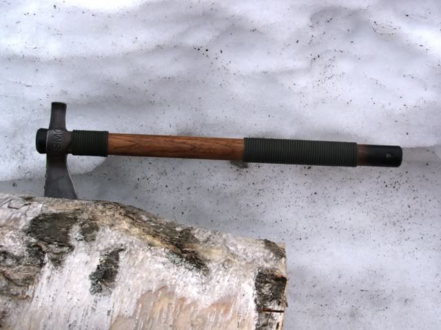

Mod'ing The CS Trail Hawk
Very nice!
I love how to took some metal away from the bottom of the head and made it curved more like the Pipe and Rifleman's Hawk
I actually wanted to do that to mine, and now that I see it, it may just have to happen

Very nice!
the best piece of advive is to have a bucket of cold water next to you so you can keep the metal cool if your using any sort of grinder to do the metal removal be it a bengh grinder, belt sander or a hand help angle grinder or even a dremel. during the entire grinding process the head never got hotter than was bearable to touch & i used both a bench grinder & a bench belt sander. good luck with the grinding.
