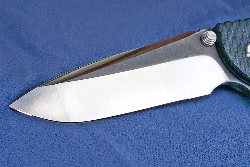

Finished these up the other day! Note: if the tip area looks blurry in the first one it's because the camera isn't focused on that point. All of these are reprofiled to 15 dps and taken up through 10k waterstones + strops.

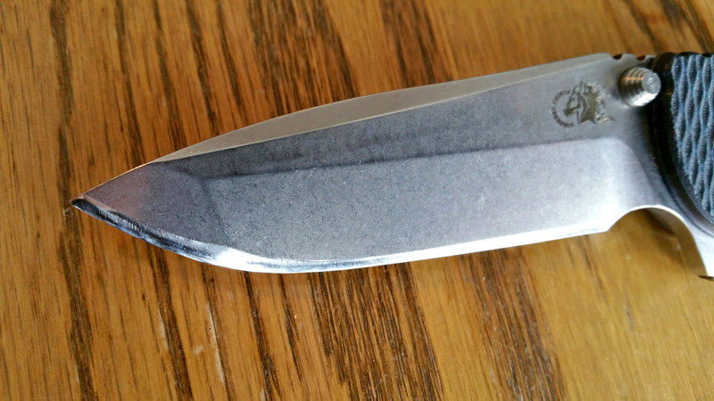

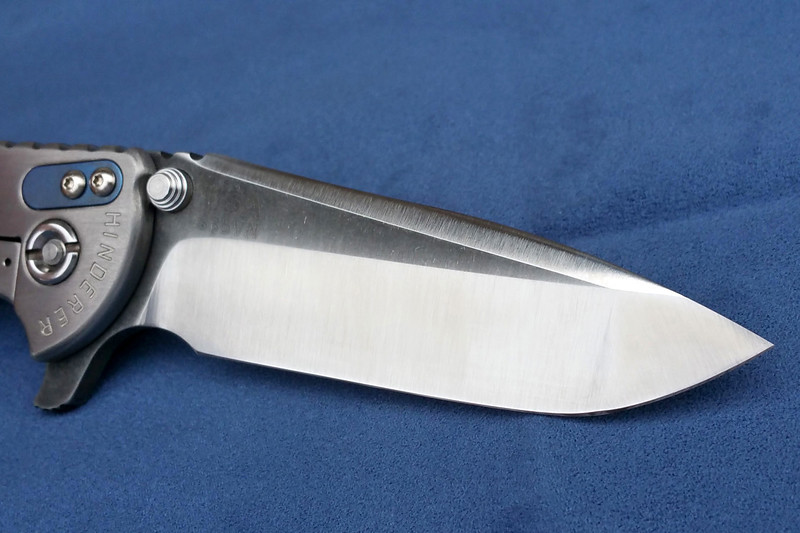

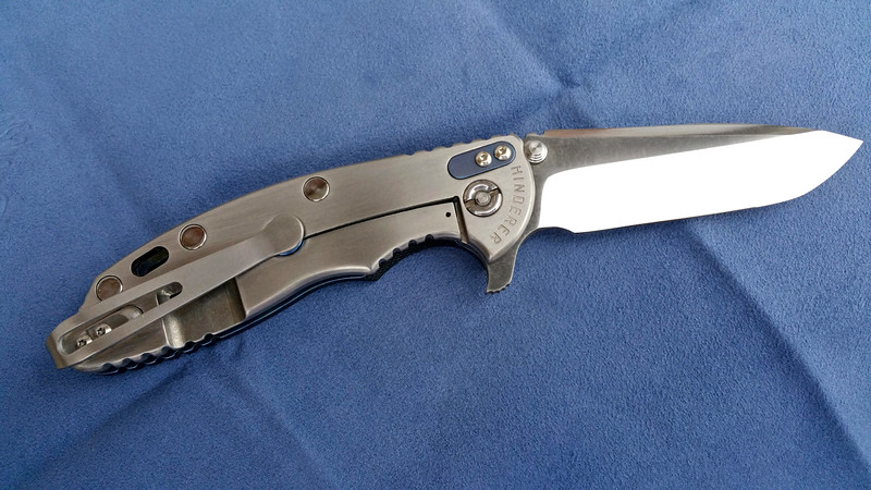

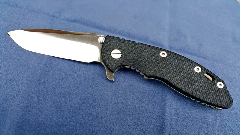

Josh, thanks for a fabulous job restoring this Hinderer spanto blade for me. Here's a thread with more details about this knife. Customized Hinderer XM-18

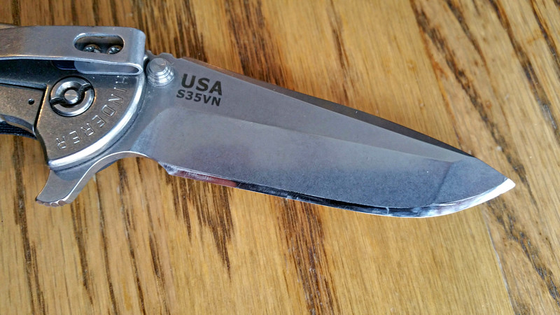

Here's what I sent Josh to start with. It had been significantly damaged by careless sharpening. A re-grind was the only way to repair this.
Here's what Josh sent me back! My goal was for a look similar to a ZT 0801 Copperhead. What a gorgeous blade! Thanks Josh!

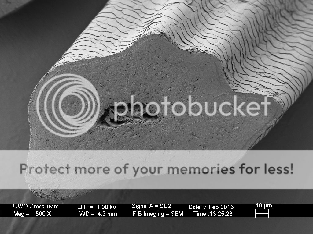

Also, on the HHT, something has always confused me. Is HHT-2 referring to "hair whittling"? I had in my mind that whittling requires a sharper knife than simply cutting the hair in two as you pull it over the edge. But severing the hair shows as one step higher---HHT-3. Am I reading this right, and is this your experience?

The HHT tests are designed to be consecutive. So HHT-1 is the "dullest" whereas HHT-5 is the ultimate sharpness. Hair whittling is not as sharp as hair severing, and then you have to specify what the point of hold is from the cut. It is very difficult to get a HHT-3 or 4 at 1" from the point of hold. Same is true when it comes to push cutting phonebook paper. Paper has a grain direction, most of the time it's from top to bottom, or long wise. If you try to cut the paper from side to side you will notice that it is much more difficult to cut. And then to top it off, try holding it .5 or 1" from where you try to push cut it from and you will see that it is no easy task.

HHT is a very subjective way to judge sharpness. It depends on the hair used, and also the edge finish, etc. For knives HHT probably is better test than for razors where HHT tells you nothing about how the edge shaves.

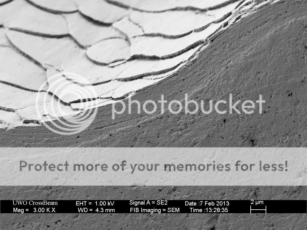

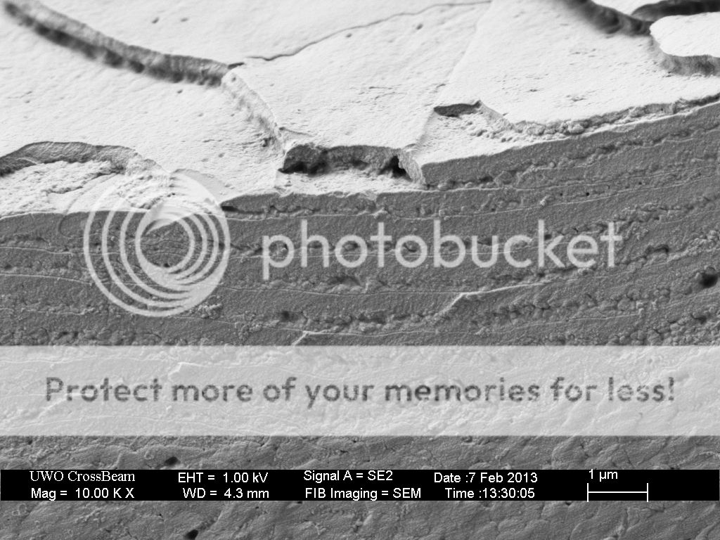

You are right in that there are a lot of variables and it needs to be only one of multiple thing used. It is interesting that I have gotten HHT-3 or so but then when I look under my USB micro scope at the edge it has some chips in it, which would lead to a rough shave. So when I mirror an edge, I look at it around the 2k level to make sure there are no chips whatsoever and all the damage is removed. Many aren't aware but it also depends on which direction you cut the hair as the edge can catch under the plates (see below) and cut it easier than the other way (the former is the more standardized test). And that's what Coticule is about, standardizing the HHT so there isn't as much variation. For razors I would not say it tells you nothing, but it is one of several different tests to ensure shave readiness.
For example if I had a razor that would pass HHT-5 and one that would not pass HHT-1 then you know that it will not shave (in other words, it will not even shave arm hair). Whereas the HHT-5 could be a rough shave, due to the edge chipping out or too keen of an edge (which I actually disagree with but that's another topic lol), but at least it would shave.

HHT should be performed always in direction from toot to tip to avoid catching on the cuticles. For razor HHT tells nothing about shave readiness only sharpness, and sharpness alone does not indicated comfort when the edge touches the cheek. Shave readiness can only be accessed with a shave.
I think we are kind of saying the same thing... I agree it only tells you sharpness but not right off hand how the shave will perform. But as you say, it does indicate sharpness/keenness at the apex. And if I understand what you are saying, you are wrong about which direction the HHT should be done from. As stated on the listed website you are to hold the hair at the tip side, not the root side.

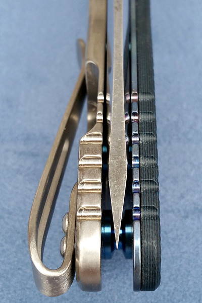

Here's one that was a type of scandi (w/ a secondary edge as well) 3/16 blade stock I think. Owner wanted it converted to FFG thin edge.
