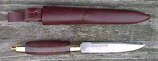

They do not make that exact model now. I'll see if I can find a model on the web that's similar and post it here. I don't have it handy right now. :)
Edit: This is the closest thing to it I can pull up. Mine is a K.J. Eriksson, but the pommel cap, guard (minus the damage), and sheath are nearly the same. The blade on mine is shorter and of a more typical "Mora-like" profile, and the pommel is affixed by a pommel nut that screws onto the tang, rather than riveted as in this example.
Not even close. That looks nothing like the picture I posted. Thanks for trying, though! :p
I'm aware of that more premium piece...it's just I wish they made a couple of pieces similar to the one I posted, which I know they don't. They USED to, but the market probably evaporated, which is why they don't anymore. I just love the little extra details, though, and the sheath was excellent--too bad it got ruined! :o

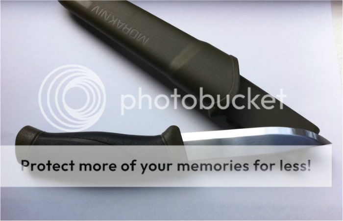

i got this mora companion yesterday (from baryonyx knives) , excellent knife with great fit/finish.

Regarding the blade lenght, it has been 115mm some years ago, but nowdays it is 109mm with no tolerance specified. The reason for making the blade shorter (e.g. blade is put longer into the handle) is that some users had the blade tip coming out of the sheath. I´m sad to say that we forgot to put new info regarding lenght on our webpage. Regarding the "uneven grinding" the measur has a tolerance of ±1mm in production. As it has very little effect on performance we might let this be wider from time to time. The knives you are showing on picture is produced more than 5 years ago when "Mora of Sweden" logo were introduced. Nowdays production has a "MORAKNIV" logo.
We (Mora of Sweden) like very much to have contact with users and consumers as that is a very important source for input to future modells and development issues.
As from today we have an user account on Bladeforums (this account = Morakniv) to try to respond to Mora-issues as fast as possible.
