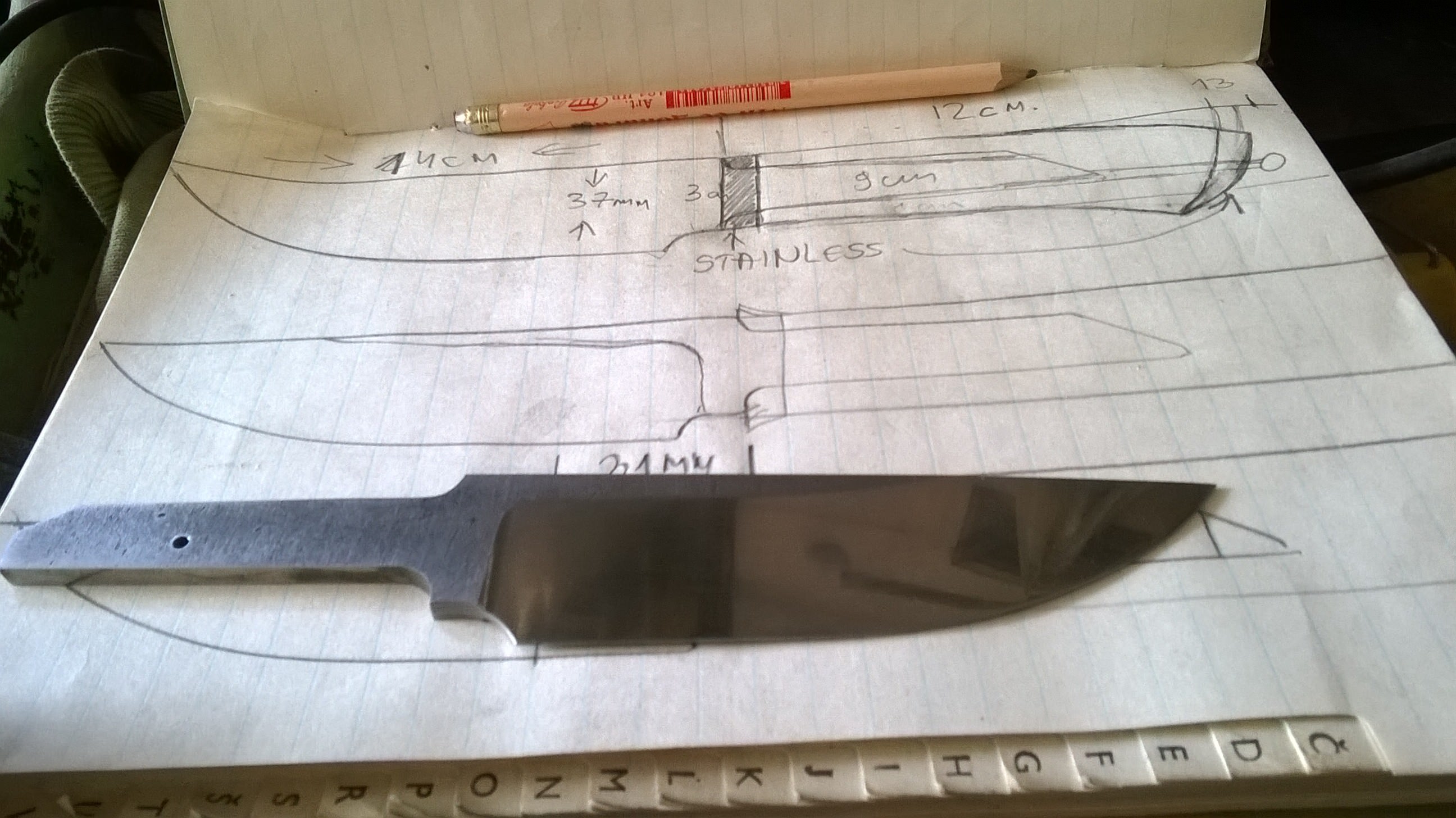

My first attempt at making a knife

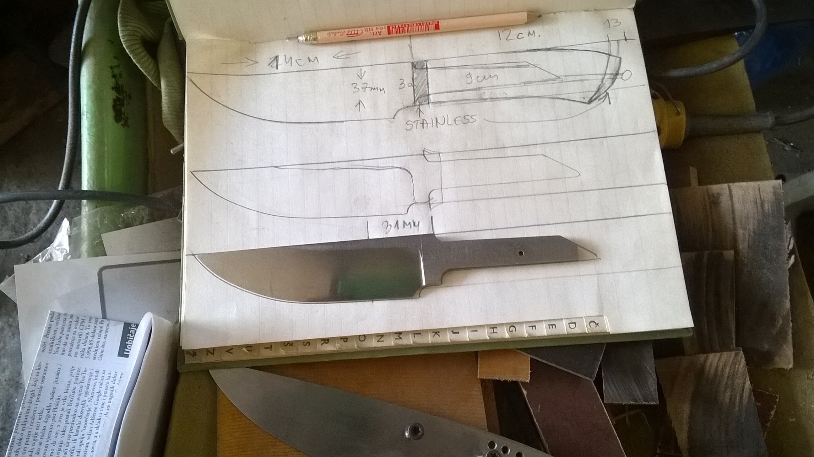

Oh I'm not giving up on it. I'm going to finish it. I just need some more stuff to do the heat treat correctly and I'm low on funds right now. I bought quite a bit of steel so instead of waiting until I can heat treat this one I figured I would make some more. Also makes more sense to buy the material to do several handles at once.
I have a bit of a low spot I have to work out on this one but good progress so far.

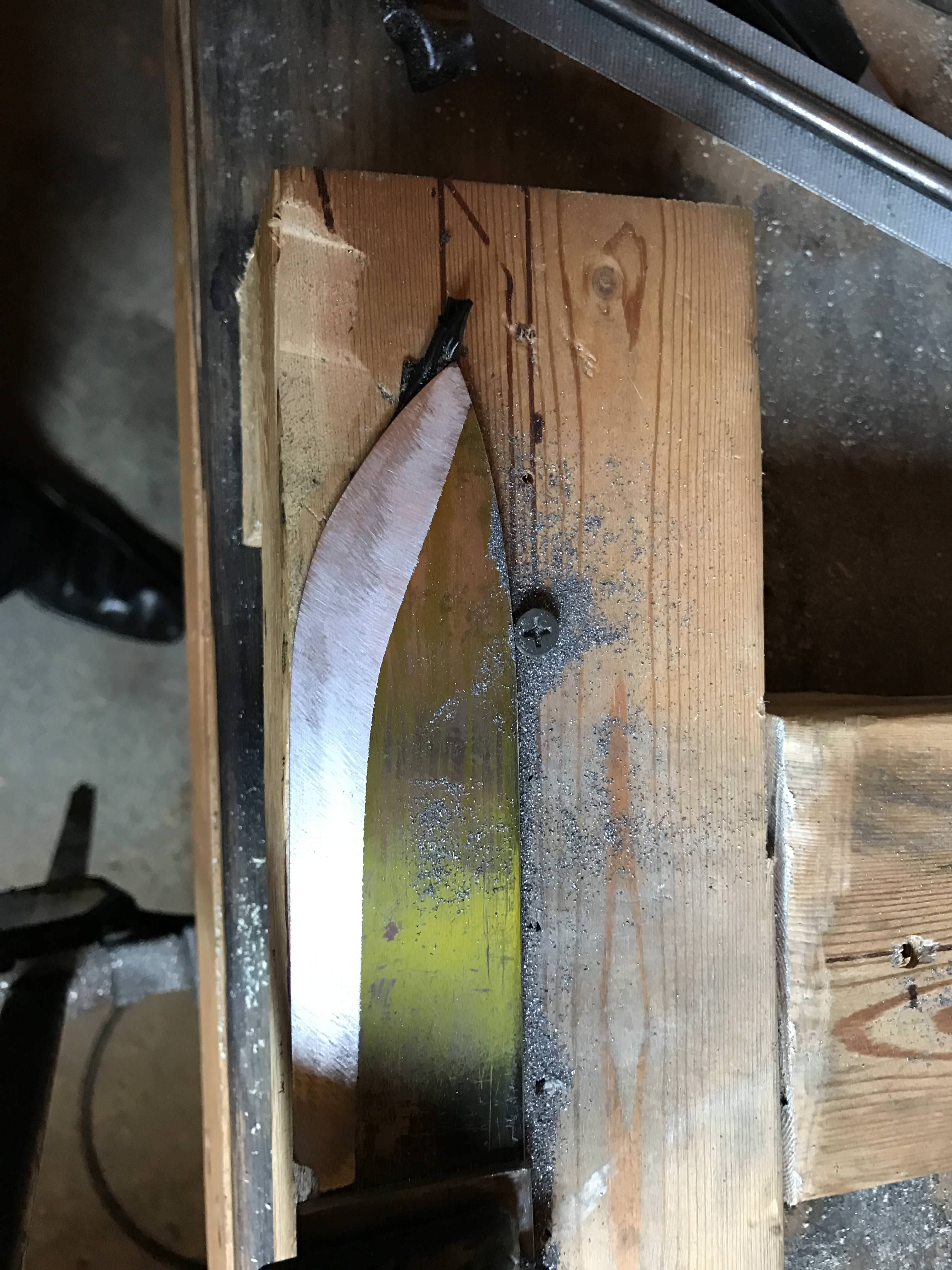

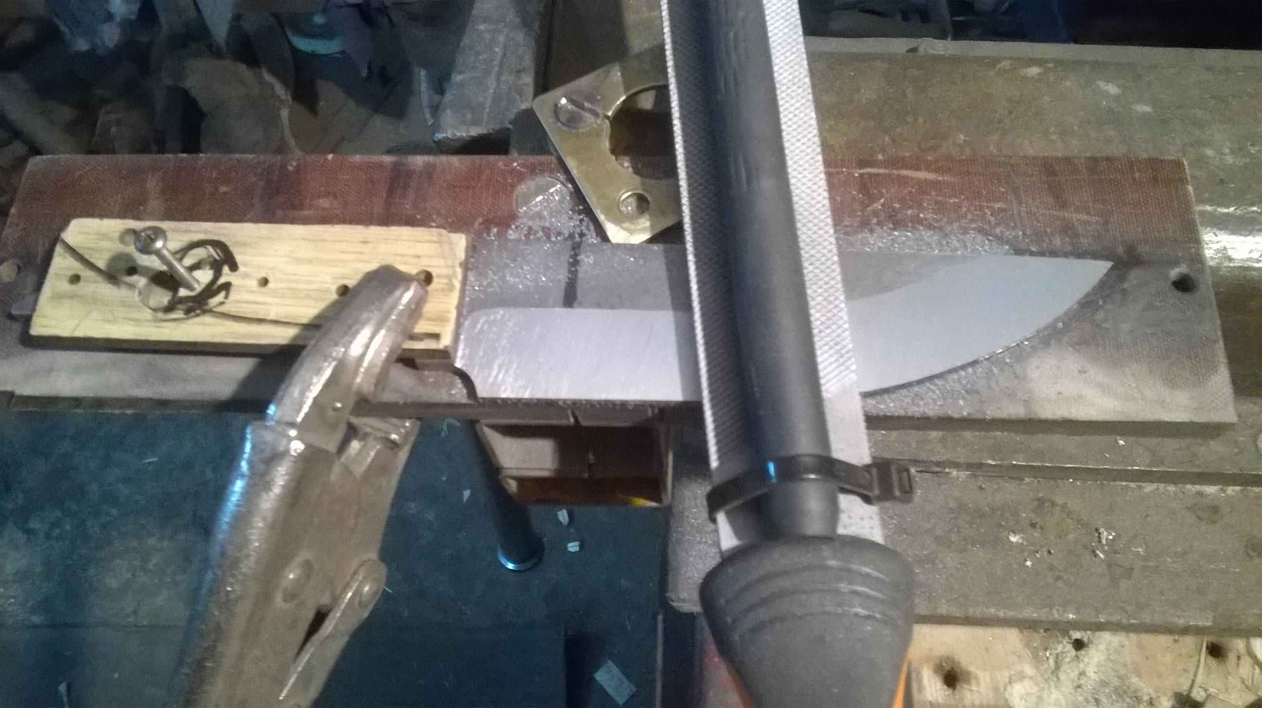

Several questions and a problem.
-Does the direction I file make a difference? I have found myself doing tip to handle for a while and then switching. I recently noticed that this change of direction slightly changes my angle. I'm guessing this isn't a good thing to do?
-Should I be going the same direction on both sides or does it not matter. For the most part I have been doing tip to handle on one side and then the opposite when I flip the knife over. I seem to get better results with tip to handle but it is difficult to do on the one side because I'm not ambidextrous.

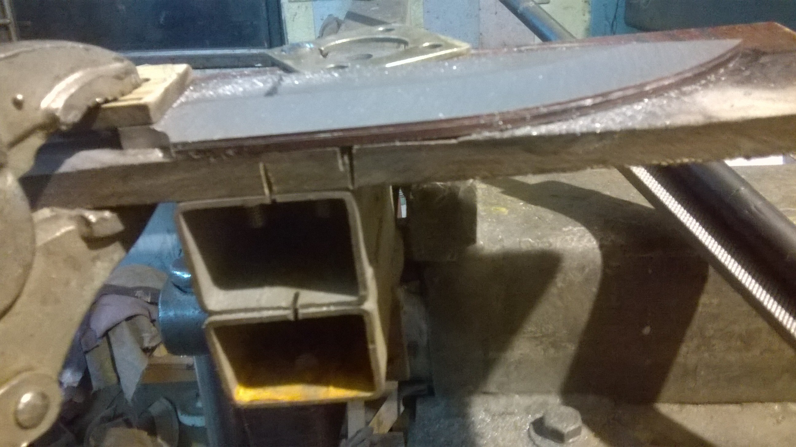

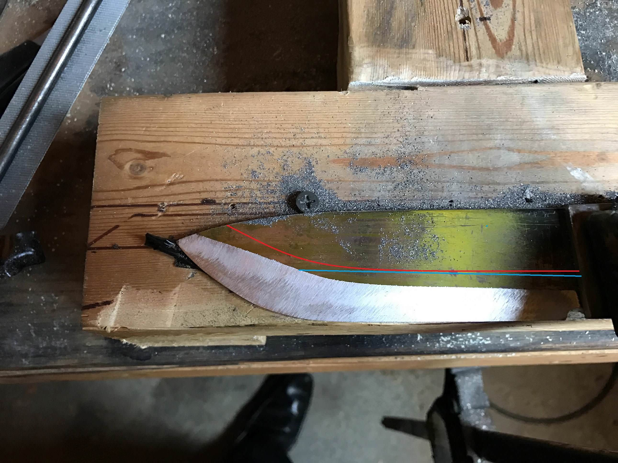

-Finally I'm having a tip issue. The first side I bevel looks fine. Then the other side doesn't get as much of a grind on the tip (see below). I'm assuming this is because the other side is beveled and when I apply pressure on this side, the steel flexes slightly away from my file. I have tried sticking a bit of leather or even some rolled up electrical tape under the tip to give it just a little more resistance but it doesn't seem to work and I'm also concerned about puting a bend in it if I use anything more rigid.
Any ideas?

I never grind from tip to handle . .. ..
Watch this video

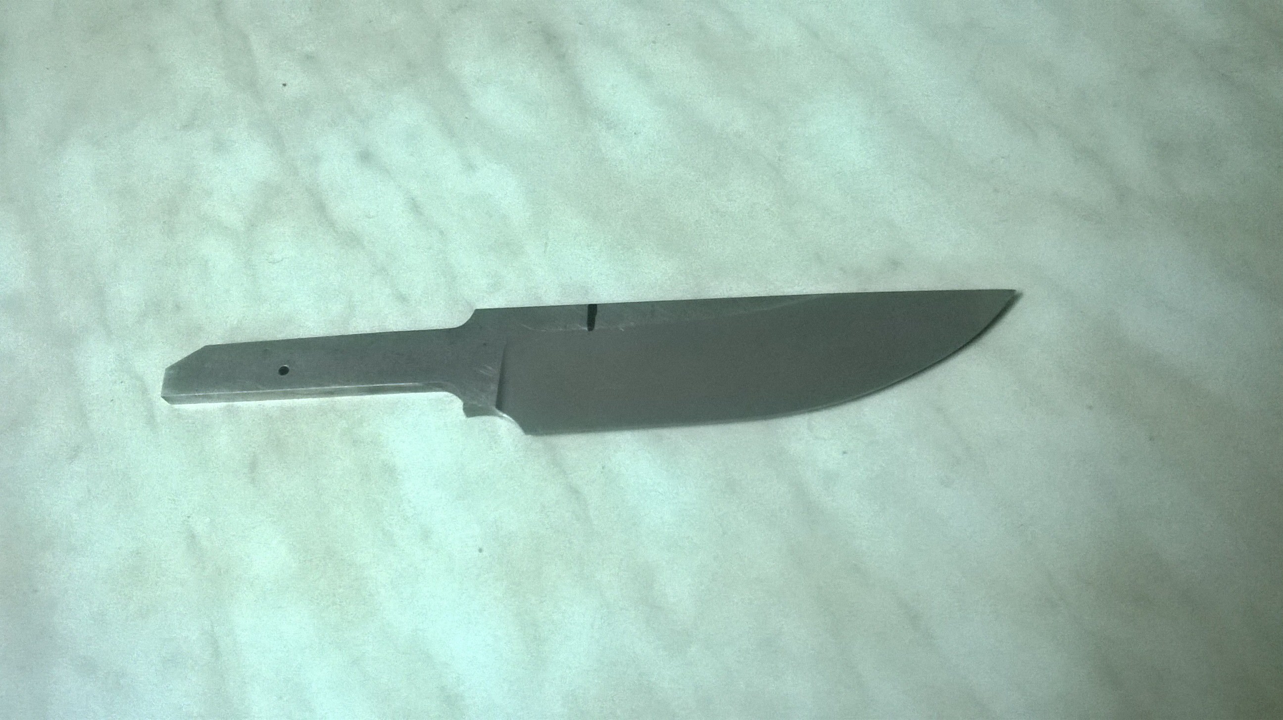

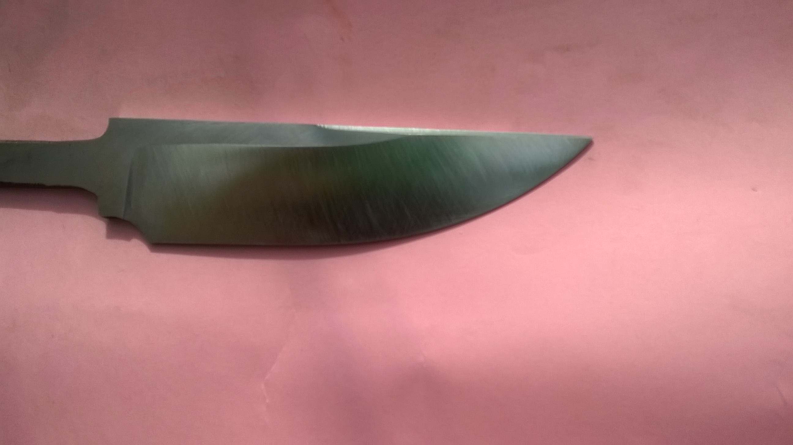

You have to keep grind line even like red line on picture .Start to grind only where is blue line until you reach the blue line . Then start to grind from plunge line to tip and take care that grind line always is like red line , then tip must come as it should . .While you grind angle on file is constantly changing .And if you don t grind even you have many different angle Remember ,file does not go in a straight line ,since the rod is in one point , file make circular line from plunge line to tip .When file come to grind belly that angle changed even more ...... Never mind , hard to explain in English :mad: Just try to keep grind like red line and everything will come in place .. .. Do not hurry, go slowly and from time to time draw with file from ricasso to tip .

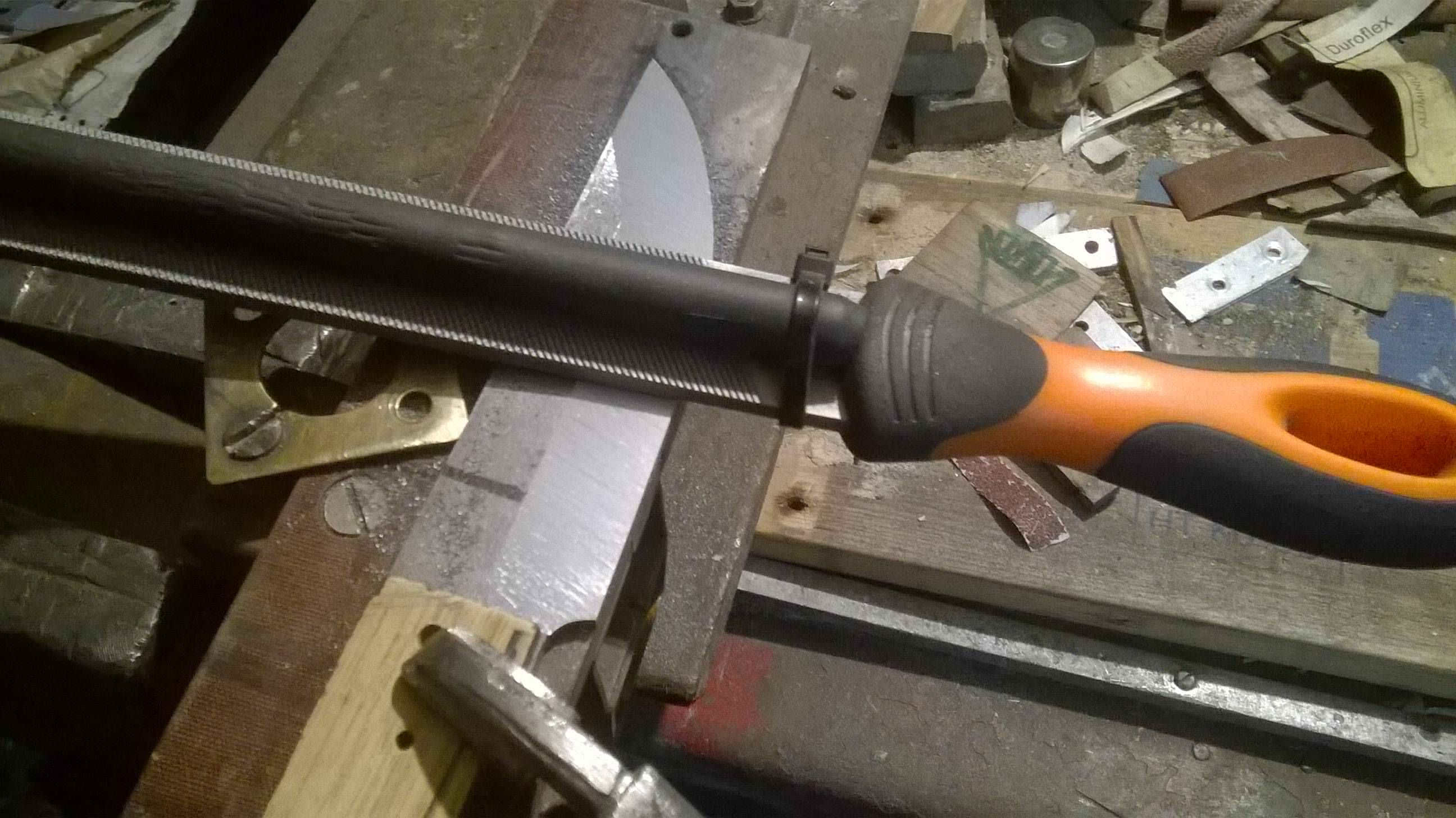

Look how does it look when I use my file jig . . .
Central line is important for uniform grind .. ..

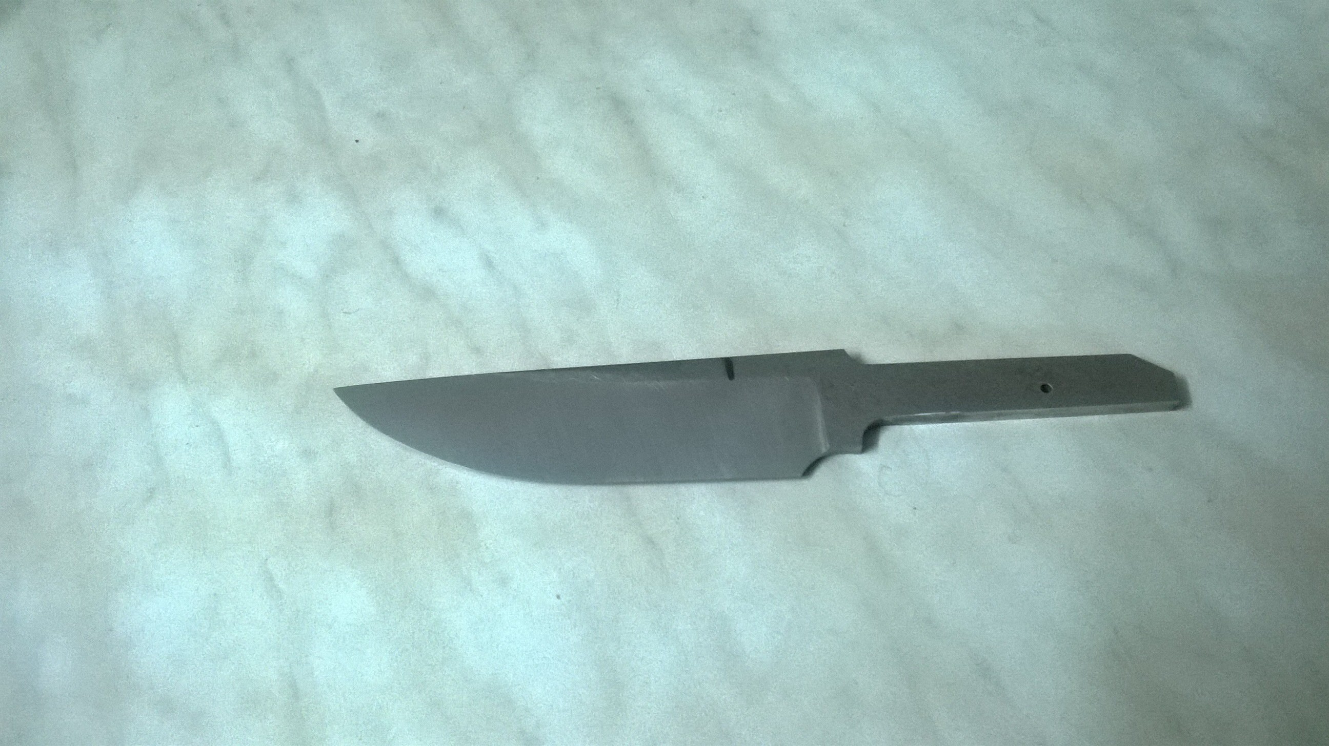

Ready for HT
Ready for handle ;)
Wait , can you take picture ... full jig together with blade and file ? It seems to me that ricasso is to close to make right angle with file ? Move left blade , blue line to come on place of red line ...if I m right , move blade left , blue line on place of red line ....That s why tip come like that :)
I actually did move the knife back later on because I wasn't happy with my plunge line. On the other side I started where it should be. I'm almost certain the bevel looks like that near the tip because the other side is already beveled and not flat against the jig.

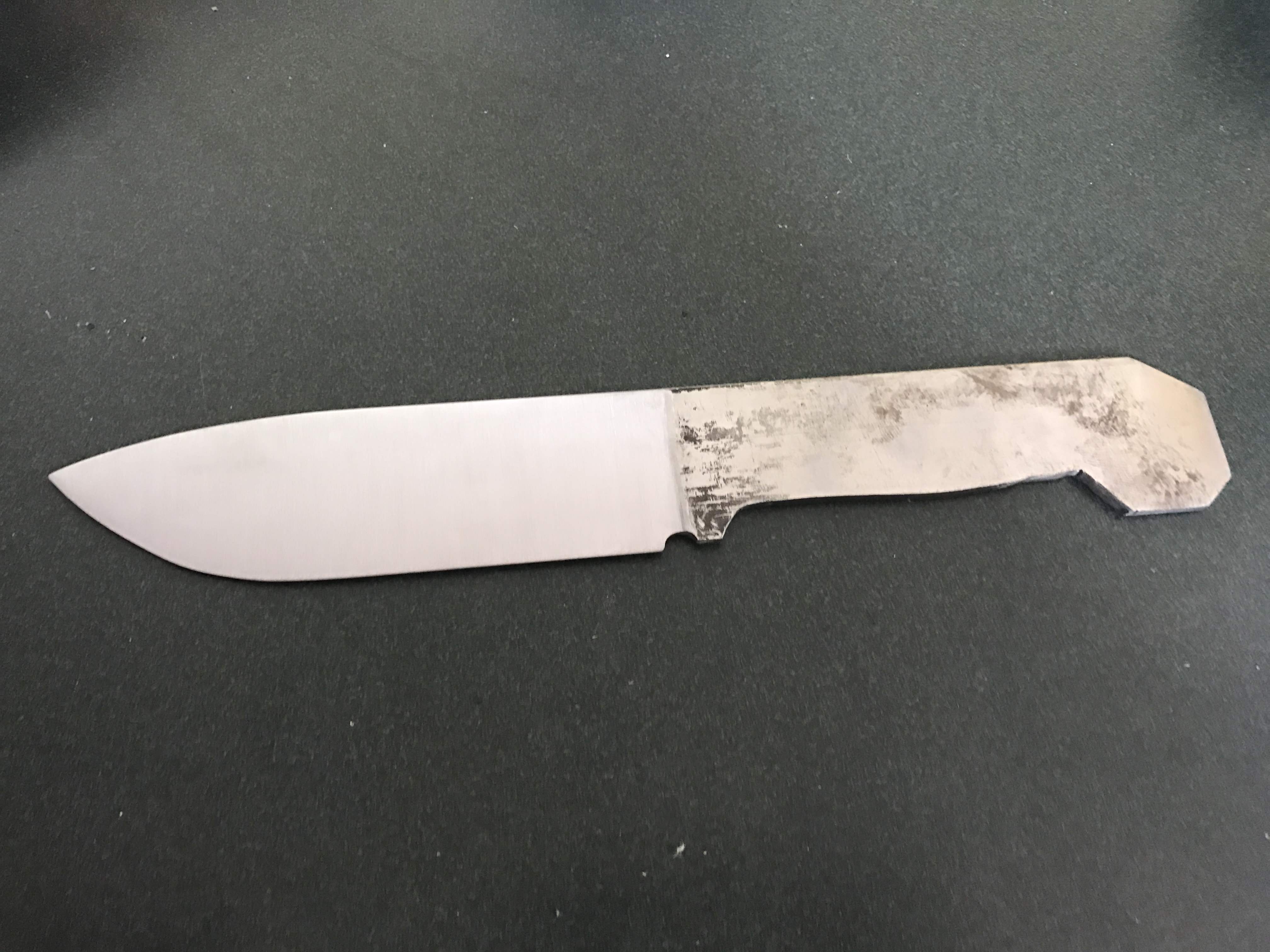

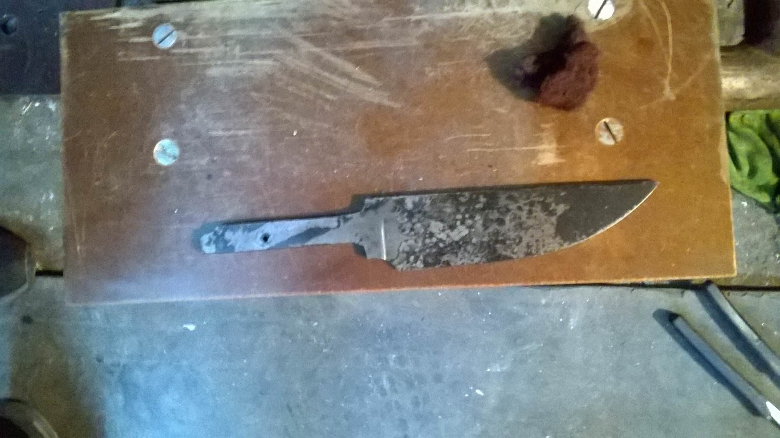

Ok I got it figured out. Filed and sanded to 220.
So new issue. My edge right before the tip is just a hair thicker than elsewhere. A little bit thicker near the plunge line too. I didn't think it was very noticable until I got it sanded. Is there a way to fix this without starting over with filing and sanding? Maybe when I put on a secondary bevel?
Now it looks much better :thumbsup: What is the thickness of edge now ? 0.5mm for HT is safe .... .

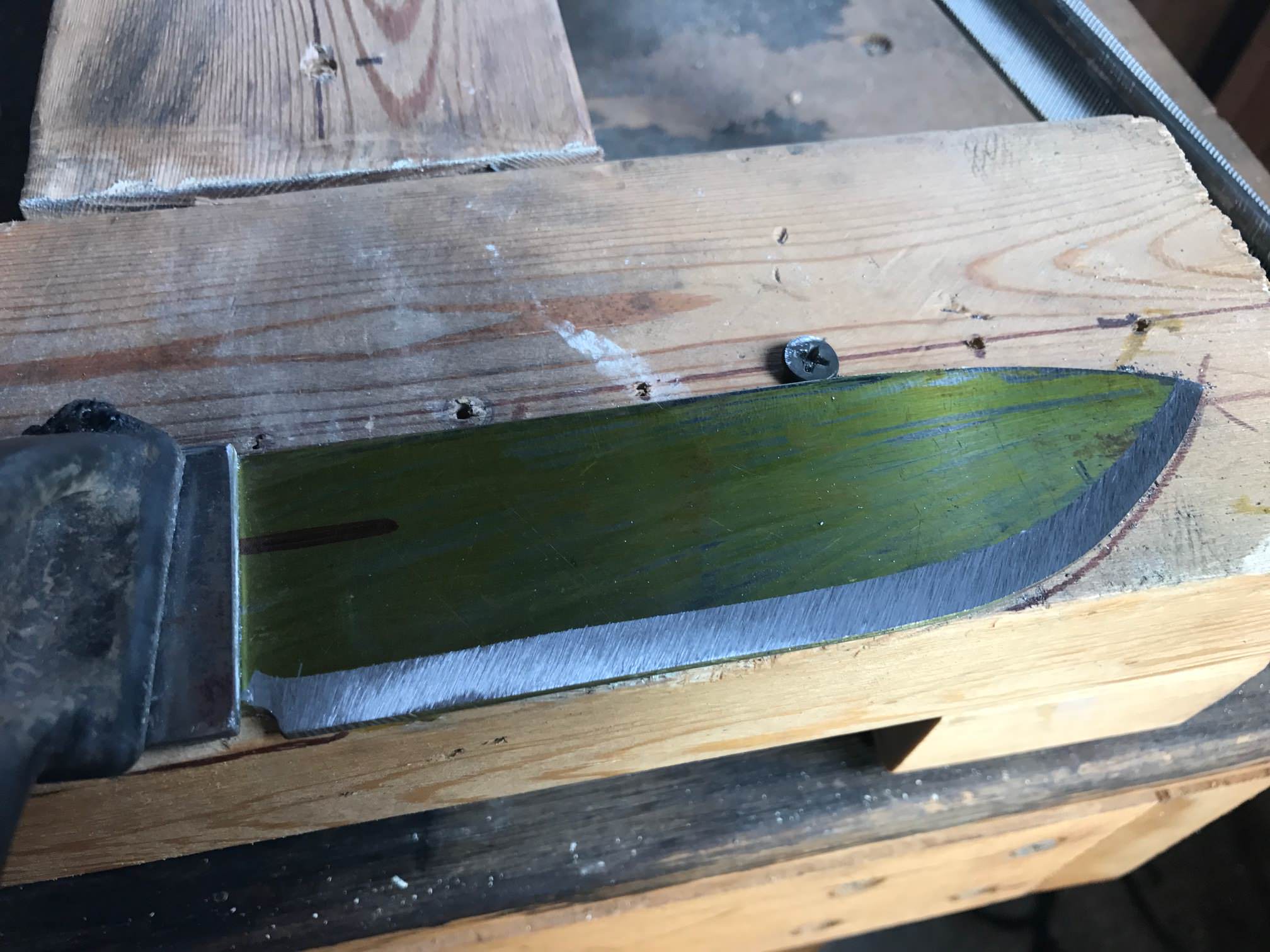

So I finally bit the bullet and heat treated both knives. We used an oxyacetylene torch. The small one was quite easy and has a very minor warp that in all honesty might have been there before heating. We quenched in canola oil.
The larger knife wasn't as easy We ended up coming at it from both ends, one with the oxyacetylene and the other side with a propane torch. We should have flipped the knife periodically because this one warped quite a bit. While it was still hot I stuck it in a vise and straightened it as much as I could. I'm going to try to fix it some more during a tempering cycle but it has a heck of a wobble.
They are going through their first tempering cycle now in my convection oven.
