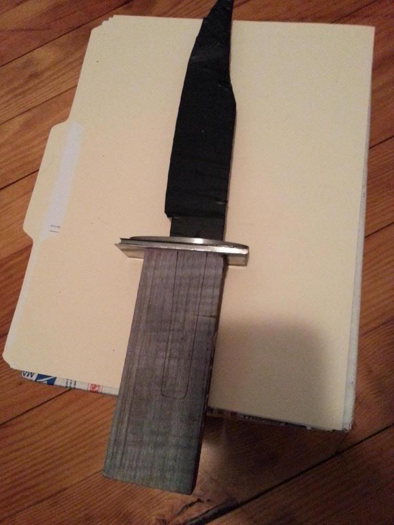

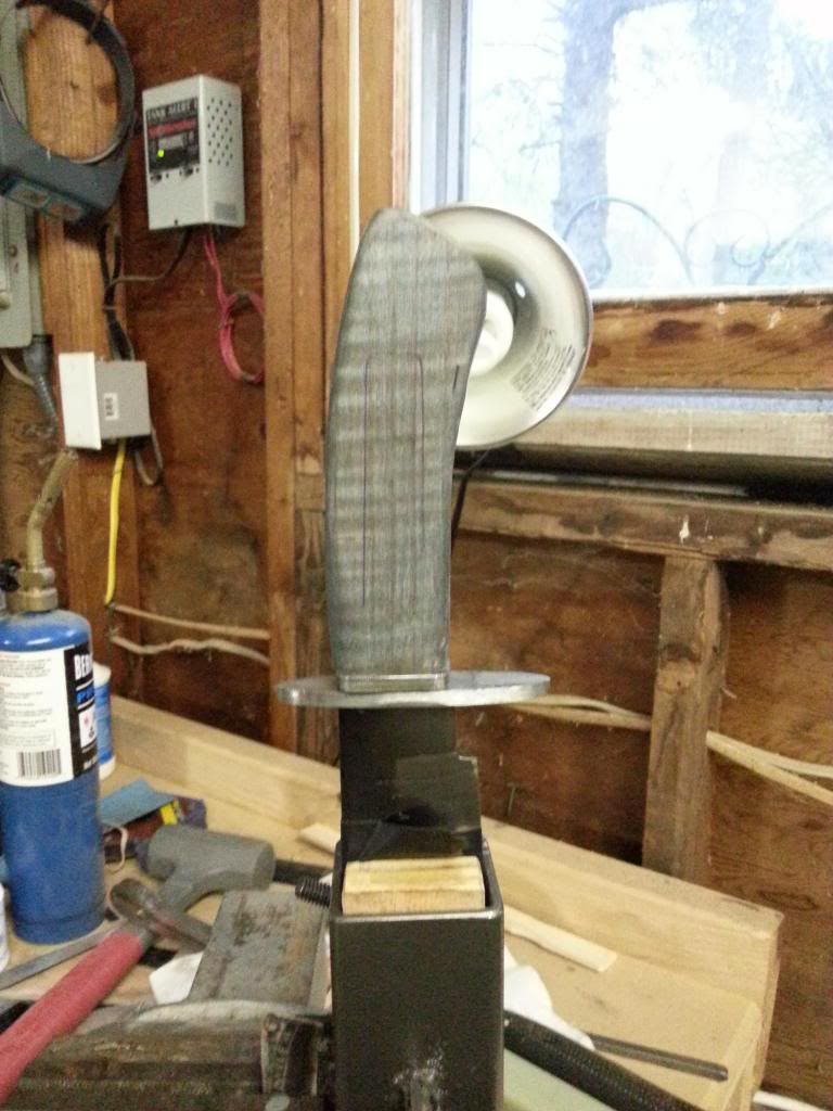

Thanks guys. I did the guard earlier today and after about 10 hours I decided to just hand fit everything together because I guess I'm not "seeing" how I want this guard to go with the spacers I guess is the best way to put it. I'm assuming my only real option is to shape the spacers and let the bottom of of the guard be by itself right? Pics seem easier to explain and I apologize for the quality I took these in the wee hours of the morning.

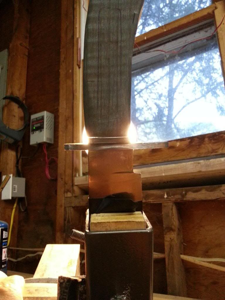

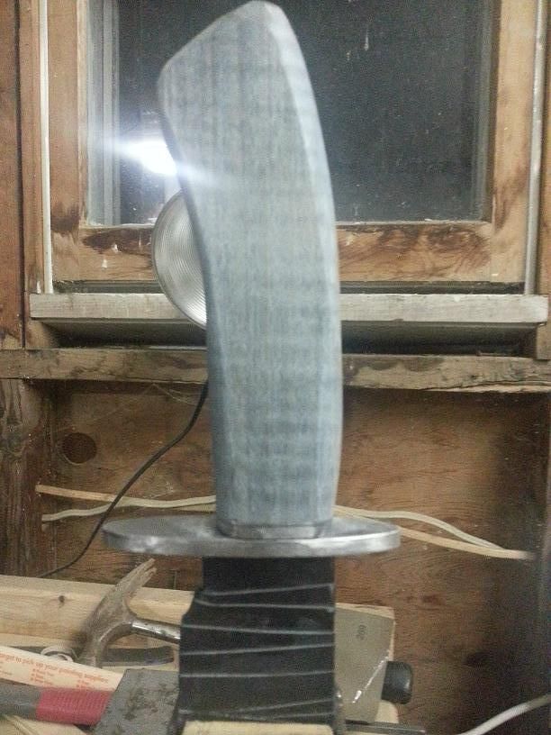

Here it is and it's amazing how the flash makes the block look so blue in comparison to the other pics lol.
Another shot where it looks like a totally different color block :confused:

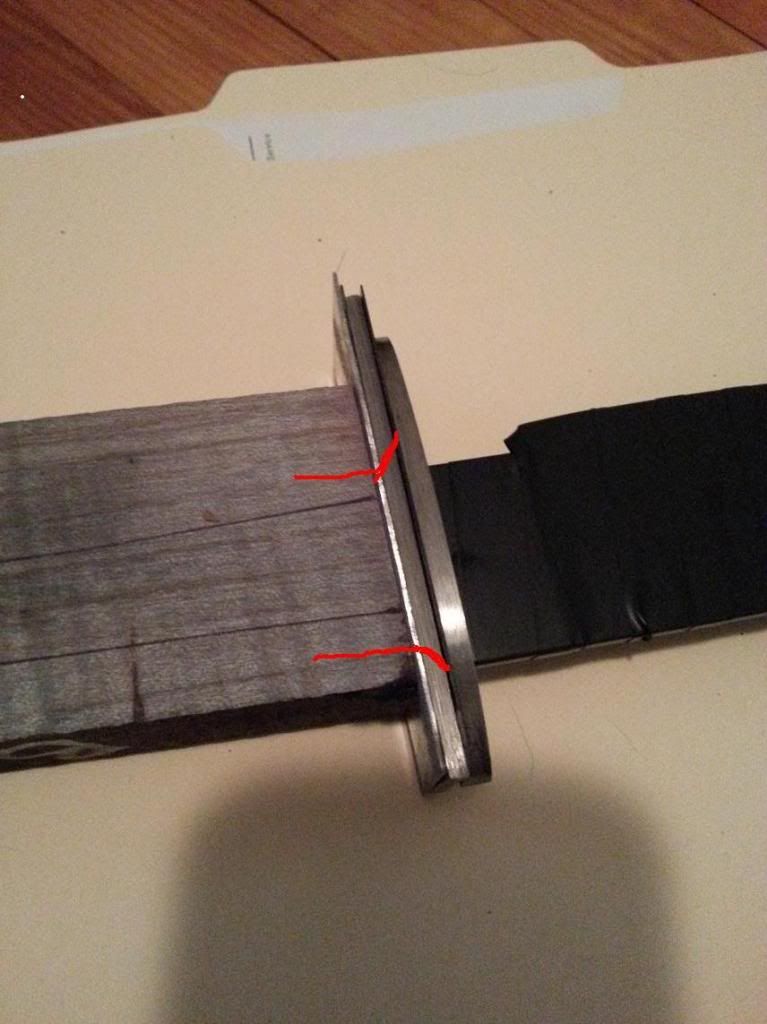

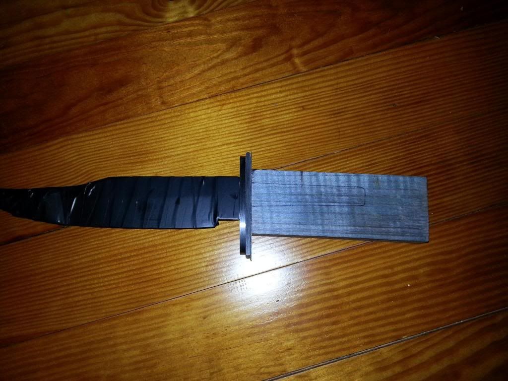

Here is where I'm talking about trying to visualize this thing .
I'm having a hard time visualizing the flow of it into the handle I guess. I think it's because I see most people on here do the guards with the "wings" on them so they flow right into the guard and handle I'm assuming I can't necessarily get that look here (which is fine). But before I take files to everything once it's glued up I need to have a plan. I'm assuming all I can do is basically shape the spacers in line with my crudely drawn lines and see the back of the oval guard right?

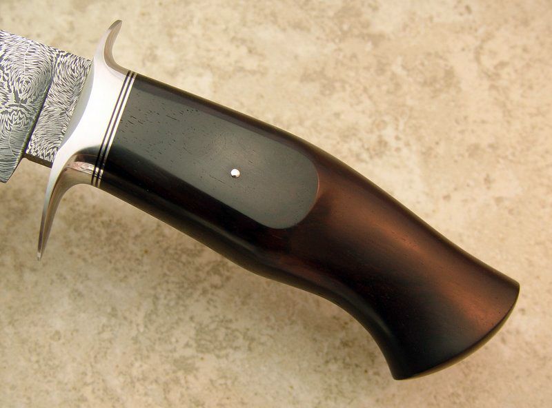

Or is it possible to extend the curve of that red line right out to the guard and have a guard look similar to what Nick tends to have on a lot of his Bowies or like Phillip did here http://www.bladeforums.com/forums/showthread.php/1158671-Fighter-WIP/page3? Or would that look stupid because it's a thinner stock and would look whimpy if I lose the oval look?
Lastly I plan to glue this thing up tomorrow and I'm wondering is there a need to use any glue between the spacers or do you just rely on everything being sandwiched between the guard and the handle? In other words just put the glue in the block slide the tang in and clamp it up?

You could slide everything back off of there ,make a sacrificial guard out of wood ,plastic ,or something,then put all of the spacers and the handle back on .Then you could shape your handle right up into the sacrificial guard,including grinding right into the sacrificial guard without fear of ruining the real guard .Then ,when you put the real guard back on and slide the rest of the handle up to it you'll have the nice rounded contours of the handle meeting up with the flat backside of the guard.

Make a mock-up of the tang in mild steel. Leave about 8-10" of "blade" on the bar for a grip. Make a guard spacer in Masonite, Micarta, or plywood, and then put on all the handle parts. The guard spacer is just a backer, and doesn't need to be any larger than the end of the desired handle. Push everything up snug and check to see that the guard-bolster-handle and any spacers all fit flush. If all is OK, there are two ways to proceed....but first, a tip:
Now, this is a really important and professional tip:
Before you do any assemble and shaping, drill two small holes through the guard spacer, through the metal bolster and any other parts, and up into the handle at least 1". These holes should be about 1/8" on each side of the tang hole. I like to use a 1/16" drill bit. Slide in two pieces of 1/16" piano wire (taper the ends, and leave about 1" extra to stick out for later). They should be snug, but not too hard to pull out. You now have reference holes and pins for later disassembly/assembly. Slip the handle assembly, with the pins in place, back on the tang/mandrel.
Now, back to the handle shaping methods:
1) What I do is to drill an undersized rivet peg hole in the handle. Carefully drill it where the final pin will go with a 1/8" bit all the way through the tang/mandrel and out the other side of the handle. Put in a brass pin with one end tapered. This will hold the handle snug enough while shaping. If it is a bit sloppy, take it apart and slip a thin spacer of a business card between the sacrificial guard spacer and the bolster. This should make things snug. Once all is snug, trim off the excess brass pin and shape the handle and bolster as one unit.
2) The second way is to put just a little bit of 5 minute epoxy in the handle hole and clamp tight while it dries. Once the epoxy has cured, shape the handle as one unit.
After the handle is shaped, briefly put a torch on the metal next to the guard spacer and it will all come apart easily.
Sand and shape as needed to get the handle ready for final assembly. Once the handle is shaped and sanded to 400 grit, tap out the brass pin or heat the tang/mandrel as needed to remove the handle.
Before going any farther, make sure the blade and guard are completely finished...sanded and polished, etched, etc. If all is well, tape up the blade.
Pull the alignment pins on the handle assembly and discard the spacer block. Put some epoxy on the handle end and on the bolsters and any spacers. reassemble with the pins and clamp as needed to hold snug while the resin cures. Trim the alignment pins as needed so the are flush with the bolster. Touch up the handle if needed with fine sandpaper.
If you drilled the handle with a 1/8" pin hole, place the handle on the knife and mark the tang with a 1/8" bit through the holes. Just drill enough to make a mark. Take off the handle and drill where the mark is with a bit a little larger than your desired final pin. I like 1/4" pins, so I use a 5/16" bit. For a 3/16" in, use a 1/4" bit. If the tang is hardened, you will need to use a carbide bit.
Put the handle on the tang and up against the guard. Adjust the fit as needed, and when all is ready, tape the wood up to the bolster. Make sure you tape over the 1/8" hole if you used that method. Glue the handle up as normal, and when the resin is cured well, remove the tape and touch up any squeeze out at the guard and around the pin hole. If you did the pin hole method, re-drill the 1/8" pin hole to fit the final pin ( Tip - drill half way from each side to avoid tear out on exit). Pre shape and fit the rivet/pin, and when it is right, tap it out, apply glue, re-inserting the rivet flush. ( If using a mosaic rivet, make sure it is "clocked" correctly).
Do any final sanding and buffing as needed.
This method will give a shaped bolster and handle without messing up the guard. It is the only way to get some curved finger rest shapes in the handle bolster area.

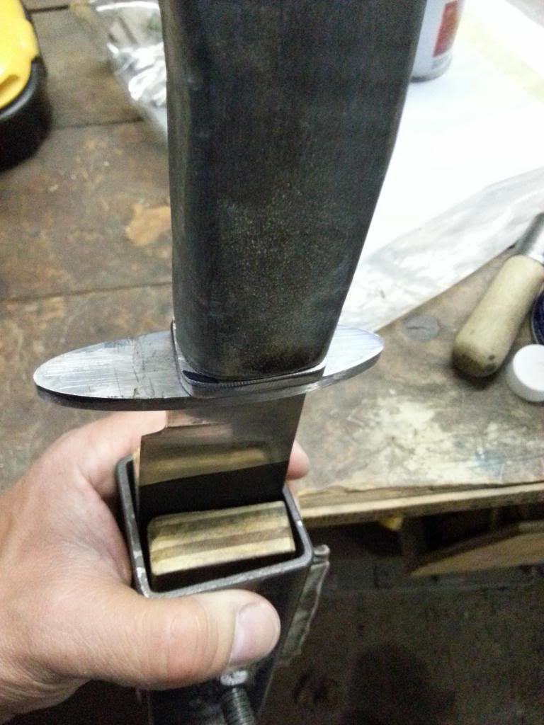

That's why I wanted to hopefully be able to work the handle as one piece and just slide it off and on the tang. Anyway here's some pics since everyone like those.
Here it is with a light behind it so you can see no gaps and this is just press fitted the left side is just a reflection no light shines through anywhere I've checked a ton of times:
Here is is kinda full view (with part of Freds bubble jig on the bench). I'd like the butt of the handle to drop a bit more and I'm thinking I can achieve that as it gets smaller as I shape it.
Some shots of the spacer I left it over sized for now and will work it down with the handle. My question also is on a guard like this should the width of everthing be about the same width of the guard or would it look okay with the guard being bigger on all sides?

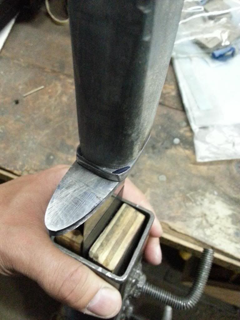

I dunno why I sometimes ask a question then proceed to work away regardless LOL. So have the handle rough shaped and the spacers and the guard are just about seamless when I press fit it. A little fine tuning and I should be happy. My plan is to make it look like Nick did on this amazing Bowie but I dunno if I have the skills for it. I most likely will have something that kinda sorta resembles it but I am particularly fond of this shape handle on a Bowie.
Here is where I'm at.
EDIT: That pic should be rotated 90 degrees dunno why it's posting like that
