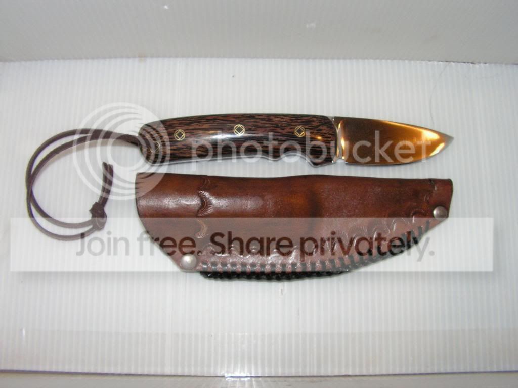

My first knife design. Critiques and Comments welcome
Ok i think I have a couple simular finished ones. Here ya go
Is it possible to do the curves with say a half round file? Also without a grinder you're saying the entire shape of the blade will be a challenge?
You can use files and a half round will be good, you do have a few different radius to deal with, dont go too deep with the file because it will leave alot of sanding. Once you file then use sand paper wraped in a piece of wood to finish.
The blade has a belly on it with is tough to get a uniform edge, hollow grinding on a grinder you can follow that curve. It can be done just a little tougher than a straigt edge, looks like hellgap got it done nicely.
I would go with the drawing from Dustinhall. the recurve edge would be hard to grind.It would also be easier to finish the back of the handle with the tang not protruding. Have fun.
Dustin has shown a simplified ( and simpler to do) version of your original idea. I would go with that,too.

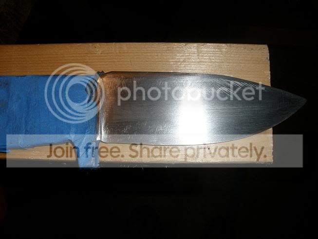

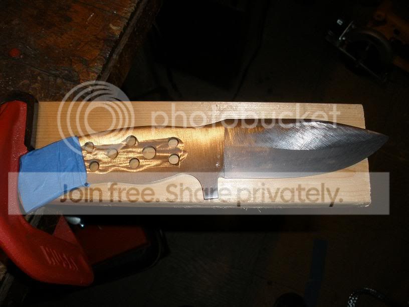

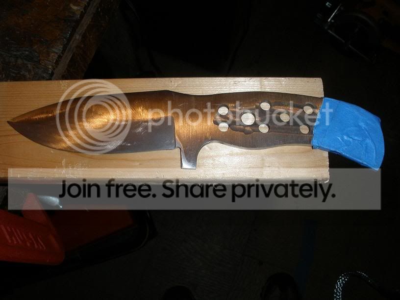

Okay so I spent a little time filing the knife tonight. For anyone who is a newbie like myself I will let you know that filing a piece of ATS-34 is a slow going process. It got to be too late to find the camera and take pic but I'll do it likely tomorrow. One side came out pretty good but I got a little shaky on one side with the file. The other side was fairly smooth sailing, toward the end of the time I was working I think I found a decent groove and I think I managed to get the bevel fairly decent.

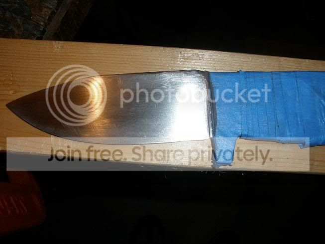

Okay as promised here are some pics after tonights filing session. I pulled the tape off the handle area because I wanted to be able to get a good look at how the plunge lines look.
What's the deal with that humpy spot on the spine??? :confused:
I didn't see that anywhere in the design process pics.
Well, if you would have asked me I would have said don't do that. :)
edited to say I know nobody asked me.... I'sa just say'n. ;)

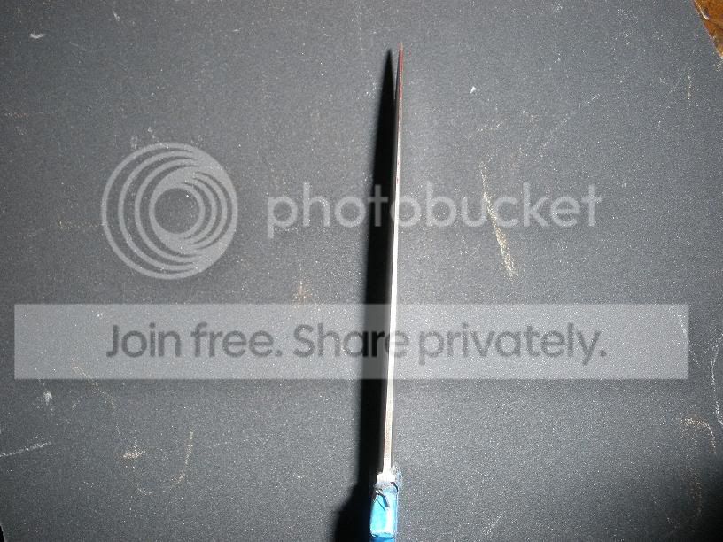

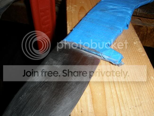

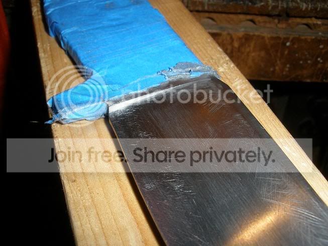

Okay am I screwing this thing up or what? I used a marker tonight to check my bevels and I have yet to run the file across and have it make a perfectly flat cut. Should I have the bevels perfectly flat at this point or is it near impossible to do with a hand file and no jig?
I'm pushing from the plunge to the tip. I thought I had a pretty good system going. I even put tape on the floor to mark my foot positions once I thought I was "in the groove". I'm holding the file handle basically against my hip and using my entire body to move the file rather than just my arms. I figured keeping the file "locked" against my body would be better than trying to totally freehand it.
Looks good so far Matt. It takes time, so go slow, and when one step is done, move to a finer file, then sandpaper. No need to get things absolutely straight on the coarse file, you will sneak up on it as you progress up the files and grits. Going too close to finished in the coarse stages will mean you will go too far in the finishing stages. This is the number one error that causes a knife edge to end up too thin, or requires the blade being made narrower to allow for enough edge meat in HT. The rule is - thickness of a nickel in filing...thickness of a dime in sanding.
The dip in the spine is the thumb rest. It will be in the handle, and flow out onto the spine. It works well and is not hot on the thumb. On a knife without a guard, I consider some sort of grip control a must. This knife will be used for hunting and field dressing, so grip will be important.
Stacy
Ummm then Houston we have a problem. I'm easily at a dimes thickness or thinner at the moment and I haven't even gotten to sanding. I was probably close to a dime in the first night or 2 of filing and I barely had a plunge line at that point.
Okay in my semi-panic state to not mess this knife up and/or wind up with a paring knife by the time the blade gets cut down. I put the files down and hit it with some sand paper. Pics so I can get some input, I'm guessing the edge is way too thin at this point right?
