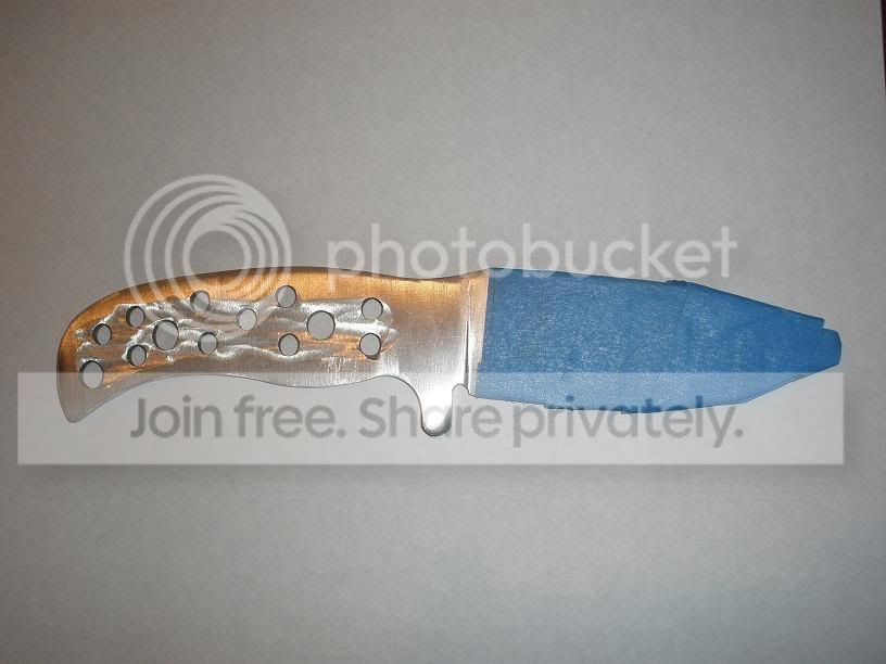

My first knife design. Critiques and Comments welcome
Finished up sanding at 400 grit, and got the handle a bit slimmer on the grinder and cleaned them up a bit with the files. I also felt the spot that dipped down at the but was a bit pointy so I rounded it slightly too to make it a bit smoother. Nothing crazy as far as change goes just made it a little less abrupt. So the handle work seems to be done., I've got to go and get a chainsaw file to work on the choil, although the more I look at it I'm debating whether or not to put it in.
I'm going to poll you guys for what you guys think would look better. Here it is with no tape on it.
If I cut it in I was thinking something around this look. (Forgive my paint skills)
I think the choil will improve the look. You have to do something with that projection, anyway.
Stacy
I agree the choil would help, but that flat spot on the end of the guard is the only flat area on the knife and it looks a little lost. How about rounding the front of the guard a bit to make a smooth curve throughout the guard area?
I think it would improve ergonomics a bit.
Curt W.

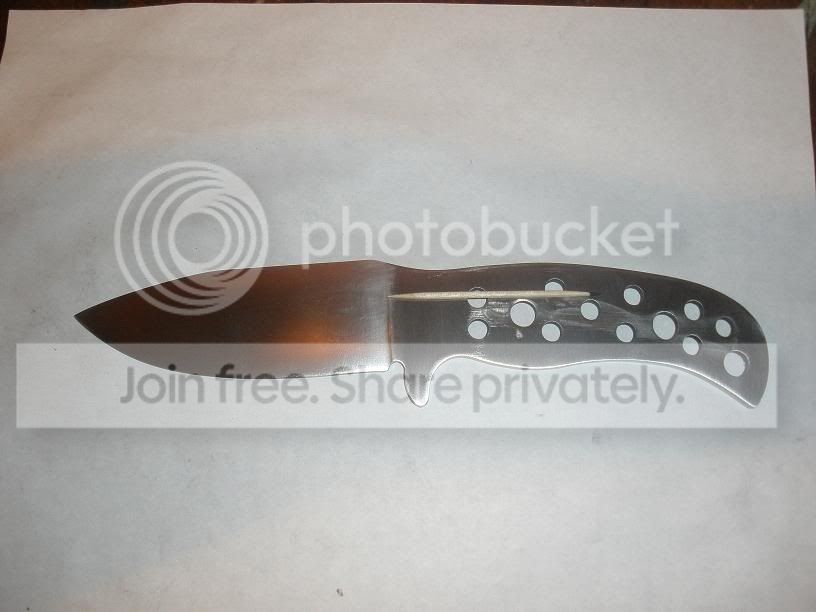

Just finished cutting the choil in and rounded off the guard Sill may make some changes to it but not 100% sure just wanted to get rid of that squared off look. Coming into the home stretch I believe as far as pre-HT is concerned. Going to go and work on cleaning up the ricasso area and I have to smooth out the file marks I made when I modified the handle.

Matt,
Don't stress about the plunge lines. You will adjust that in the final sanding after HT.
I would suggest curving the finger guard back from the front a bit more , as was drawn by Curt (clw3). Look at your current shape and the one he drew. Which has a "flow" to it?

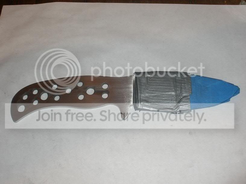

Okay I think I got all the ugky scratches out of the ricasso now I just have to clean it up. I also re-shaped the guard as per Curt's suggestion. After I originally rounded it I wasn't sure what I wanted to do and rather than rushing in I kept looking at it and thinking. After I finally finished it tonight I looked at it and said "Damn that is nice looking". So to Curt I would like to say thank you sir for the suggestion.

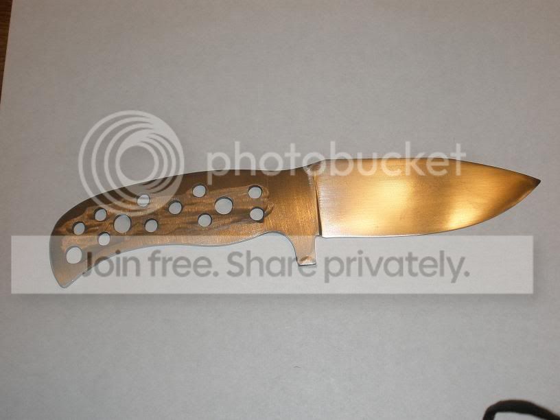

Here is a pic of it sanded to 120, I just have to take it up to 400 give everything a good once over to see if there is anything that needs a little more attention. Then should everything look clear it's off to Stacy for the HT.... One thing I did notice when sanding, which I didn't see until some grit and file dust got into the plunge line was another small scratch running parallel to the plunge line.
It took a bit of sanding to get my ugly scratches out so Stacy just want to let you know that the handle area that you roughed up got a bit smoother in quite a few spots :D.
Here is an updated pic.
Looks good, Matt.
The plunge lines can be a tad off as far as height ( as long as they are more or less the same), since you will be re-sanding those areas after HT. You want them to be parallel, and the same depth, but the closeness to the spine will move with only a small amount of sanding, so avoid over-sanding them in the pre-HT sanding steps.......Remember, this isn't the finished knife - it is the Pre-HT knife.
The rounded finger guard looks much better.
I would not take the tang to 400, 120 is plenty. It helps with the glue sealing better.
At this point, I would take the tape off and, using 400 grit, carefully go over the junction that is currently taped. All you want to do is even anything out that is high or low. Then it looks like it is ready to HT.
After HT you will re-sand the knife at 220 and then go up the grits to the final finish. Sanding will be slower, but deep scratches will not form as easily as they did in the soft steel. The post-HT time spent getting the surface cleaned up at 220, and then dead smooth at 400 is the best spent time on the knife. You will not need to tape up the blade to work it then, so you can look at the progress as it goes. Once past 400, the sanding goes faster........as long as you did all the work to 400 completely.

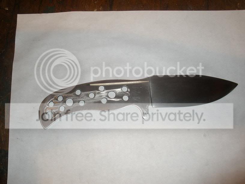

Okay I just about finished up my sanding at 120 on the tang. I took all the tape off, looked it over, went back and did some more sanding on the tang and again on the blade and think I have all that aspect done. I can't see any real blaring scratches I missed on the blade at 400. Or the tang at 120 (with the exception of parts that will obviously be covered by the scales).
Also since I'm obsessive compulsive about the plunge line heights I took a pics and marked where they basically stop. In case it's recommended for me to try and deal with them now should they be too far off.... You guys tell me.
This pic looks like the line extends past the tip of the toothpick a bit but it's more slightly raised than it is actually a line. The scratches towards the top of the ricasso I just noticed when I looked at these pics and checked them on the blade.
As much as it looks it in this ^^^ pic those are not horrible scratches in the guard and ricasso area. Believe me I went back and double checked it after seeing the blown up on my PC. It's a bit of residue from the painters tape that makes it look so ugly.
Well took out the scratches that were in that pic tonight. Also figured it has to be done at some point so I went around the knife and sanded out all the marks from the bandsaw and took that up to 280 grit. I'm not sure what the next step is at this point..... I'm guessing I'm just about to the point where it's ready for HT?
