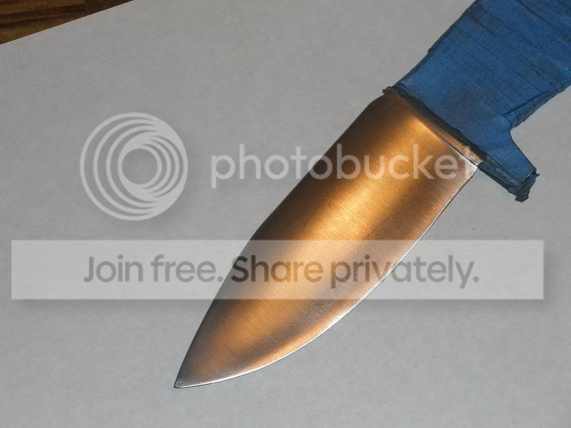

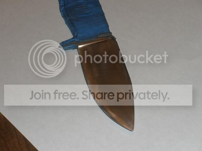

Well I'm glad I went back and looked at that side again more closely today. Found a few small scratches at the tip and got them out. The other side of the blade though I really did a job with during filing. I knew I had a bad side and that was it. I have a few scratches basically in the center of the plunge line that were pretty deep in there. I managed to get them down a decent amount tonight to where they're considerably less noticeable. So that means I have a few more days of sanding on that side. :D
While sanding tonight on the side I know I did a number on I've noticed a few SNAFU's. It appears when I was filing I somehow created what looks like a low spot smack between the spine and the edge of the blade. It also appears I clipped the ricasso a few times with the fule when putting the plunge line in on that side. Also at the end of the plunge line (near the spine) there is another small gouge that is on the bevel a fraction of an inch off the plunge line.
I'm guessing the only way to eliminate the low spot on the bevel is to just keep sanding the center of the blade?
But what about the gouges on the ricasso and the bevel? I can't just sand them out in that one spot can I? I'm assuming I'll create a low spot if I did that.
Also I'm getting some sanding scratches on the ricasso from the sanding block occasionally hopping up over the plunge line a bit. Will that be much of a problem to get out?

Try and get the bevels as flat as you can before HT. It will save a lot more work later. The ricasso should be no big deal to flatten up after the bevels are done if the scratches are minor. I would concentrate on getting the bevels right,and then trim up the little spots here and there last. I am glad you realize that you can't sand out a small spot directly without having it make the blade bevel look like a fun house mirror after the knife is done. However, keep in mind that you will sanding again after HT, so tiny surface problems may not be too big an issue.

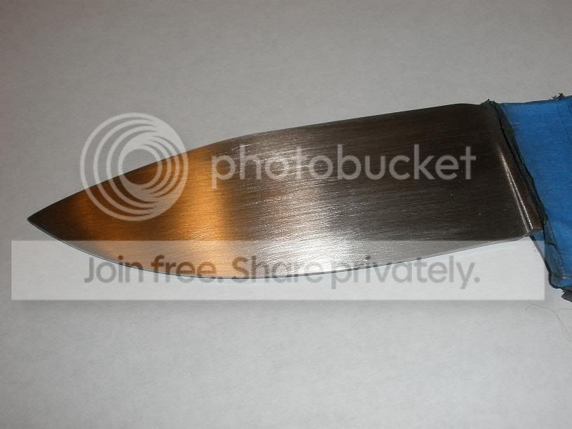

On the subject of 80 grit scratches, I noticed the first sanding scratches looked rather large in the photos. Are you hand sanding with 80 grit? I did not realize I sent any paper that coarse. I sent files up to a very fine number ( #4 or #6?), which will file as smooth as a 220 grit paper.
Nothing is wrong with starting with very coarse paper, but you will make deeper scratches that will take a lot of work to get out. I usually start with 120 grit after filing, unless I am removing a lot of metal, like on a sword.
Remember that the size of the sanding scratches is a product of the grit size.......but the scale is not linear. An 80 grit scratch is about 200 microns wide, and about 50-70 microns deep; but a 120 grit scratch is only 100 microns wide and 25 microns deep. The difference between grit sizes gets to be less and less as you approach 14,000 grit, which is 1 micron.For hand sanding purposes, the grits that matter are between 100 and 800 ( above 800 you are polishing, not sanding). A good chart is :
Nope I'm only using the 120 you sent me. Maybe it's just the photo but all that sanding is done with the 120 grit you sent.
The only thing I "cheated" on so far was the filing. When I was going to start that other knife i went and got a 12" Nicholson Mill bastard file, which I used a lot in getting the plunge lines in with. I think the thing that bit me though is because it does a great job of eating metal I made some of the cuts on this side a bit too deep with it. Then I was worried about the thinning edge thing and went to the sandpaper without using the finer files as much as I probably should have.

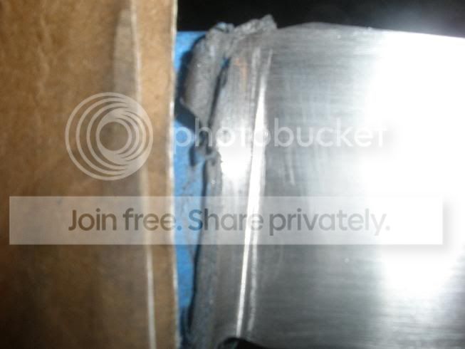

Well I've been working on what is now known to me as my "dammit spot" From what I can tell I must have made a low spot right by the plunge line in the middle of the blade. The picture doesn't really show it but I'll post what the camera shows and I'll draw in what it looks like in person.
Here is about the best close up I can get of the side.

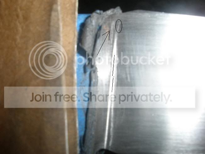

Here is a lame attempt of drawing in the scratches. Also the oval at the top of the plunge line is another scratch that veers off to the right of the plunge line. And the arrow is a scratch in the ricasso which I'm assuming I can sand out in another step.
That scratch is like basically in the worst possible spot it could be... combine that with I'm fairly certain that it's in a low spot makes me think it's in the absolute lowest possible spot it could be. And I'm still kinda dervous about making the edge too thin as well.
Also here is another question, if there is a small scratch mark right where the blade will be sharpened do I need to be overly obsessive about getting it totally out?

Looks good. As to the small scratches in the edge area, as long as they are not too deep, they will come out later in final sanding after HT. As you suspected, the ricasso scratches are a quick fix when the bevels are done. But, aren't you glad you put the tape there....or there would be a million of them.
Sometimes you have a small scratch that really bugs you, and can't seem to get it to go away without messing everything else up. If you have worked the scratch to the limit, you may need to let it go and try to remove it after HT. It will take more work then, but you will be looking at the finished surface, so you will know when to quit. After HT I'll talk more about trade-offs in finishing ( deciding what to leave and what to pursue).
In some cases, especially at the plunge line, using a piece of flat metal as a backing stick can help, but he bocote block I sent should do just fine.
EDM stones are a real champ at cleaning up the plunge area, but careful attention with sandpaper will get it done,too.
A trick for cleaning up the very corners of the plunge ( where you are having the problem) is to fold a 4X4" piece of sandpaper twice, making a 2X2" pad. Flatten it well, and place a square of 1/4" thick hard material ( Micarta or hardwood) on it, with the folded edge aligned (The pad and backing block are separate, not folded around each other). Wet the pad and place the folded edge in the plunge corner. Carefully sand the plunge, applying slightly more pressure within the edge of the backing block at the plunge. Use a few up and down strokes along the plunge, and then several lengthwise strokes down the blade. Don't over do it, or you may make a dip, but this will usually take care of those last little buggers before you do the final grit on the bevels.After getting everything flat and smooth at 120, I try to get the plunge clean at 220 grit before sanding the bevels ( at 220). Then at 400 the problem is usually gone.

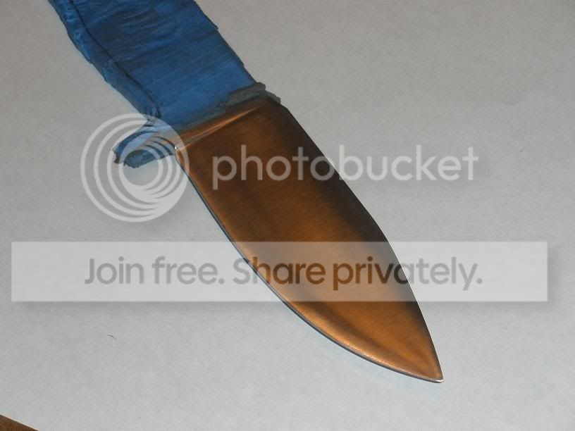

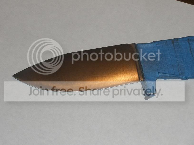

Quick update no pics though, went to the next grit tonight. Just about finished up one side of the blade with the exception of a few small scratches. Then went over to do some work on the side I haven't been happy with. Still a ton of work to do on that side but seemed like it's starting to clean up that spot by the plunge line a bit. Either that or I'm just willing myself to believe that it's starting to look better. Hopefully tomorrow I'll be able to p both sides.
I'm also finding I'm becoming more obsessed with this whole knife making thing. I haven't even finished this knife, I have another one I started before this one even arrived and I'm already thinking about what to make as a 3rd. I'm also debating on putting Burl Source on my ignore list for a while so I can't see what blocks he's putting up :D. I'm squirreling away wood and constantly teeter-tottering about whether or not to keep adding more the more I keep looking at the pictures.
I started cutting the bevel on knife #2, figured I could save some money shipping them together to be heat treated, and while they are away I will be starting #3, should have it ready to go by the time the fist 2 get back. So yes this is addictive, I will be real torn come riding/race season, I will just have to find a way to spilt up 12-16 hur work days riding and knife making. Darn I will be converting the garage into a shop too, going to be a busy spring and summer for me.

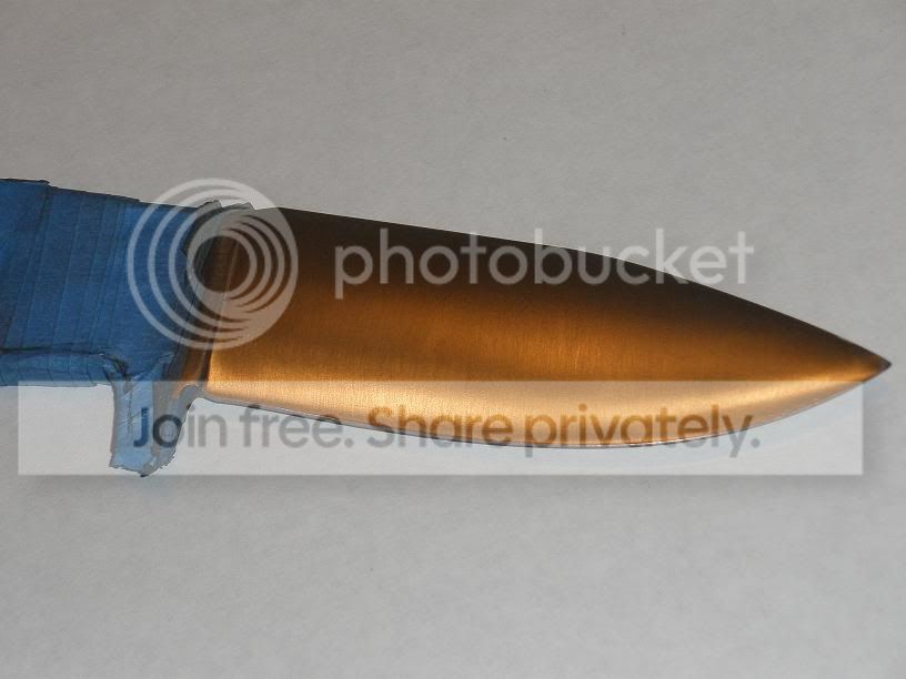

Here's where I'm at with 280 timeto bump it up to 400 and that should finish the blade part. Then I just have to narrow up the handle, cut in my choil, clean up the ricasso..... Not sure if there is anything else after that at the moment :D.
Going to go hit the blade with some 400 now. Lighting makes it appear golden in some pics but it's not.
