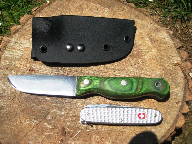

The kydex sheath is ugly, but actually quite functional. It holds the knife very secure. I also like the fact that the belt loop is detachable. Nice design. You can trim it a lil closer to the rivets, so it’s not so bulky IMO.
The handle and blade are a great length and width for a belt knife.
You fit the scales and liner to the tang very good. There are no gaps at all. Great job!
The contours are a lil off and maybe a lil too abrupt for me. But It looks like you had the right idea going on. It is still comfortable and very hand filling.

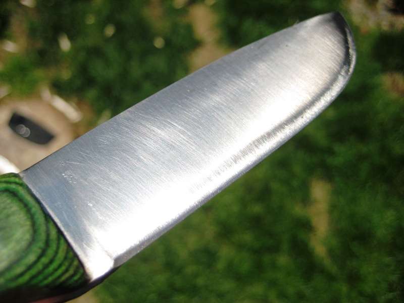

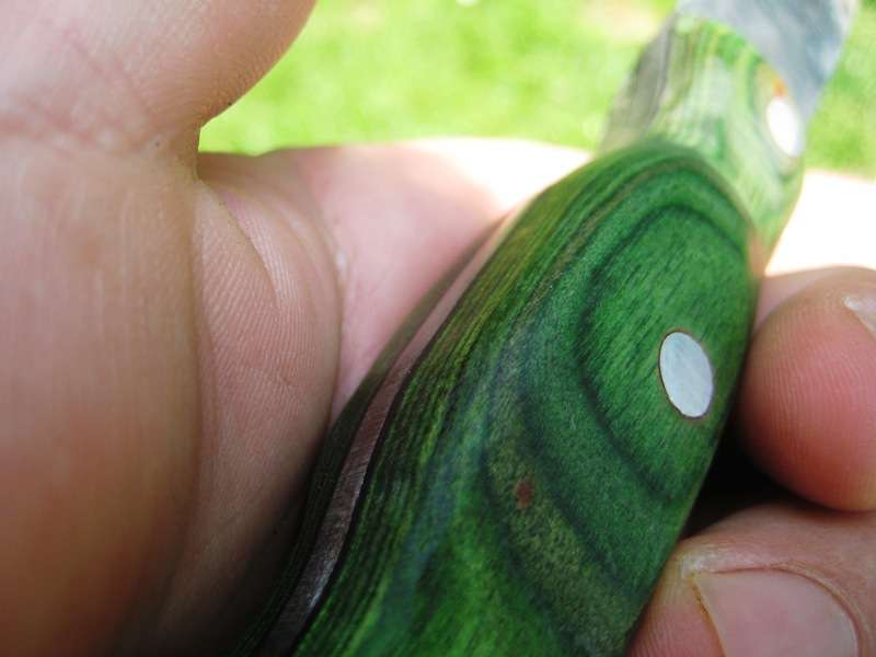

Other than little things like in this pic; you really did a good job finishing the knife. I really don't pay too much attention to that stuff unless I'm paying over $100 for the knife. I kind of like the flaws of a handcrafted knife, as long as it doesn't affect performance.

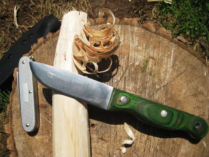

The edge is ok. I think you left a lil to much at the beginning of the knife. There's quite a bit of shoulders on it there. Its about perfect closer to the tip though.

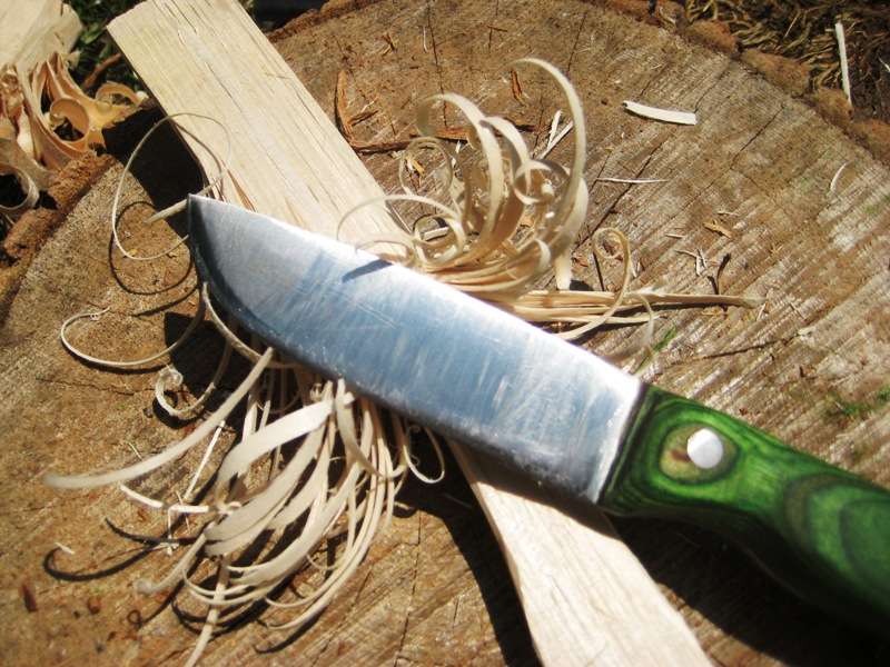

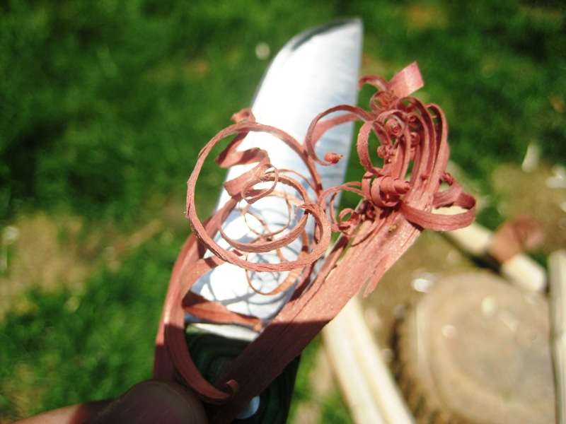

Like I said before. The edge closer to the tip is very good. Look at these thin slivers it made from this cedar.

I mentioned the edge. Try to concentrate a lil more on the geometry closer to the handle. In this area.
The edge doesn't need to be that thick on a knife this size. I don't think anyone is gonna do any chopping with it. Test it out by feathering soft wood. If it drags alot, take it a lil thinner. I have recieved knives that cut through paper like butter, but couldn't cut wood for nothing.....

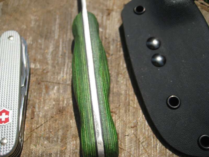

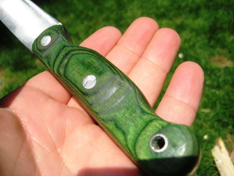

The handle is a lil too thick in the belly area for me.
I would take it down a lil bit in this area. Also see how the taper of your contours are kind of abrupt. I would smooth it out a lil bit so its not as dramatic in this area.

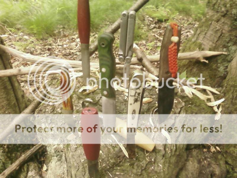

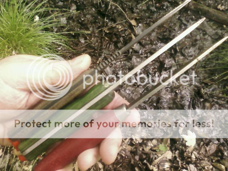

Shown here side-by-side with some familiar woodcraft knives, an Ontario RAT3 and a classic Mora. Three knives, three different handles, three different grinds.
The blade appears slightly thicker than the others.

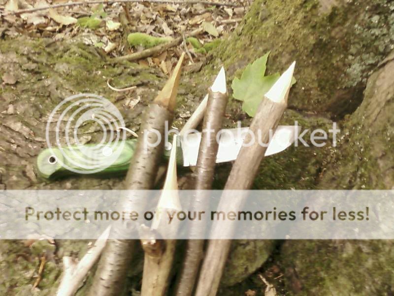

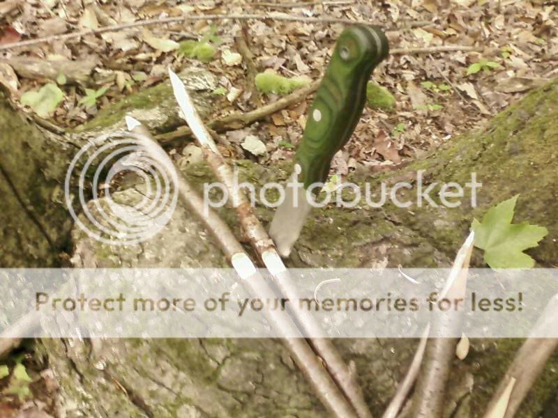

First, I cut up some small spears for self-defense against gnomes (it's that time of year!:p). I expected the blocky scales to give me trouble, but was suprised to find otherwise. I was able to use a variety of grips with no problem. The width of the blade gave me good control when choking up for detail work.

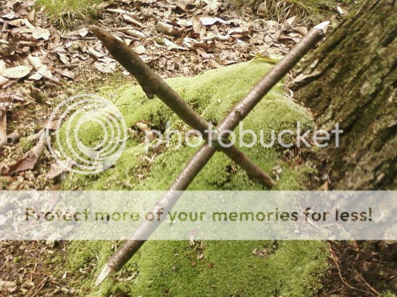

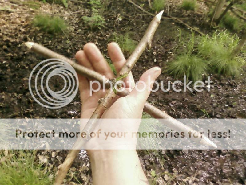

Next I attempted to make an Apache throwing star. I got the idea from a thread on this board, posted by Pitdog I believe. First, I cut notches in two double-ended short spears.
I tried natural cordage, but ended up reinforcing it with 550 cord.
The finished product.
Egads, it worked! :eek:

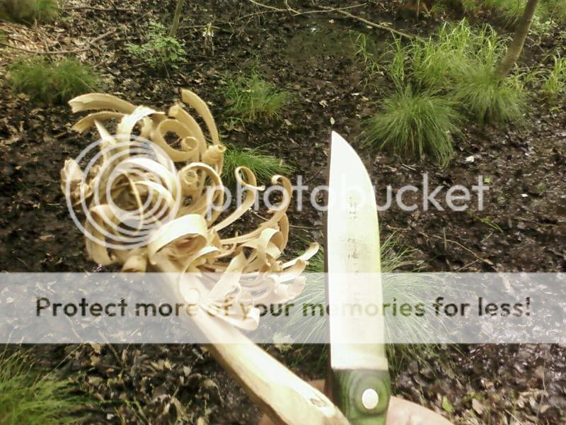

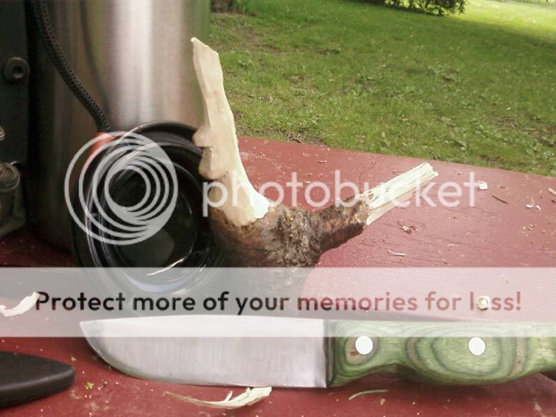

Knife 3 curls wood well, with only slight drag.
I brought a block of butternut for a spoon project. I started it with my crooked knife.
Knife 3 helped with the next stage. Again, some drag when slicing thinly, but excellent when carving notches or chips.

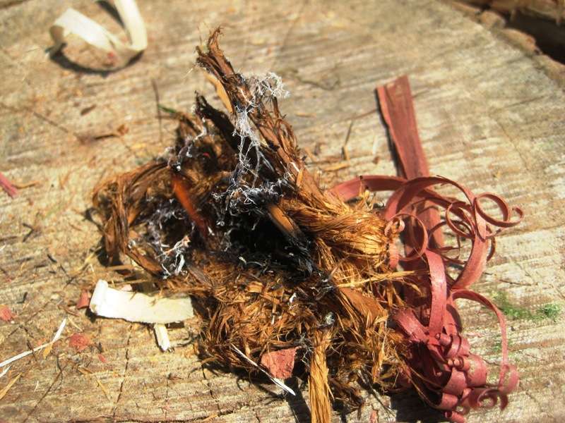

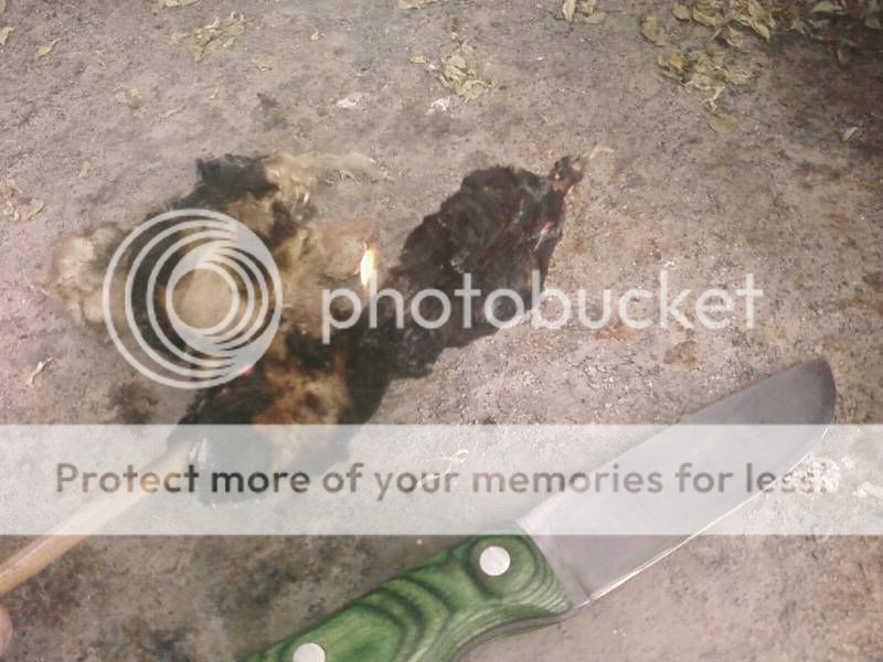

I collected the top of a dry old cattail, threw some sparks at it with my fero rod. For this task, the spine of the knife worked like a dream. You can see a small flame dancing over the top of the cattail here.

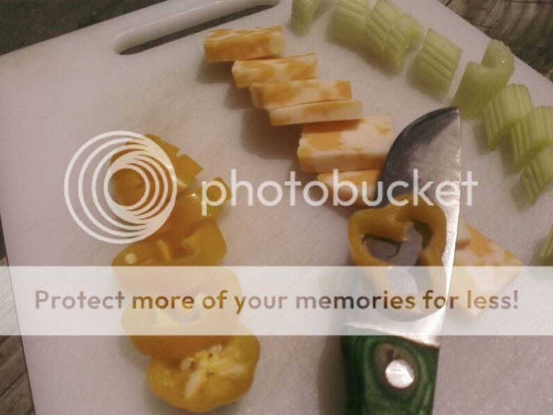

Let's not forget food prep. The cheese gave me a little resistance, but nothing to whine about. Celery and peppers sliced easily and consistently. I also carved a chicken with the knife, but neglected to snap pics before it was eaten. My bad. :o
And finally, a group shot for size comparison.
Knife 3 is a hard worker, if a bit rough around the edges. The grip appears squared off, and thick in the middle, but didn't hinder use and didn't give me any new blisters or hot spots. This afternoon I used it some more on my spoon project. I showed it to some buddies and eveyone agreed it didn't look like a "third knife." More like a tenth. Overall, my issues with this knife are minor, and easily improved. As novice bladesmiths go, I'd say Noshtero is far ahead of the power curve. I look forward to following his career.

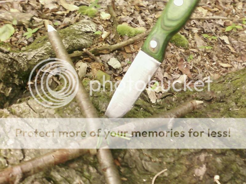

Let me start out by saying that this is a very impressive knife for an early effort.
It finally stopped raining around here for part of last weekend and I was able to get out and give the knife a little workout.
First a few beauty shots

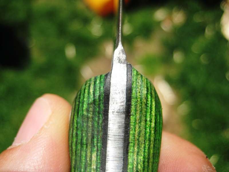

The handle needs some work. the palm swell is too thick and extends too far to the blade side of the handle and has too acute an angle to its curvature. Still it is a lot better than anything I could have made and it did not give me any hot spots as I worked with it. It was just not as comfy as it could have been.

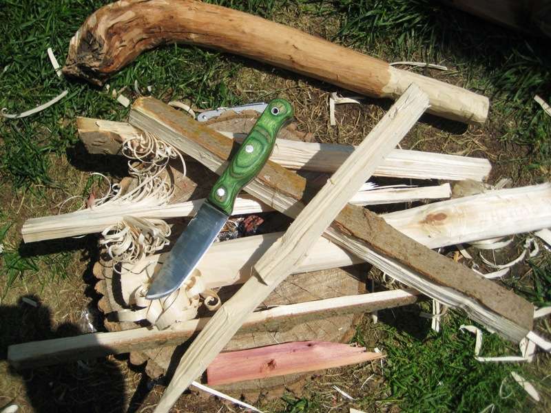

I gave tha knife a firemaking workout.

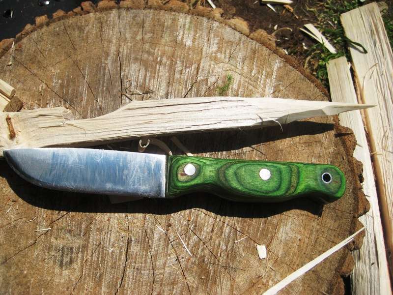

The well squared spine worked great for getting some shavings of fatwood. (Unfortunately, I did not get any photos of this step.)
Noshtero's knife #3 was easy to baton.
It made some nice fuzz sticks.
And with 2 strikes from a ferro rod......
Fire.

Thanks Sharp Eye! Sorry I couldn't get to replying until today. This page 4 has so damn many pictures that it crashes my internet at home everytime I try to load it. I had to wait until I got to work :)
Boy your overhead shot really highlights how abrupt my handle curves are. Great shot!
