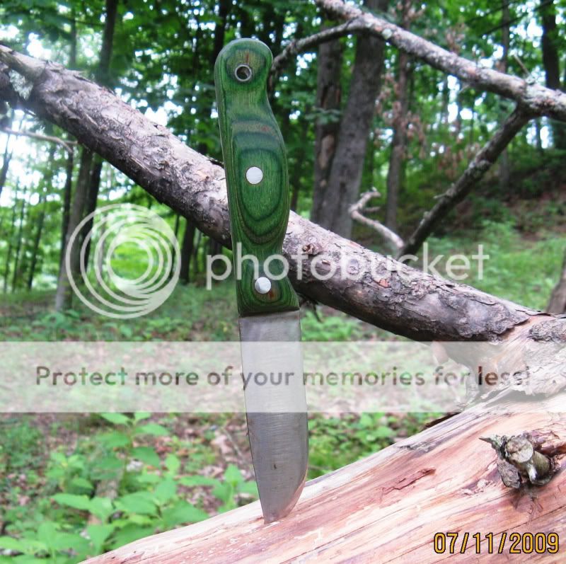

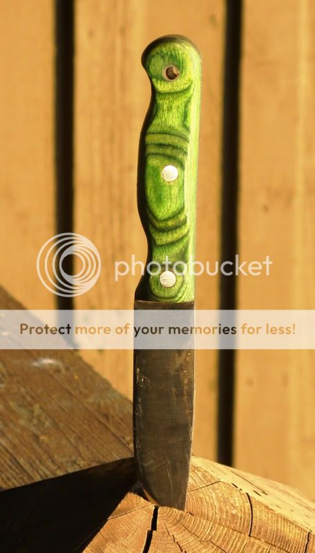

First, I've gotta tell you, Kathy loves the look of the handle. She says her favorite color is blue, but she really seems to have a thing for green knife handles. ;)
A small disclaimer- today's trials were conducted with an antsy 85 pound dog tugging my leash arm, so I didn't get in-hand shots or try any hard-use stuff. Hopefully tomorrow. :thumbup:
My initial cosmetic assessment echos those of Tony, John and Sharp Eye:
Fit-to-tang: Great!
Handle contours: A little drastic and asymmetrical. I have large hands for a guy my size, but my size is only 5'6", so I consider my mitts to be "average". The narrows of the grip contours are closer together than my pointer and pinky fingers are, which made the grip uncomfortable. Gentler curves would eliminate that issue, because the handle length was perfect for the blade.

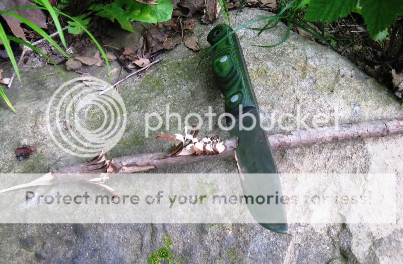

Edge geometry: Very, very good! I only fiddled with a couple of maple twigs, and my findings back up what tonym observed about the edge. I used priomarily the part nearer the grip, and - although it could stand to be narrower- it was perfectly serviceable for some fine work. (Even with a dog yanking on your arm.) :rolleyes:
I'm going to clean it up and chop some veggies with it later. I will try to take it out (without the dog) tomorrow.

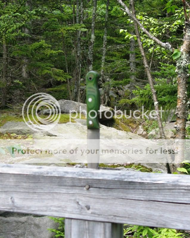

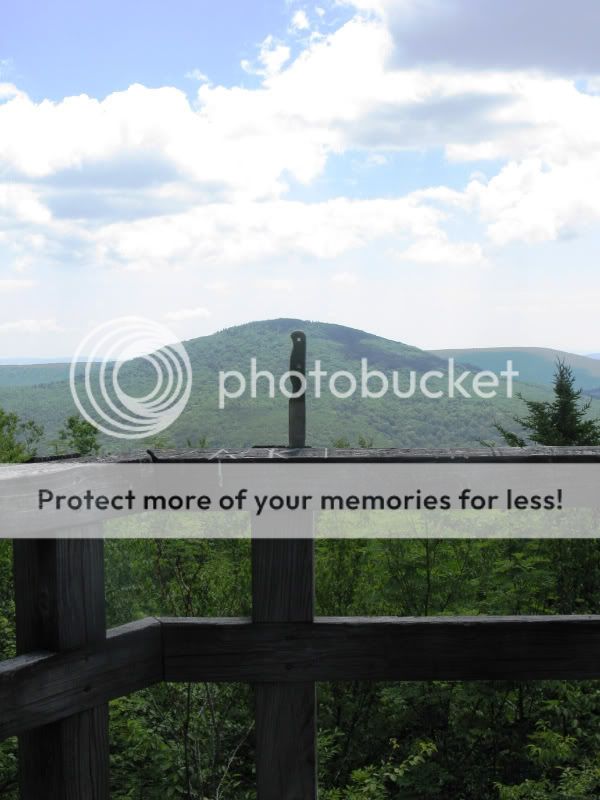

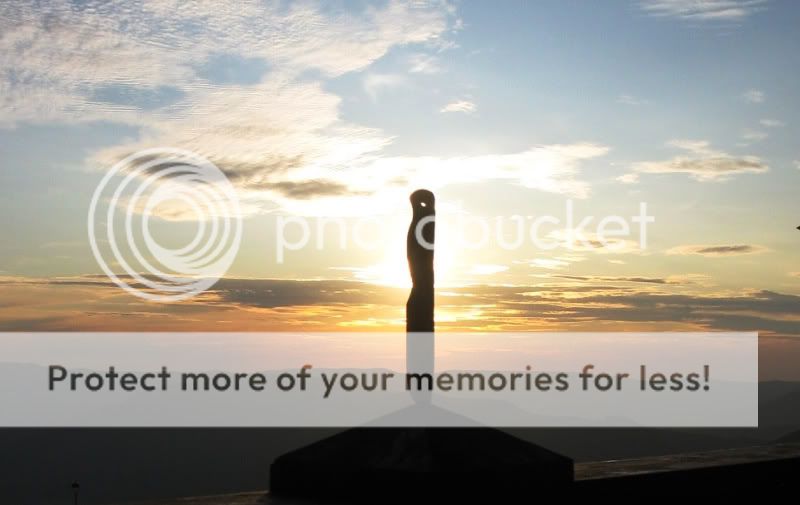

As stated above, I took the knife along on our mini-vacation with the hope of being able to get some more use out of it. I carried it every day (often covertly) but was not able to do much more than get a few more glamour shots:
On our balcony at sunset.
Along the Highland Scenic Highway.
Black Mountain Trail.
I was really hoping to use it to harvest some sumac berry heads on the way home. (Kathy has never had sumac tea.) We saw lots of nice, ripe sumac, but it was always inaccessible from the road. :(
Overall- I would say great effort Noshtero! The issues so far identified can be easily corrected in subsequent projects, and I look forward to watching your work improve. :thumbup:

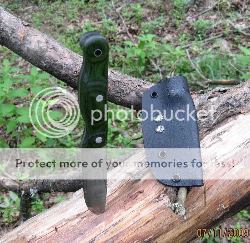

First off, I'd like to thank Noshtero for including me in this passaround. I'm still a relative newbie here, so it is certainly appreciated. I also have to say that I admire your courage, putting your third knife up on this forum shows a definite willingness to learn and improve your knife making skills. We have a lot of great makers who frequent here, so I can imagine how intimidating this process could be. I also recognize the caliber of folk hanging around, so I'm sure you had some confidence that you'd get honest and constructive feedback. That said, on to my review.
First impressions. I thought the sheath was pretty decent. Certainly tough and could stand to have a little more material removed (beyond the rivet line), but certainly workable. It also had good retention. What can I say about the knife itself that hasn't already been said? Not much. The handle and blade length were good. The contours of the handle were too abrupt as has been stated, but more on this later. As I said in a previous post, the edge needed some work, but this wasn't surprising given the number of participants before me. My sharpening skills are mediocre at best, so I understand how this becomes an issue during passarounds.
Saturday, while running Daddy Daycare, I did manage a little kitchen duty. Unfortunately, our schedule has been so hectic here lately that we haven't been to the store recently. As such, there was little foodstuffs to work with. All I could find to slice was some sharp cheddar cheese (yum!).
I got some reasonably thin slices here, but nothing spectacular. I think it was part technique and part edge geometry. I think increasing the height of your convex (i.e. decrease the included angle at the edge) would help out here. Personally, I prefer a full height convex grind, where as this seemed to be sort of a flat grind with a hefty convex at the edge.
On Sunday, I managed to harvest some Poplar at my parents' house. Compared to Oak, I thought this would work much better for fuzz sticks. Turns out I was right. Today, I actually got out for a bit to play with the knife. I started by shaving the bark off of one of the pieces and the blade did very nicely. This isn't much of a chore on Poplar, but I was impressed nonetheless with the ease that #3 peeled it away.
Next I began working a fuzz stick. I'm still struggling with this, but the softer wood helped immensely. I think once it dries out a bit, it will work even better. I managed to get some reasonably fine curls and in no time was almost through the piece.
Next I did some light battoning on some seasoned Oak. Since this isn't my knife, I didn't go all the way through, but I have no doubt that this knife would have done so without issue.
Okay, so each of these tasks was similar to what has been done in the thread before, so no real surprises. So what sort of advice can I offer Noshtero for his next blade? Other than the aforementioned advice on the grind, this blade is spot on and overall is quite good. The blade won't be going home hair-popping sharp, but it is just shy of it, which demonstrates that a good heat treat was achieved. I'd like to see the drop/clip lowered ever so slightly to make the point a little, well pointier.
I think the best advice I can offer Rob is on his handles. I took some photos with the #3 alongside my Fiddleback Forge Woodsman. Obviously, no one here would expect you to achieve Andy's level of craftsmanship on your third blade, but I think a geometry similar to his is something you should strive for in the future. The Woodsman is one of, if not the most comfortable knife I've held, hence the comparison shots.
My suspicion is that most, if not all, of your handle was shaped via a belt/bench grinder or other powertools. Check out this tutorial over on Andy's forum. It provides a little insight into how Andy shapes those gentle curves reminiscent of a woman's body. Note the subtle curves in all three dimensions. Again, this is meant to be my advice on where to go from here, not where you should be right now.
Another question I had was whether you're using Stainless Steel or Aluminum Corby bolts. I think these are Aluminum. I could be wrong, but I think SS would be easier to work to a smooth finish as it isn't "gummy" like Aluminum when sanded. Obviously, this is a minor cosmetic issue, but one that I think you'll want to address some time in the future.
Altogether, I think you should be quite proud of this #3 knife. Is it perfect? No. Is it much better than many a #5+ blade? Probably so. I'm looking forward to seeing your growth as a maker based on the feedback you've received in this passaround. I'm planning to grind out a few blades myself in the near future and hope I have the nerve to put some up for a passaround as you've done here. Congratulations on an excellent job for an early effort.
