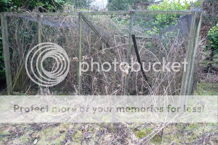

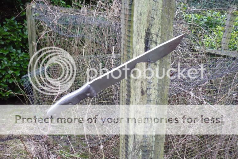

Here is my stripped and polished and self bead blasted NMFBM going through fencing like a hot knife through butter ...
Not even a dink in the edge :thumbup:
It took down the whole enclosure ( below ) and was still seriously sharp ...
