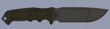

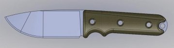

I have three up and coming models: The first is the GSO-4 Bushcraft Knife. This is my iteration of an ideal bushcraft knife, meant for lots of hard use. It has a blade length of just over 4", a blade height of 1.5" and an overall length of just over 8.5". The blade thickness is .215, with a full flat grind.

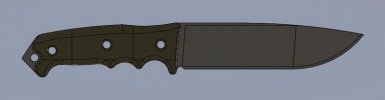

The second model is the GSO-5 Survival Knife. This knife has a blade length of 5.25", a blade height of 1.5", a thickness of .215" and an overall length of 10.25". The blade tang under the handle slabs is skeletonized to reduce the weight and improve balance, with the balance point being right over the index finger.

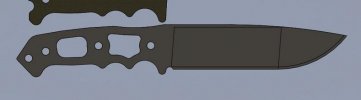

The third model I will be offering is the GSO-6 Combat Knife. It features a 6" blade, blade height of 1.5", a thickness of .215" and an overall length of 11". It has a more pronounced point than the GSO-5, no choil or thumbrest and has a slightly more generous finger grip area. The tang under the handle area is also skeletonized to improve balance, with it's balance point also right over the index finger. I am also tossing around the idea of adding a swedge grind(false edge) to the back of the blade and would love some thoughts on that. I am calling this a combat knife but it would also make a nice camping and dare I say bushcraft knife for the person who just enjoys having a large but not bulky blade with them.
I will be offering all three designs in CPM 3V with an aim hardness of 58-59 and am considering offering them in CPM S35VN with an aim hardness of 59-60 as well. I am planning on a stone washed finish on the majority of the first run. I do not prefer coating a blade but a few will be powder coated. On the coated models, the working surfaces of the blade will be ground clean. I know heat treatment for these steels is especially important. I am having Peters Heat Treat handle the heat treating to ensure everything is done just right.

Hello, your knives look like good designs. I would change the butt of the handle, no skull breaker, just flat. I would use a exposed tang for light hammering or scraping and without it being pointed, I would also be able to "palm" the knife during other chores. Maybe offer the flat or pointed end as a option. And I very much like 3V steel. Good luck.
Ok, so more of a nice rounded end instead of the pointed breaker or a truly flat end? I think I have an idea what you mean. I'll come up with something that will still go well with the designs and will suit that need. I'll be sure to add that as an option. The more I think about it, not having the breaker pommel will give a lot more function to the knives for most users. Thanks so much for the feedback. I'm already glad I signed up here.
GSO-4: I would say take out the second finger notch to allow for a larger variation in grips. I would also make the blade not quite so wide, IMO this makes the blade easier turn/maneuver in/over wood (imagine trying to carve out a U shape in a peice of wood, the spine will hit much shallower if the blade is wider) so maybe 1"- 1.25ish blade height. While I like thick blades I would reduce the thickness on this one to allow better cutting ability, especially since 3V is an option you could make this 3/16" - 1/8", it will slide through wood better, yet in 3V it will be as strong as .3"+ blade in most other steels. This would be good in either steel equally IMO.
GS0-5 Like the design a lot, the only thing I'd change is taking out the choil, I don't feel its quite long/large enough to really need a choil yet. This one I would keep the thickness .2-.23, I really like your handle design, and I actually do like the pointed pomel on this one as well. 3V preferred over S35VN
GS0-6 I like it, wouldn't change anything about it. I'd definitely prefer this one in 3V over S35VN.
As for handle material, I do like G-10, though also take a look at Canvas, linen, or paper Micarta, just as strong and grippy, and might be a bit cheaper (not sure really) but if so might make the knives a bit more affordable= more sales, with no strength or quality loss. As for coating, maybe offer S35VN uncoated and 3V coated? though I'm sure lots of people would like the 3V uncoated too, maybe make it an option, but if its an all or nothing thing I'd say no coating, bark river, fehrman both offer 3V uncoated and i've never heard any major rust complaints about there knives.
Definitely go with a flat on an extended pommel. In the outdoors, it's going to be used to hammer or pound stuff.
I like the design of the GSO-4 bushcraft knife, but I know that many others would prefer a thinner steel stock, probably .187 or or a bit less. With a full flat grind, the .215 would probably work well enough though. I really like WIDE blades, so it appeals to me on that front. On a smaller blade like that, I like a handle that allows a variety of grips with no hot spots. I'm wondering how that finger groove will feel with different grips? I do like that on a knife, in general, it makes the knife feel locked in hand when using a saber or hammer grip. My problem is small hands, the grooves sometimes feel a bit off on most knives. I like the rear of the grip to flare out a bit, it feels more secure to me.
The GSO-5 and GSO-6 both look about perfect to me, for their intended roles. Are they going to be .215" thick and flat grinds too? If the grinds are going to be as high as they look in the pictures, I think putting a swedge on the GSO-6 is going to make the point too thin for hard use. If you want to put a swedge on it, lower your grind line a bit to keep strength in the point. I would go with a flat pommel area on those too, just for better utility. :thumbup:

WOW! That's a lot of good feedback. This first batch is going to be more of a sample run so I might try a few of your suggestions. Both the GSO-5 and 6 will have a thickness of .215". I might grab up some thinner 3V for the bushcraft knife and give that a try.
I will have a few samples of each style coated in both steel types. I know some out there like less maintenance while others like the tacticool factor of coatings. lol. Thanks so much for the excellent feedback.
Yes, I will definately keep the profile of the GSO-4 the way it is. I too enjoy a taller blade. I may try the 3/16" thickness though. All of the edge radius will be very smooth so hot spots should not be a problem. I only put one finger slot in the bushcraft knife to allow for a secure grip as well as fit a wide variety of hands. I mean, most of use have to at least have an index finger in common right? lol While the profile of the bushcraft knife is pretty well broomstick style, if you watch my video closely, the handle slabs do flare out a little as they progress back to the pommel.
I am seeing a trend already though with the pommel so I will have to make a flattened pommel version of the 5 and 6 for sure. ;) I may have to take a poll.
Man, I am loving this feedback! You guys(and maybe girls) are great! Thanks.

GSO4 - I like the design but like what has been said before thin out the blade a little. Im a little worried about using an FFG grind on something i might baton with but, if it work, it works.
GSO5 - I hate using a small surface area for pounding in stakes, and the idea of possibly missing and hitting the handle material. so i would prefer a full metal pommel, similar to the Ka-Bar but instead of a disk, make it tear dropped, rectangular, just something to keep it more stream line

GSO 4- I wouldn't mind seeing it a little thinner like maybe 3/16" but the thicker stock is ok as well.
GSO-5- Round out the butt as others have said make it so that pounding something other than someones skull is possible ;).
GSO-6- Perhaps do a Sabre grind model of it? And Perhaps just a small gap in between the blade and handle to make sharpening on a bench stone easier? Other wise I like the looks.

Also, I will certainly look at trimming the bushcraft knife down to 3/16". My line of thought with the thicker blade and full flat grind was "tiny batoning axe" that still cuts well.
The GSO-6 has a 1/4" radius between the blade and handle. Are you saying you would prefer to see MORE of a gap?

I looked at the MSO 6 wrongly I think a 1/4" gap would more than suffice and create a small choil as well.
For the GSO 4 a thick blade doesn't bother me at all as I am used to Scrapyard knives which are generally a very thick blade.
