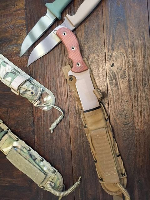

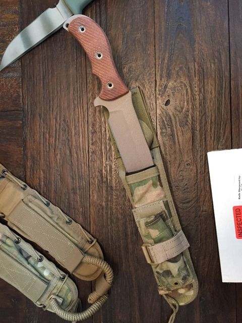

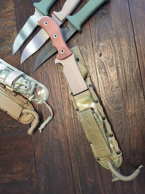

Here's some pics of where the blade of a new 3/16" RW starts cutting into the liner. There's a BASIC and a couple Combat Masters. All mine are the new style liner without a screw retainer (velcro retainers for the liners). Maybe they are slimmer liners. I'll melt one and see if I can get it to fit. Edit post later if I take some pics.

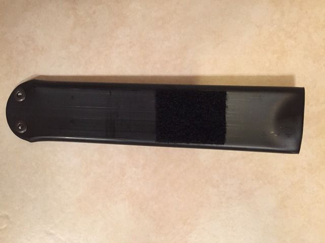

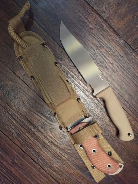

So I changed my mind about modifying one of my sheaths till I buy one specifically for the RW to mess with. I looked for a donor and decided I don't have a tan sheath I want to take from a knife. Then I had a few bourbons and went ahead with it anyway :) Just a hair dryer and disposable Chinese chopsticks to stretch the mouth of sheath, and flatten the body of the liner all the way down. Looks decent. Fits decent. Only downside is I need to find a tan SpecOps on sale again for my poor homeless 711. Here's the liner of the latest style SPECOPS with the velcro facing back. That's what you are dealing with and a butter knife works great to separate while pulling the liner out.
Ratweiler sitting pretty
Dang. I had counted on using the Basic Modular sheath with my RW. I guess I'll have to see how it fits, but it looks like I'll be mod'ing a liner.
If you have a heat gun, use it. Hair dryer barely got the job done. It is still a bit snug, I might resize again with the knife wrapped in painters tape inserted. Might also try to heat uniformly in oven first.
Be careful if you heat in the oven. Did you see the photo in another thread of one heated in the oven? It shrank to the point it was completely unusable for anything, it appeared.
Thanks for the heads up. I don't want a shrinky dink liner for sure.
